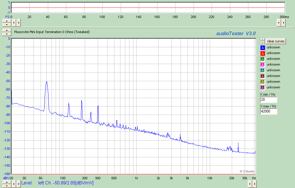

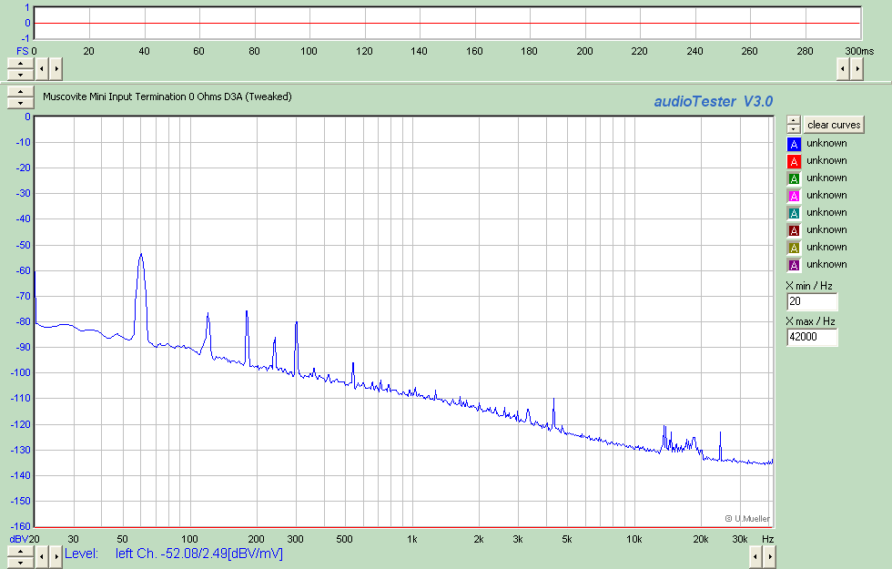

I did some noise measurements with the input shorted, shunted with 100 ohms, and open with just the 47K load resistance. It turns out that I am still having EMC problems with the generator output of the millet sound card interface due to conducted emc on the cables, but there may be more to it. I will investigate further, but I will try running the generator output at 1.0V out and doing the attenuation externally and see how that goes.
See the 0 ohm measurement for the 6ж9п-EB / 6Z9P-EV and the D3A, clearly the D3A is quieter, but by a small number of dB. The numbers are about 4.4dB better than shown

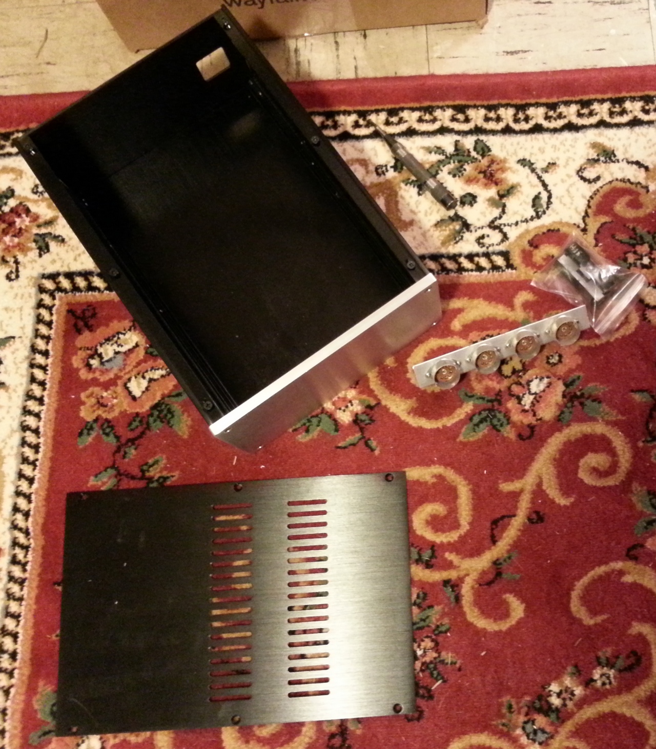

Well the chassis for the pre-amp arrived today, and the caps for the equalizer section arrived yesterday so the build is on. I'll have to proceed carefully due to challenges I'll not elaborate on, but it won't be as quick as my usual builds.
The sockets are mounted on a right angle bracket I fabricated for this purpose eons ago, in fact it is salvaged from a pre-amp I build in 1988. I've punched the locations on the bottom chassis plate for the bracket which is mounted on 1/2" 4-40 standoffs. The bottom plate will be removed for installation of bracket, battery holders, terminal strips and output caps. I will wire it out of box to make like easier.. 😀 I will partially wire the sockets as well for the same reason.

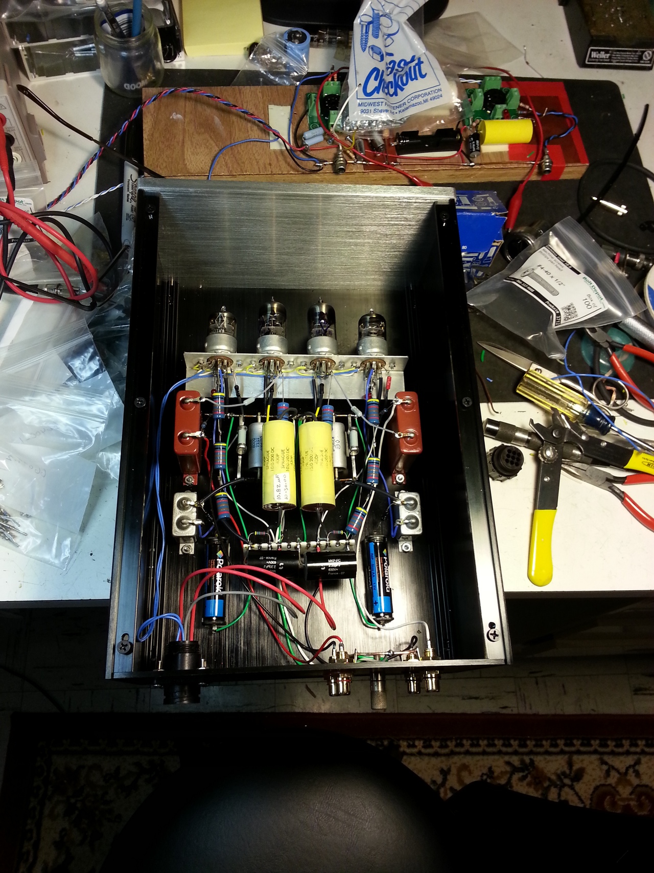

Muscovite Mini Build

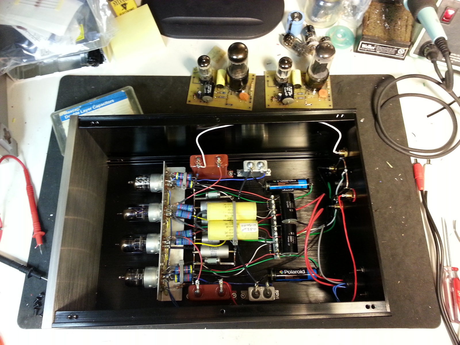

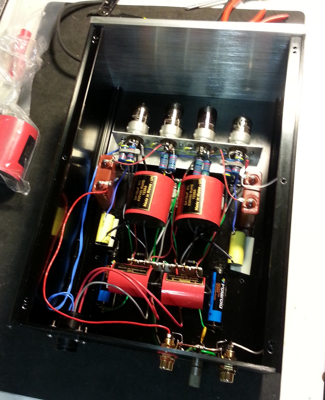

Over the past two days I built a full stereo version of the Muscovite Mini in a rather nice Chinese made chassis box that I bought on eBay for the purpose.
I went with all Russian capacitors in the EQ and for coupling, supply decoupling and screen decoupling caps are of western origin.
I was reminded of how important it is to keep things close and compact when using high transconductance tubes. I had serious oscillation problems in the second stage due to the arrangement of plate load resistors, output wiring, and the plate stopper resistors. I fixed this as I debugged and will post further details when I next work on the unit.
I've ordered another chassis for the power supply and have decided to go with a stereo power supply very similar to the Muscovite supply, except that I used some spare pc boards I made 10yrs ago to implement the supplies which should make the supply build easier. (I have neither the artwork nor spare boards.)

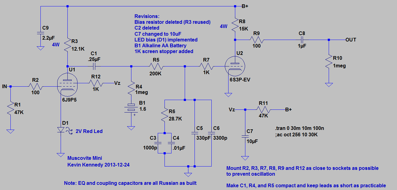

There is an updated schematic reflecting some further, but minor changes which accurately reflect how I built this one.
I'm quite pleased with the overall performance despite the excessive input level (33x transformers with a GM E II) and the power supply which is not really up to the task with ripple and broadband noise in the range of 1.2mV, the filament supply is much worse with 17mV of ripple and noise present on its output.
The sound is very detailed, and the presentation dynamic, HF extension is very good, percussive transients are rendered about as well as I have heard from vinyl, and it images well. Gain between channels is well matched (I've not measured it) with bogey 6Z9P-EV installed. I did grade them for transconductance range, but these are not matched. So not quite the problem I expected.

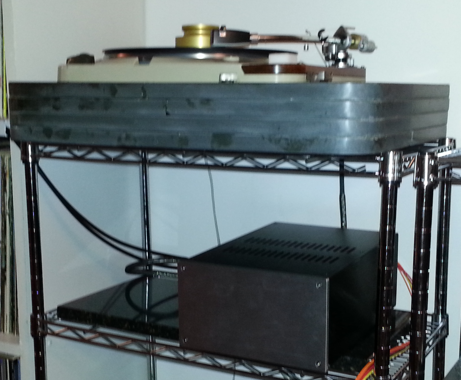

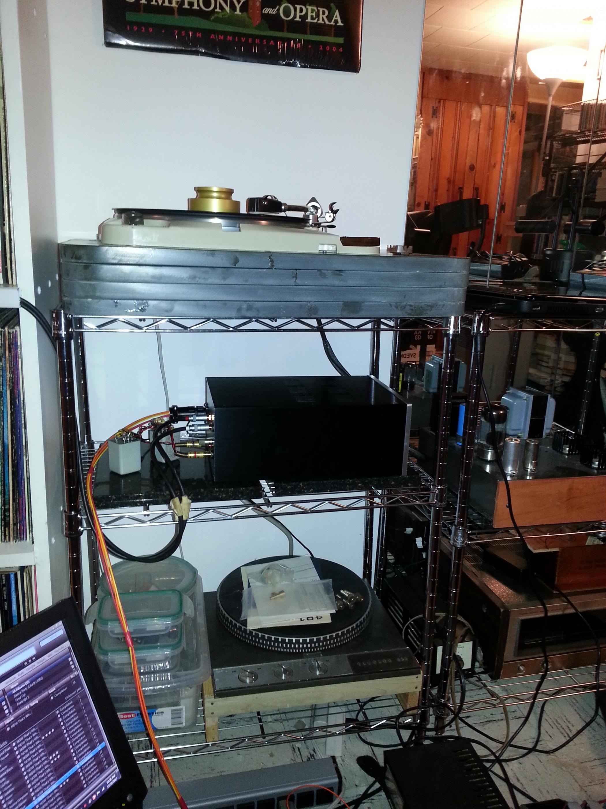

This unit was intended as an upgrade for the second and third TT, replacing my older gyrator loaded D3A/5842 design. It clearly (to me at least) is a significant improvement in performance.
Edit 12/24: Revised schematic (added C5 back)

I did some additional rework tonight, I've too many things floating around in there to completely satisfied, but for whatever reason it seems to sound a bit better.
The purpose was to reduce electrostatic coupling into surrounding components and wiring.
The screen bypass capacitors are a little microphonic, and tie wrapping them together to constrain their motion seems to help.
My biggest problem seems to be the UTC - A11 transformers I am using for step up. I experimented with taps and settled on the 200 ohm tap for the primary and left the secondary at 50K, although I did try it with the 50 ohm primary tap and the 12.5K tap on the secondary. It is a lot punchier with the 50 ohm / 50K tap, but the gain is too high, and under extreme conditions there are signs of distress from the transformer.. The cartridge is happier loaded into loads of <100 ohms so this is not optimum. I also have a pair of Partridge 977 with mu metal cores, but their gain is 6X which is insufficient. My Lundahl LL1941are configured for 16X which seems about right with the Muscovite. I could just get a pair of LL1931, the other option would be a pair of Partridge 973A (16X)...
I've listened to both turntables and pre-amps today and this one is definitely holding its own.
