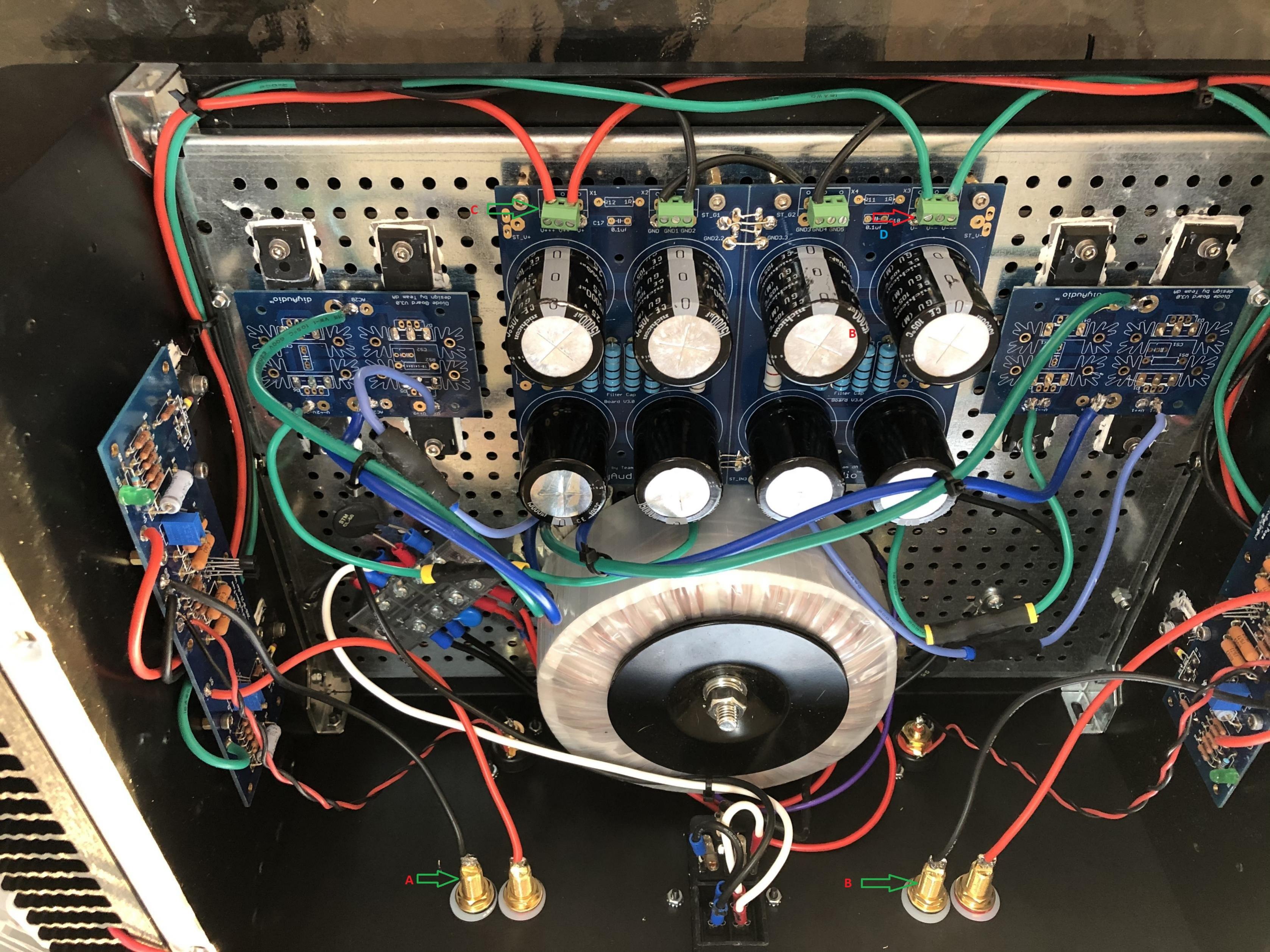

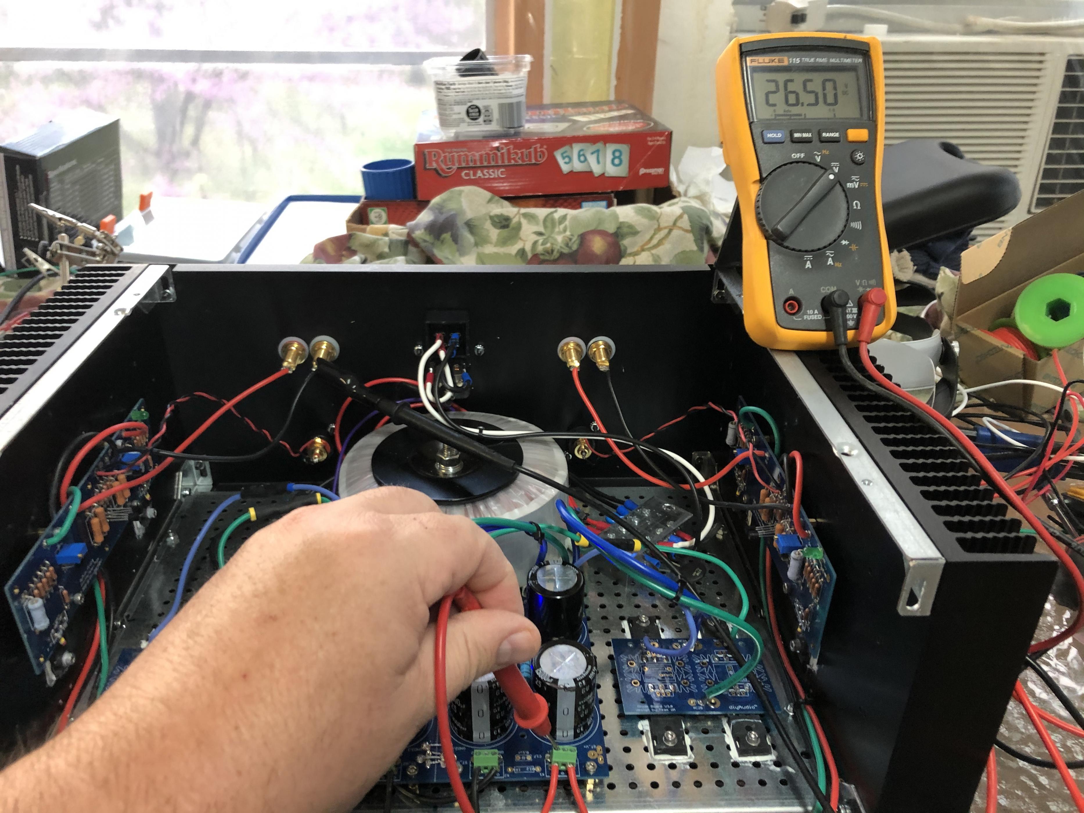

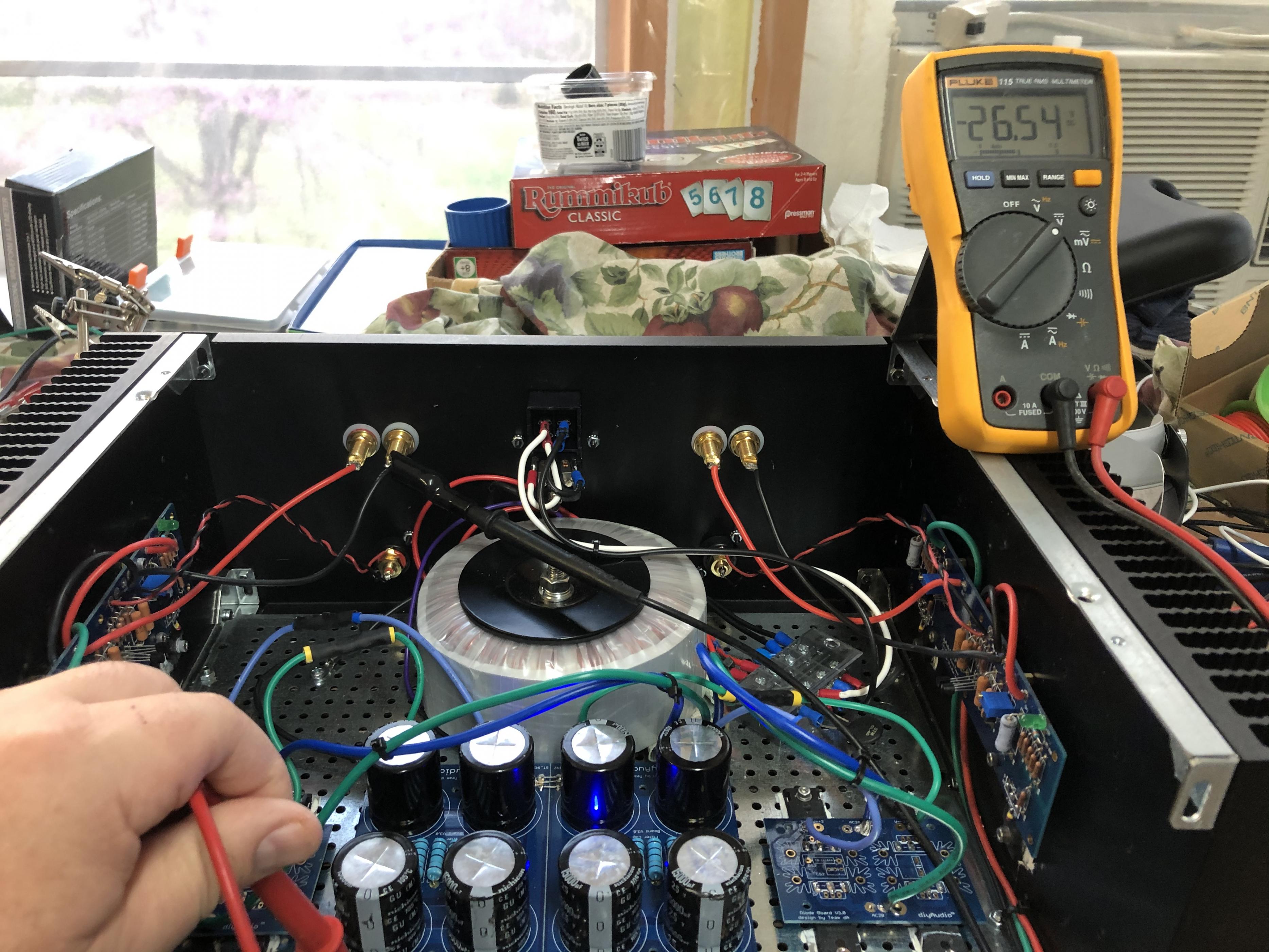

Tyer,
I think Rayma came up with a great idea.
Put the black lead of your meter on A. The measure the voltage with your red lead on C and D.
Repeat with your black lead on B.
What readings do you get?
Dan

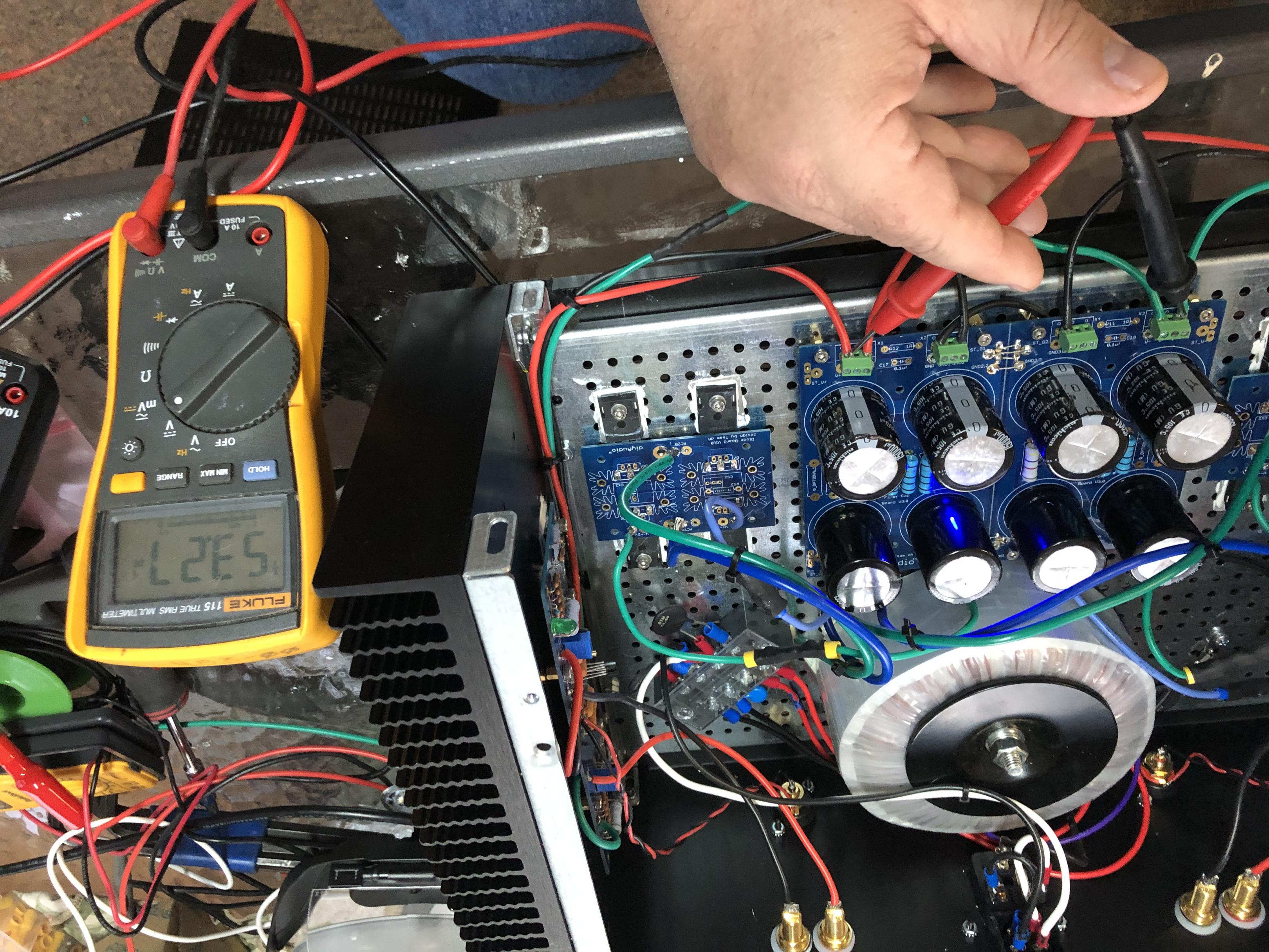

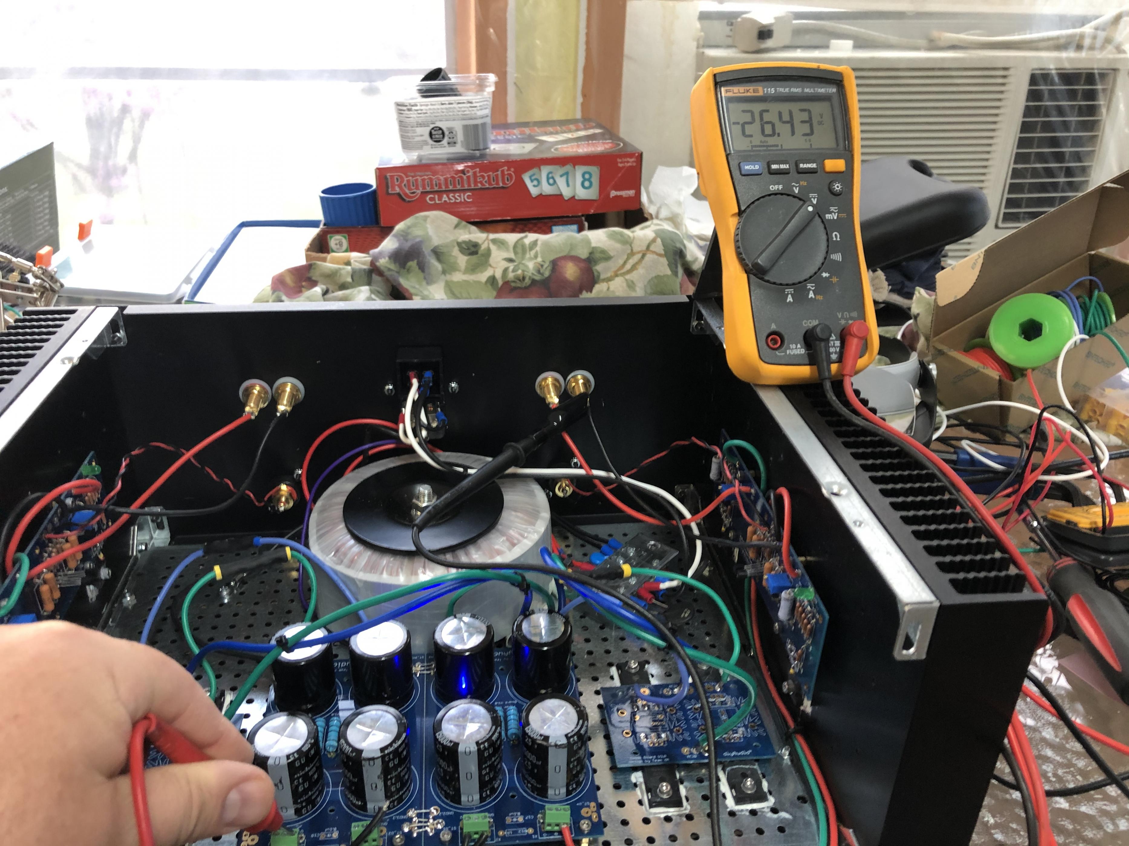

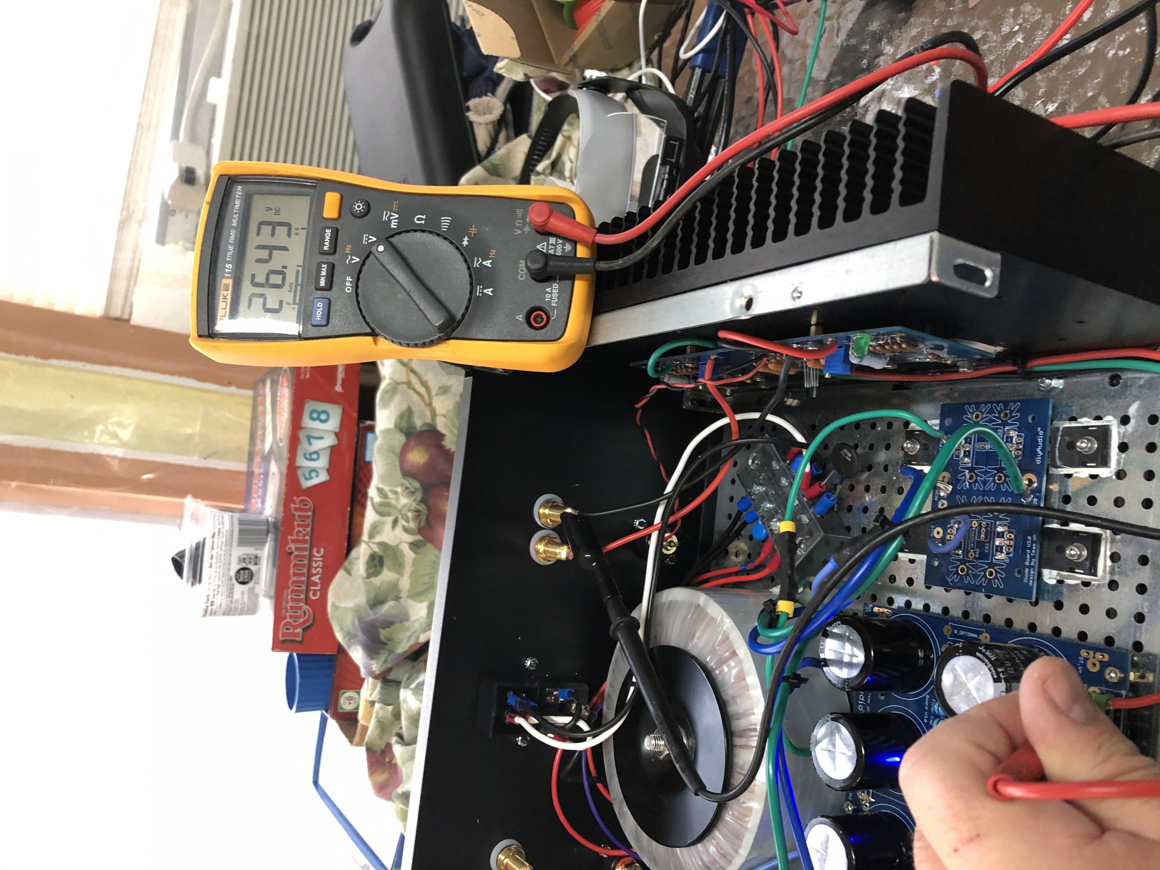

"I have 26 volts on both rails. 26 and -26."
Measure the power supply voltages by connecting the DVM black lead to the black speaker post
(for the channel you have an amplifier board installed for), and leave it there.
Do you still get both of the +/- power supply DC voltages correctly, measuring with the red DVM lead,
at the amp board? If not there is a wiring problem.
Did you use this to build it?
Firstwatt F5 amplifier v3 - diyAudio Guides

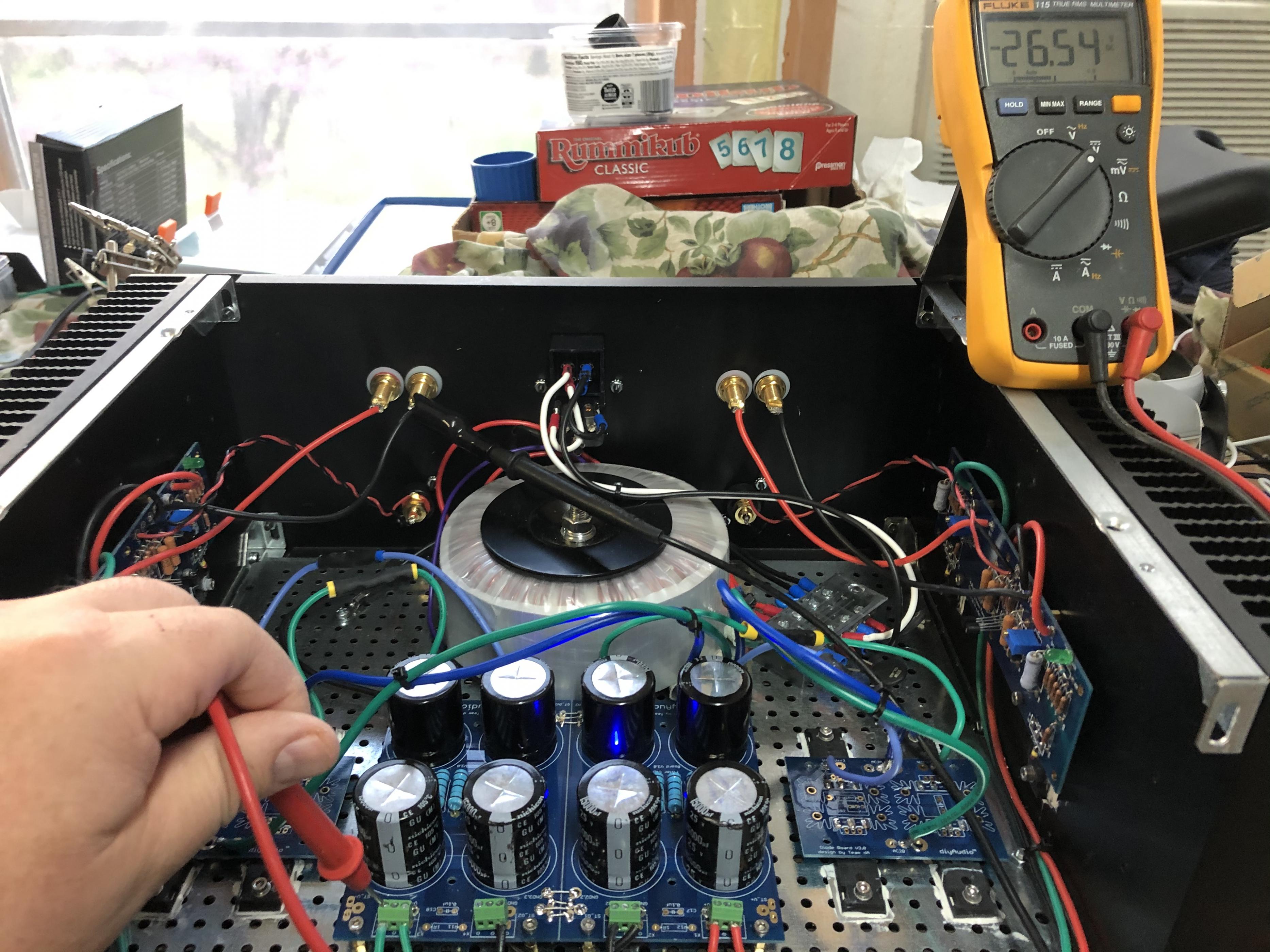

I do get 26 volts at with DMV black lead connected to the black speaker post. I only have one amp board connected at this time.
I did use the V3 power supply guide.
The answer I'm looking for with one lead on the black speaker post is............
When the other lead is on C I get +26VDC. When I move the red lead to D I get -26VDC.
We have to get on the same page here so that you know a bipolar supply contains both a positive voltage and a negative voltage. Just saying I got 26 volts does not prove you have a properly working power supply.
More soon.
Dan 🙂

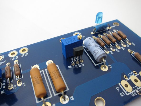

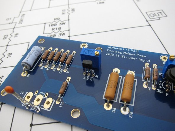

I couldn't agree more. After it's verified that the PS is functioning correctly I have another suggestion I think is the next logical step. Since Tyer made a small initial error with Q1 and Q2 I'd would like to check Q3 and Q4, and Q5 and Q5 for part number and orientation.
Dan 🙂
