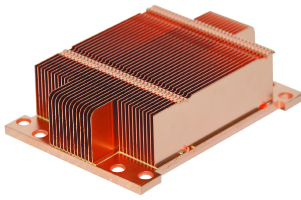

I got my new heatsinks for the amp chips (for just £5 each, brand new). If these copper babes won't keep the amp cool, I'm going to build a water cooling system (again), I'm serious.
But honestly, I don't think there will be such need - the heatsinks were designed for Xeon workstation processors, and should be able to cope with lot more heat than what LM chip can generate.

Hi Uncle,
that copper sink looks like it is intended for fan cooling.
Without a fan (even a slow turning one) it will dissipate between 10% and 30% of it's rated capacity.
AndrewT said:Hi Uncle,
depends which version of the xeon its designed for, I would guess with fan that chunk of copper can dissipate 90-110w of heat.
In its favour, its copper, has a good surface area, and a solid base. Downside is those fins are close together.
I reckon it will be more than 10% probably 20% of rated capacity used passive. That would give a minimum of 22w disipation probably more.
I would think you can get good power out a chip amp with that kind of dispertion.
As I said earlier in the thread - I may be a beginner in building audio electronics, but definitely I'm NOT one in building cooling systems 😉 But thanks for your replies anyway 🙂
I'm going to use some fan to help dissipate the heat, but it will be powered through external power supply, and shielded off from amps by radiators. I will for sure include some manual rpm control by pot, to ensure the fan runs silently. Maybe I will include some automatic (based on radiator's temperature) regulation too, as an option.
That looks like it's for a 1u server, and it probably relies on the chassis' fans to move the air.
I don't expect you'll need a whole lot of airflow. Convection might even move enough air. Gotta remember that it's not class A, so your long term average dissipation isn't going to be all that high.
If you do end up using a fan are you planning on reducing the fan current with a regulator, or just directly dropping it with a pot?
-Nick
-Nick
I know it would do fine without any fans (especially that the chassis will be a kind of open-style design). I'm going to mount one only as "the icing on the cake", if you know what I mean 🙂
I think I will include a switch between manual (pot) and automatic (regulator+thermal diode) regulation mode. Or I will make it a hybrid solution - auto control, but with pot on regulator's voltage input, so that I can easily match it with any fan type / PSU voltage. Of course, I'm going to set it so that at 'normal' temperatures the fan will be barely spinning. Yeah, I think, that's the way to go. Plus on/off switch, perhaps. And a fuse, maybe, in case the fan motor fails and shorts regulator's outputs.
