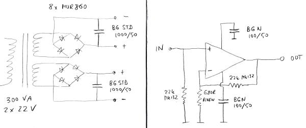

Peter Daniel said:
That's right on, a simple GC is still the best GC and I was promoting it for last three years without basically changing anything in my initial circuit.
Regulated supplies, batteries, switching supplies, snubbers, Zobels, big caps, all came and are gone now (at least for me), and simple GC still rules.;-)
Panasonic FC caps are indeed the best value for the money and it's hard to improve on them.
The biggest change, in my system, came with using small BG N caps directly at the chip and larger BG STD at the rectifiers. That changed the sound in a right direction and for me there was no way back. Although some of my friends still prefer large BG STD at the amp.
Attached is schemnatic of my Patek amp.

Sharpi31,
looking at the pictures you provided, it seems that the snubber that you used to such good effect is different from those used by Peter, and not only because it uses different value. Yours seems to be a .1uf cap, a 39ohm resistor, a 4.7 cap. Peter removes the 4.7 cap and connects the resistor directly to the + or - voltages. Thus, your resistor is sandwiched by two caps. Did I understand your implementation correctly? Thanks.
