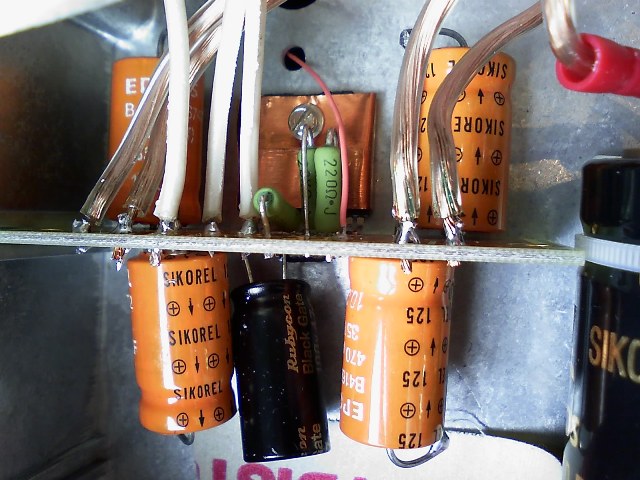

Sharpi31, why did you put copper foil on the chip? Is you transformer very close to it, or for some other reason?
And did it make any actually audible difference?

I shielded the chip because I found a massive difference doing this with the tripath chips. I'm sure it helps lose the heat from the chip too. I have a 50m roll of induction loop copper tape, so couldn't resist.
Panomaniac (I think) reported that the welwyn rc55 was a good choice for feedback, and I had some of these to hand. I have used kiwame everywhere else, but this would be too large to achieve a very short feedback loop. The welwyn is soldered on the back of the chip where the pins appear from the chip body - with this chip, you could not get a shorter feedback loop than using this technique. The profile of the welwyn is so low that even with a heatsink cover, the resistor doesn't prevent the chip lying flat on the heatsink enclosure.

This amp uses Peter Daniel's excellent gold PCB. I have BG N 4.7uF at the rectifier, and 10000uF sikorels on each power rail. I calculated a snubber value of 39ohm in series with 0.1uF for damping at 250KHz (where the LM3875 is quite sensitive to noise, apparently) and mounted this on the rectifier board too. The caps on the amp board are 2x 470uF sikorel per rail per channel, with the BG standard 47uF sitiing accross V+ and V-.
I tried small bypasses at the chip pins and this muddied the sound considerably. The 47uF BG seems to focus the sound significantly and lowers the subjective noise floor.
I have liked the Kiwames from the first time i tried them - very smooth and spacious. The dynamics of the sikorels work well in combination.

sharpi31 said:I tried small bypasses at the chip pins and this muddied the sound considerably.
I couldn't tell the difference with or without 0.1uF ceramic bypass caps across each rail (0805 X7R ceramic caps literally right at the pins) of my LM3875 based amps. The sound is far from muddled too!

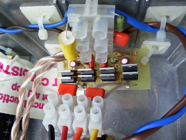

This is the rectifier. You can see the mains filtering at the top and bypasses on the secondaries too.

Sharpi31,
looking at the pictures you provided, it seems that the snubber that you used to such good effect is different from those used by Peter, and not only because it uses different value. Yours seems to be a .1uf cap, a 39ohm resistor, a 4.7 cap. Peter removes the 4.7 cap and connects the resistor directly to the + or - voltages. Thus, your resistor is sandwiched by two caps. Did I understand your implementation correctly? Thanks.
