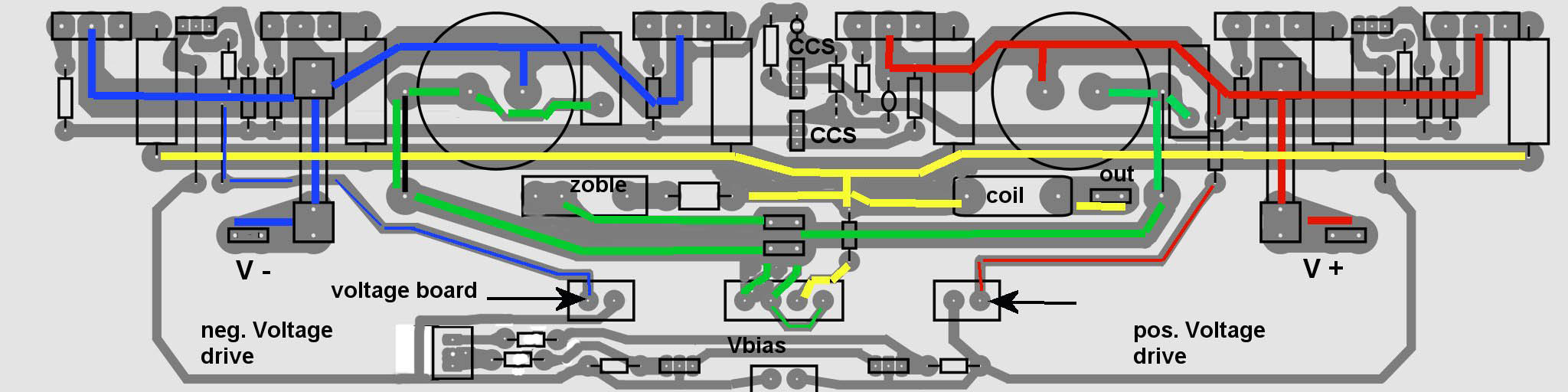

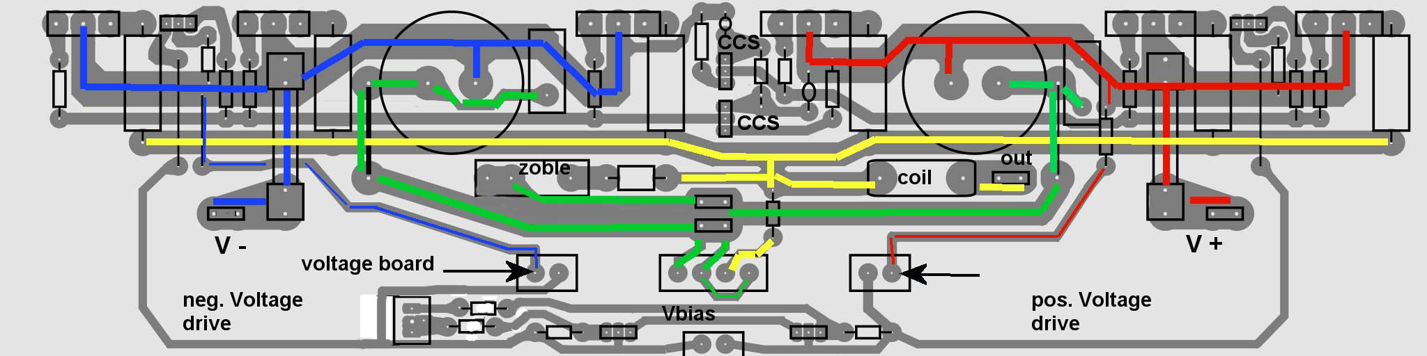

Getting closer (attachment 1) . Done the hard way. REAL hard. The power board will look pretty , I guess that is important , but it should be pretty free of parasitics and possible feedback (no outputs near inputs ,feedback loop wrapped with a ground trace).
This board will do either a Self EF2 or a EF3 (CCS or resistor) , use 3 pair OP's,large "hardware variety" fuses (5 x 30mm) , 6800uf onboard decoupling.
The voltage board will mate with European connectors / edge pin strips.

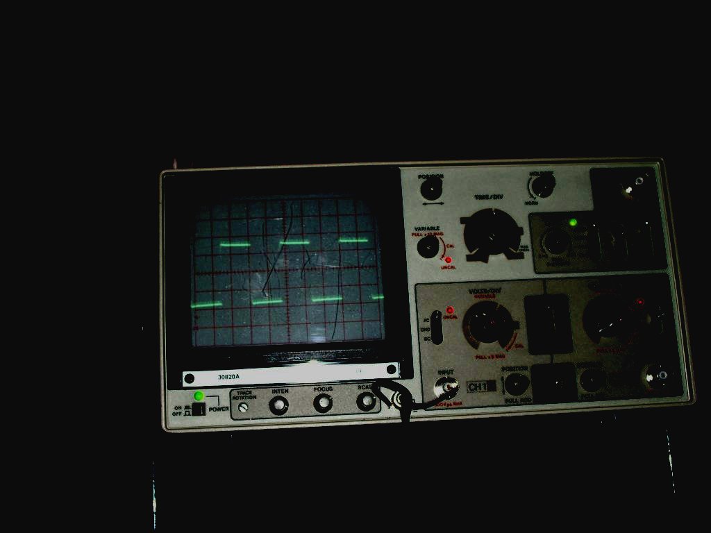

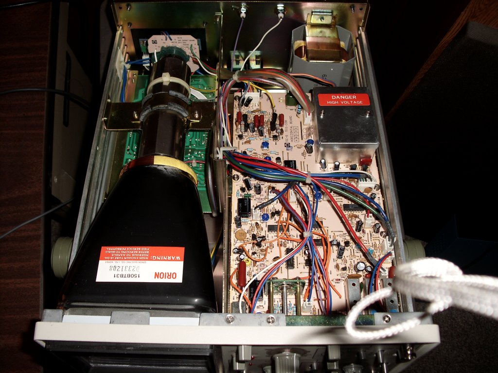

Scoped the Existing "supersym" with new scope (attachment 2/3) looks a little overcompensated at 20khz /80V with it big 68pF millers (rounded edges). For $20 , I could not resist a 20mhz hitachi scope (thats whats inside) ... no probes though. Time to make the Voltage board. When both are done I will submit them.

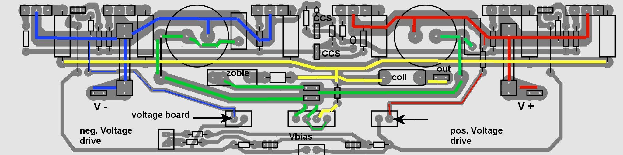

I've got a couple of suggestions but should clarify I've got no idea about PCB design/layout etc
Move the bias pot in a little so the track does not need to go under the two resistors. Add a pad to the pot so both inline and offset types can be used.
Fill in the track next to the Zobel (green tracks next to each other).
I've attached a free hand attemp to show what I mean
Cheers
1.Move the bias pot in a little so the track does not need to go under the two resistors. Add a pad to the pot so both inline and offset types can be used.
2. Fill in the track next to the Zobel (green tracks next to each other).
I've attached a free hand attempt to show what I mean
Cheers
Rob
There are a lot of tweaks I will still do , so I am still learning ,too. 🙂
As far as your #1 , I could eliminate 1 jumper (one of those resistors is a jumper), the bias pot is a good idea , since inline ones seem to be more common (mouser has both).

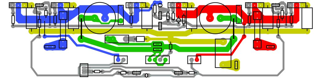

#2 ... my "take" on this is that the zoble return is a separate "garbage path" , mostly RF , that should be separate from the Rail returns. The rail returns should be equal length and width (symmetric). The 2 little green traces are for the small voltage board's decoupler's and the input ground (again separate) , all terminating at the main star.
I still have to give the output coil more room (10 X 20 MM) and general cleanup.

no,
just the R//L off the PCB.
The R+C is an HF load for the amplifier and as such should have a defined HF impedance. Long leads and/or traces will introduce undefined inductance and potentially ruin the desired HF loading that the Zobel is intended to provide.

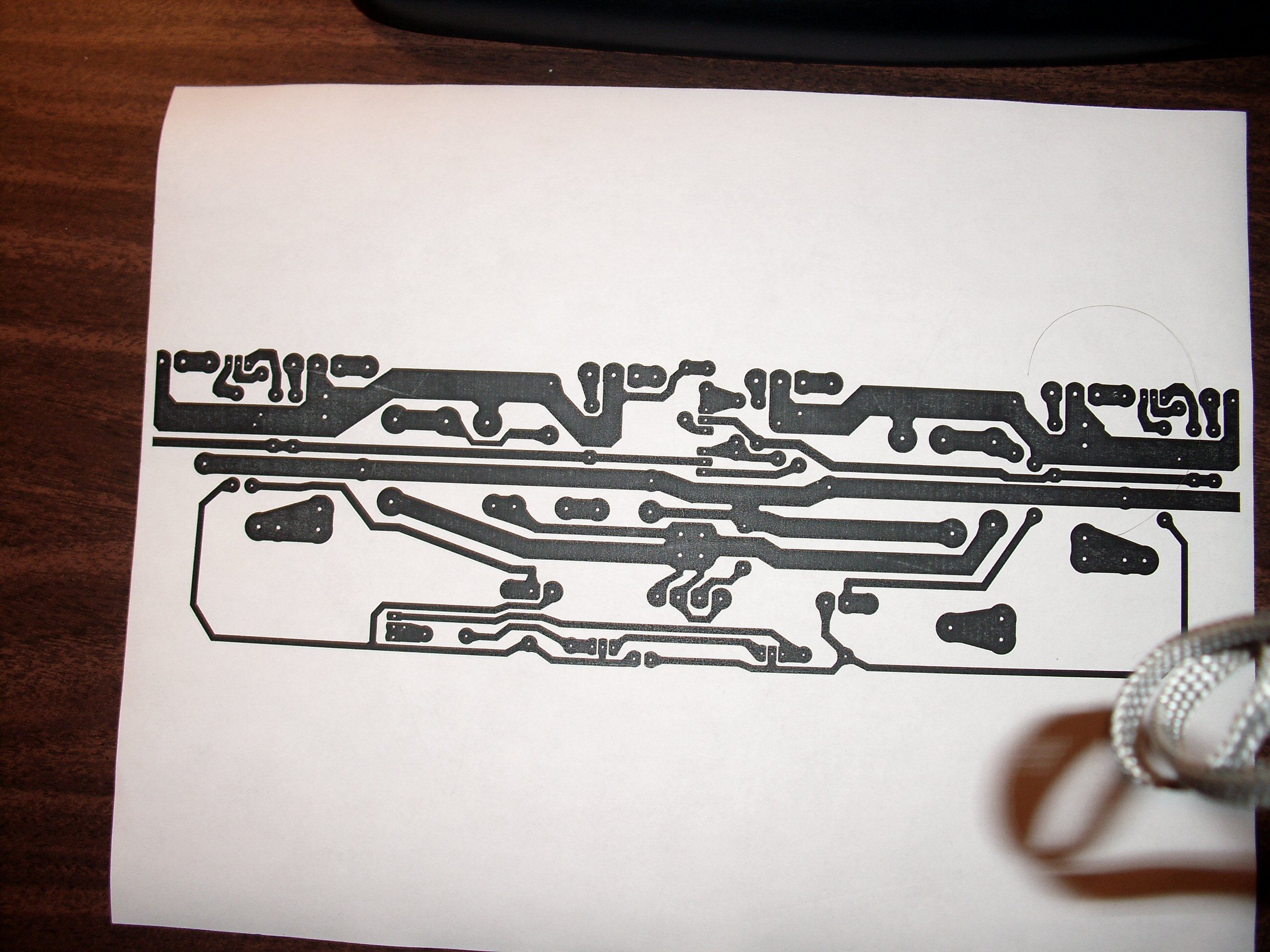

so happy ... 🙂🙂🙂🙂 my caveman paint shop pro technique does beautiful on an HP printer for PCB's (no anti-aliasing). It is so nice to have all your own equipment.
The Zipfile attached has all the schemas , artwork , parts placement for absolutely stunning toner transfers. (Attachment 1) I need to buy more toner , almost out. 😡

The power board will look cool ,too . 2 red LED's , very good layout ... looks as well as low parasitics(attachment 2). One will have the option of all 3 varieties of EF's with 2 small jumpers on Q16 and 17. Also.. I was thinking of a trimmer for the main CCS of the amp. On the real one while scoped I could get the LTP much more symmetrical improving the sound further by adjusting the current slightly. This will also facilitate "fine tuning" for different power supplies.

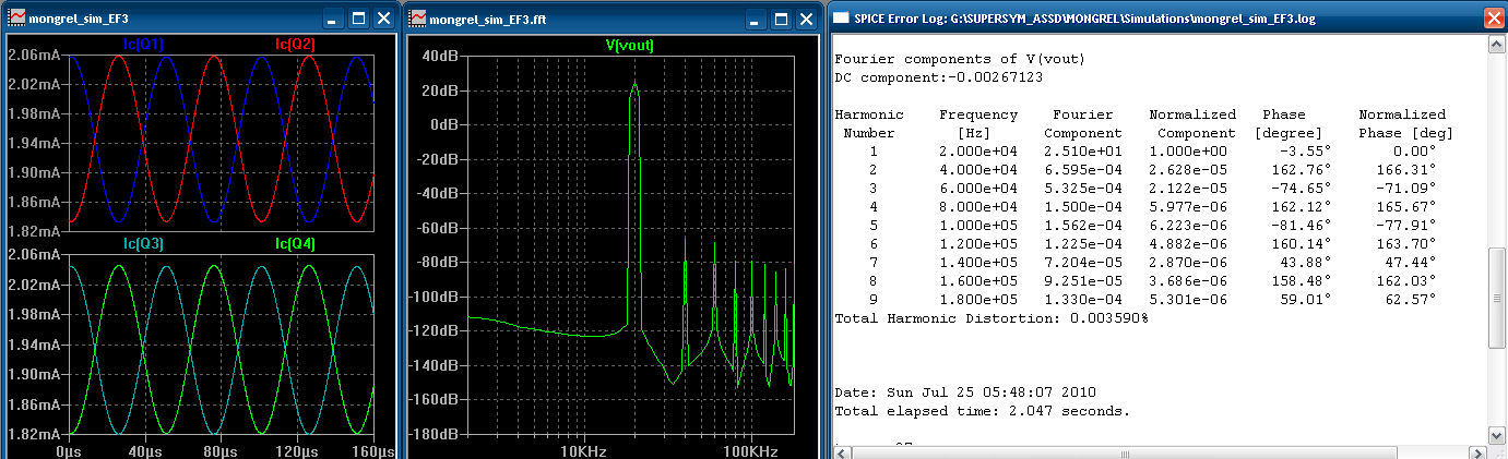

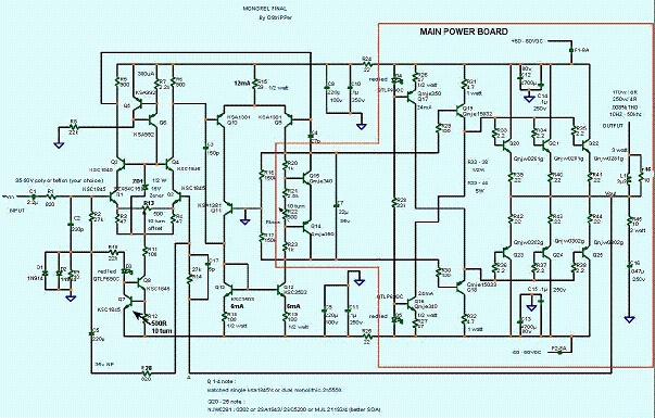

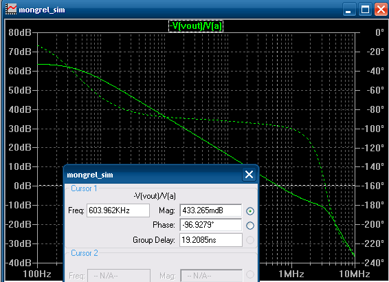

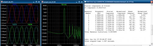

All done with the boards , A new (and hopefully) final schema (below).

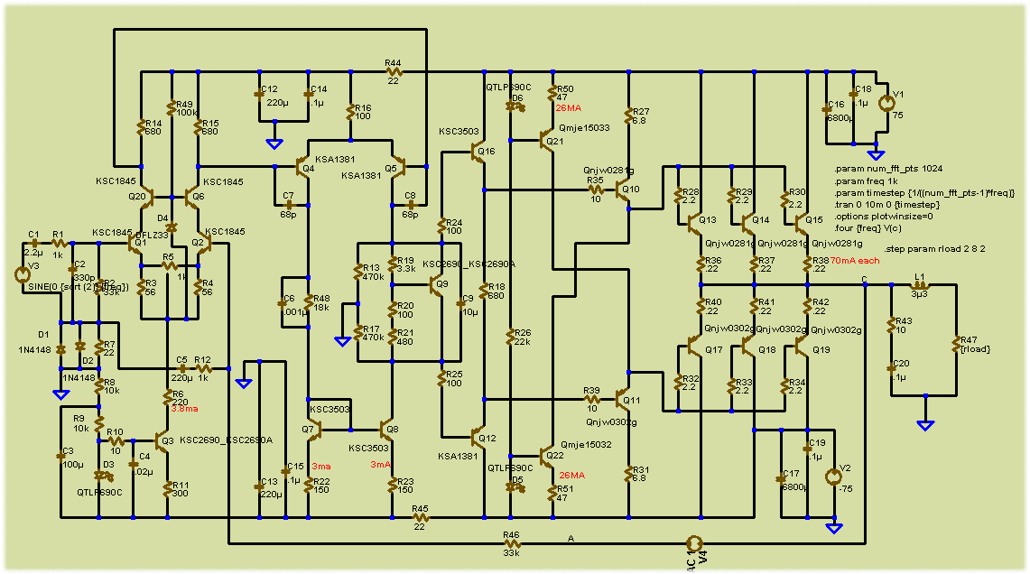

Now I have to order all the little parts. So ... a BOM is coming , very detailed ,with mouser part #'s. I had to finalize all the MODS that the board can do (EF2 , EF3 , and J112 FET's). The simulations are all in attached " mongrel_sim_all.zip".
I did all these modifications on the real "supersym" WITH my new scope , so all is good to go ...(no :redhot::redhot: )
What you see on the plots was confirmed in the real world , so to hell with those who say simulations are "lies". EVERYTHING in the simulation coincided with what readings I collected in the "real world" .. currents , waveforms all within a few % 🙂 .

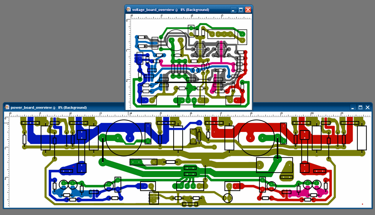

The colored PCB overlays which I show below are my form of "visualization" to get the PCB artwork right for symmetry and grounding. BTW , the red outline on the schematic is what is on the power board.
My thanks to the Bob Cordell power supply interview , Nelson Pass's discussion on cascodes ,and ESP audio's project 15 (capacitance multiplier) that I added to the power board.

Edit , I have to post again to get the artwork on (very large 1200dpi )
