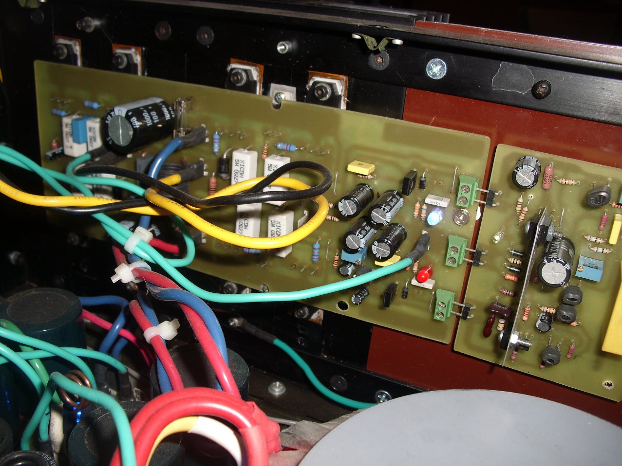

I took longer that I would have expected , but I am not disappointed. The unit was in excellent shape externally (pictures 1-4).

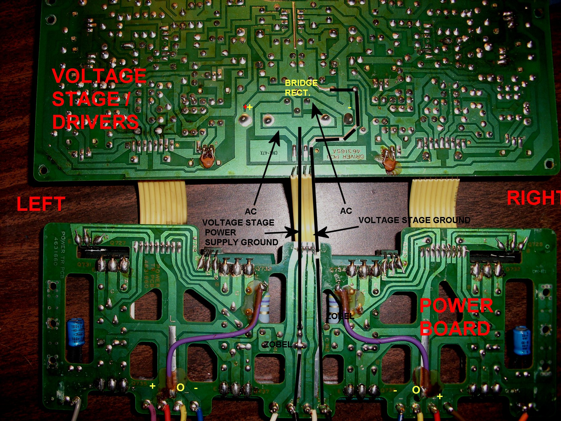

Elegant , huh ? More like "well researched". I studied the original Nikko amp to see how they implemented the dual supply. NO cap multiplier .. just a bridge and 2 caps. I was surprised to see no .1uF decoupling caps in either the low or high power supplies. (Below 1 ) I will have separate cap multipliers per channel fed by a single 65-0-65Vdc supply (1kuf - same as the nikko). . .

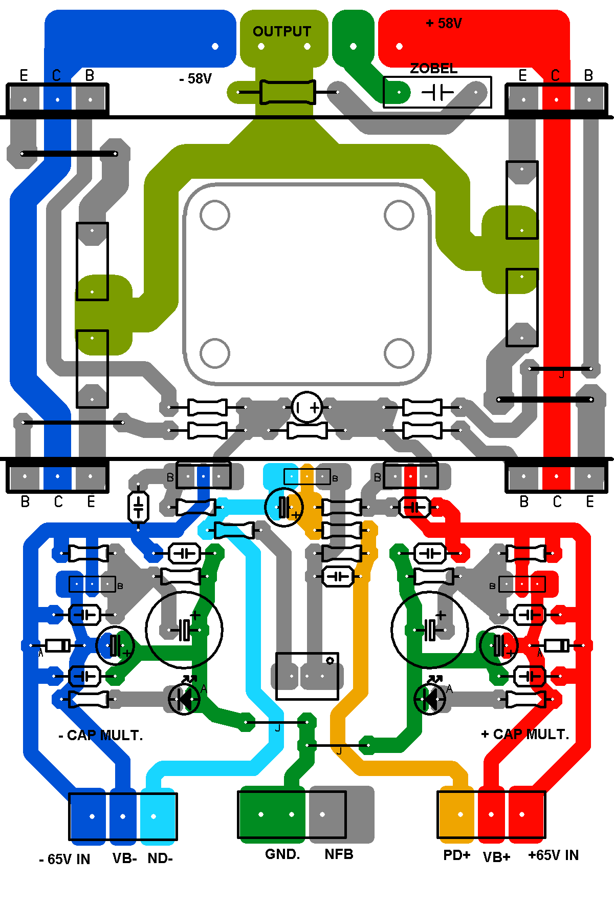

I WANT the -115db hum and noise of the Nikko !! I have "stolen" (assimilated) the best ideas and layout style of this fine Japanese amplifier. Below (pix 1) , you can see the grounding and general layout of the Nikko. I know I have been on the right track , as this amp (in the picture) used separate grounds for the unregulated driver supply and the actual ground reference of the VAS/input stage. The only decoupling for that VAS/input stage is 2 - .1uf poly caps ... just like you would use for a op-amp. 🙂

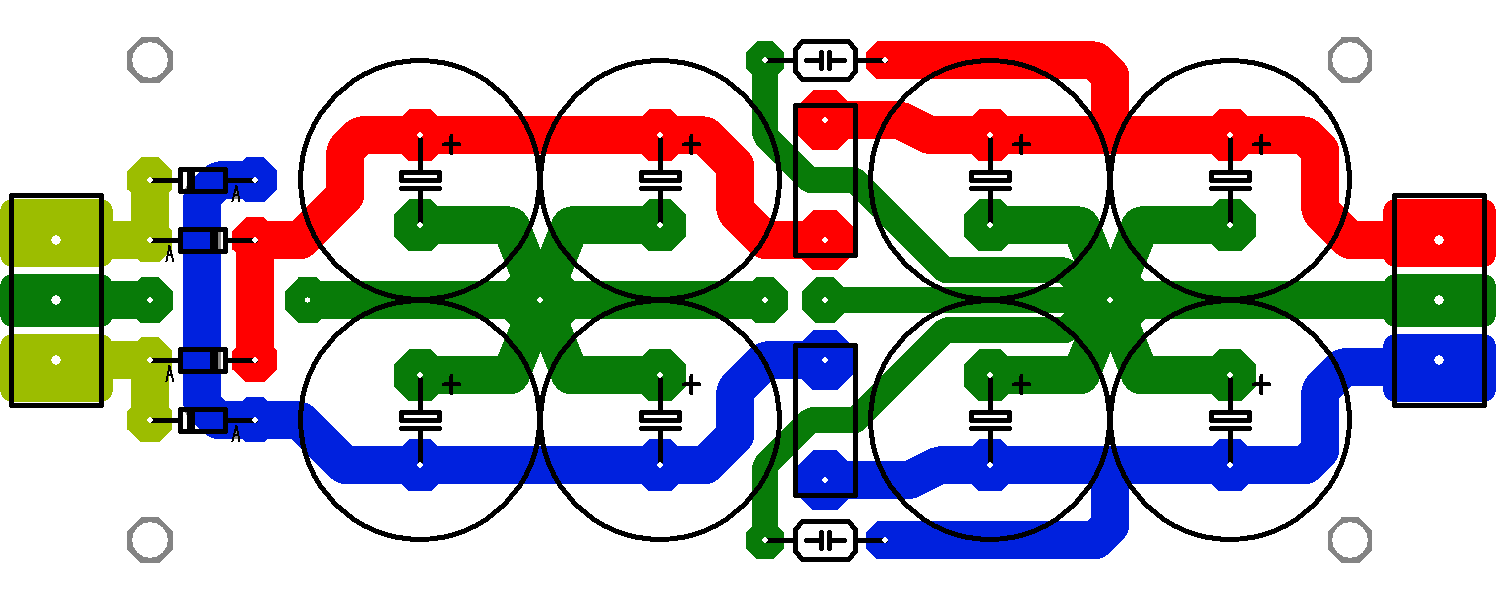

MY VERSION , which will also be in the "kit" , uses the best I have done plus a few tricks of the Nikko. Below .. (pix 2) , my power board has the addition of a simple single order cap multiplier. the VBE and it's trimmer are smack dab in the middle.
blue=V-
red= V+
light blue= negative OPS drive
orange=pos. OPS drive
green=ground
yellow = output
The separate 65v (higher voltage) power supply (separate board) , the Zobel's, and the actual voltage stage will have separate ground returns to the amps main star ground.
My low voltage supply (+/-58V) will be 4 X 8200uF@100V (16,400uf X 2) versus the Nikko's 15Kuf , my High voltage supply (+/- 65V) will be 8 X 470uF @100V (2k X2) double the original. PS boards are next (simple).

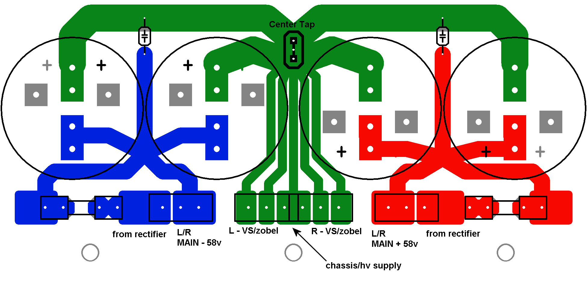

Below, (pix 1) .. I "borrowed" the general layout for my brute force supply from the Nikko but added 2 more caps (32,800uF total) .. better ESR , higher voltage (will last 20 years - 58v on 100v caps 😀 ) . (Pix 2) is the smaller 65V supply , I went hog wild with the star grounding (fun , fun 😀😀 ) and added a 8 cap super CRC to the mix. My drivers will be "sippin' on the good stuff". Cap multipliers also "sip" on that 8 cap super low ESR CRC board (preamp style 🙂 ).

That's just like 1880uF series to a speaker. Is it enough to fully support 4 ohm speakers? Sorry to ask, but I'm having a doubt.
Dan ,the HV supply , used only on the more "elite" class of amps (Goldmund , nikko , a few others), Does not directly feed current into the loudspeakers. It ,at a higher voltage , independently feeds the drivers and voltage stages/cap multipliers. The loud speakers are fed separately by the "brute supply" (58-0-58v with the 32,800 uf capacitance). This relieves the low current stages of the massive ripple caused by driving the reactive load of the loudspekers.
Think of it as a small chip-amp with a separate supply driving a larger chip-amp who's only job is as a current amplifier. The advantages are quite oblivious.

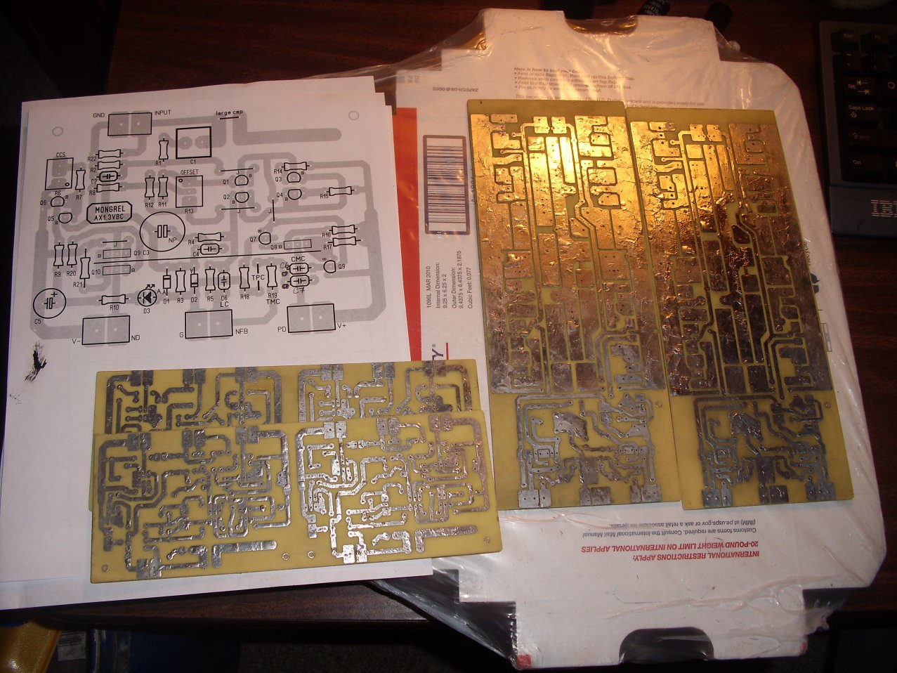

I have been etching away.. whew !! I do like my PB250's (below 1) , but they are too big .. I don't need 500 watt peaks. 😱 SO , all my big Mongrels will find "new homes". I was going to replace my present 250's with the "H" model (below 2) , but these will also find a new home (ready to ship).
Now , I am going to devote myself to 2 amps .... the AX and the EX. Both will be complete in PCB form with cap multipliers and dual PS capability. Wait till I get the Nikko (the prototype) going to assure that everything is perfect.
I won't be a prick !!! I will show the final AX and EX PCB work on this forum and offer intelligent answers to any questions/problems ??. Any of my previous modular designs are fully tested and If anybody wants one ...PM me. I now have to design the Final AX and EX (more fun) , I promise to make them 110% (the best of the best 😀 ) in both economy and layout.
