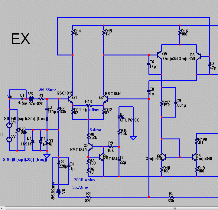

(Below 1/2) are the 2 best , durable and best sounding results of my "fiddling".
Both have been running for months and I am satisfied with the sound. The TO-126 devices (ksc3503,ksa1381 / mje340-350) are thermally coupled to a small piece of aluminum. Any 2Q's (IPS CCS , LTP,CM) are "face to face" coupled. Next I will pick 2 OPS's to go with these rock solid voltage stages. 1 will be BJT , 1 will be Lfet ... 4 or 6 devices.
Instead of the 200W/8R amps I have been doing , a good 120-150 watter with 4R capability is more of a diyer's "sweet spot". I have looked around Ebay , this forum , everywhere else and the "mid" sized amp is the most popular.
PS. the 15032/33's will drive nearly an unlimited # of Lfets. 6-8 pairs or many more with 80V rails (monster amp). 4 pair BJT is the limit without a triple... but in the case of a triple I would just use another njw0302/0281 pair as the driver with the 6+ pair - monster OP stage

I still may include the 1K trimmer between Q1-2 ... for the newbiees.
R18 becomes a 220R + a 500R trimmer. That's all , folks (besides a 4-device L-FET OPS 😀 )

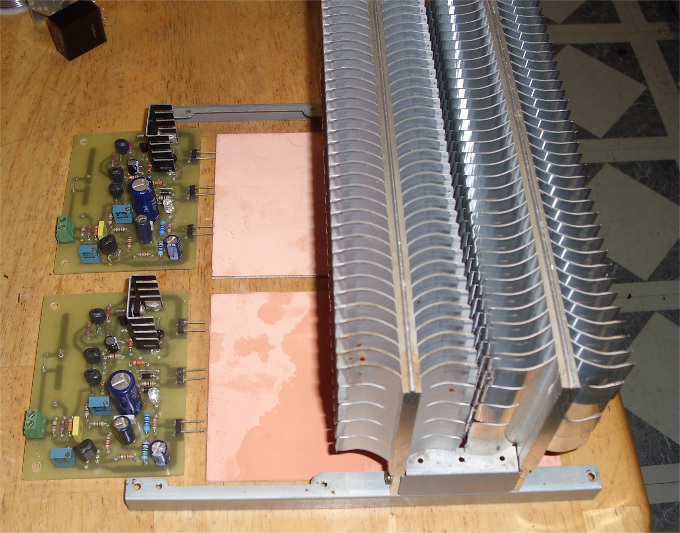

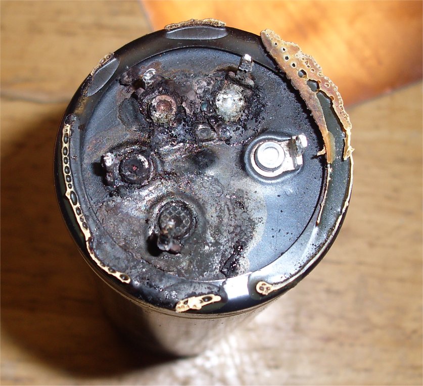

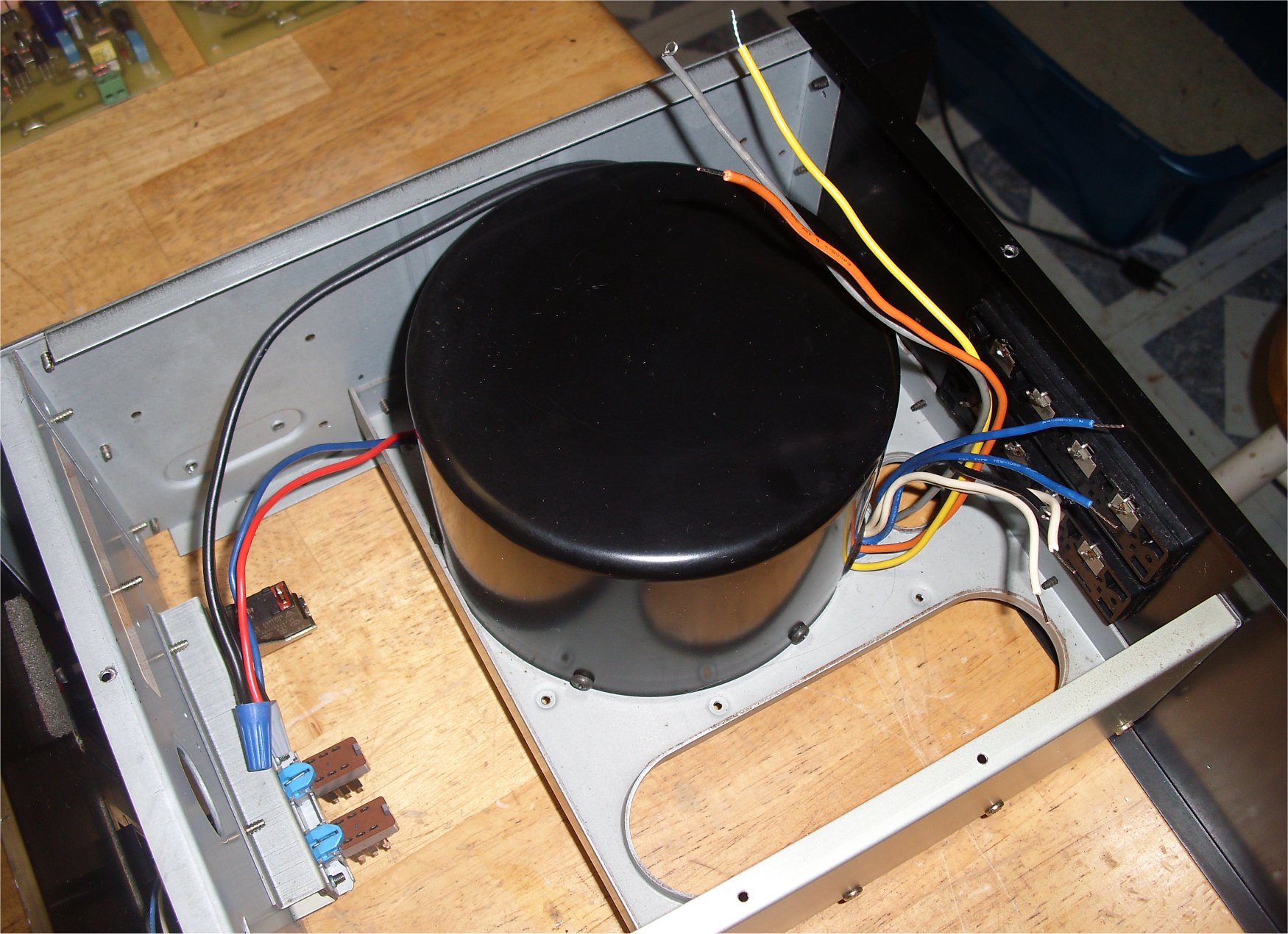

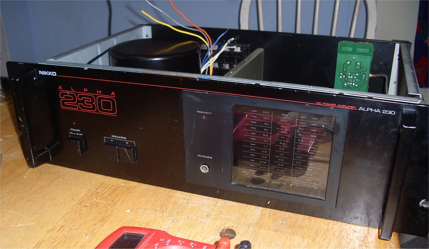

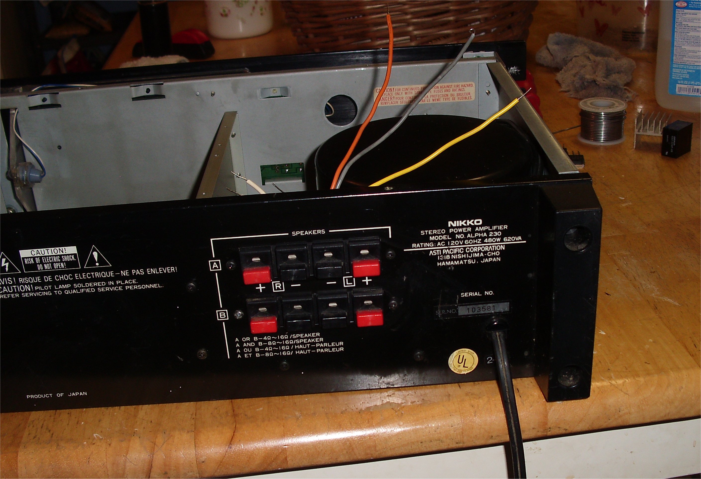

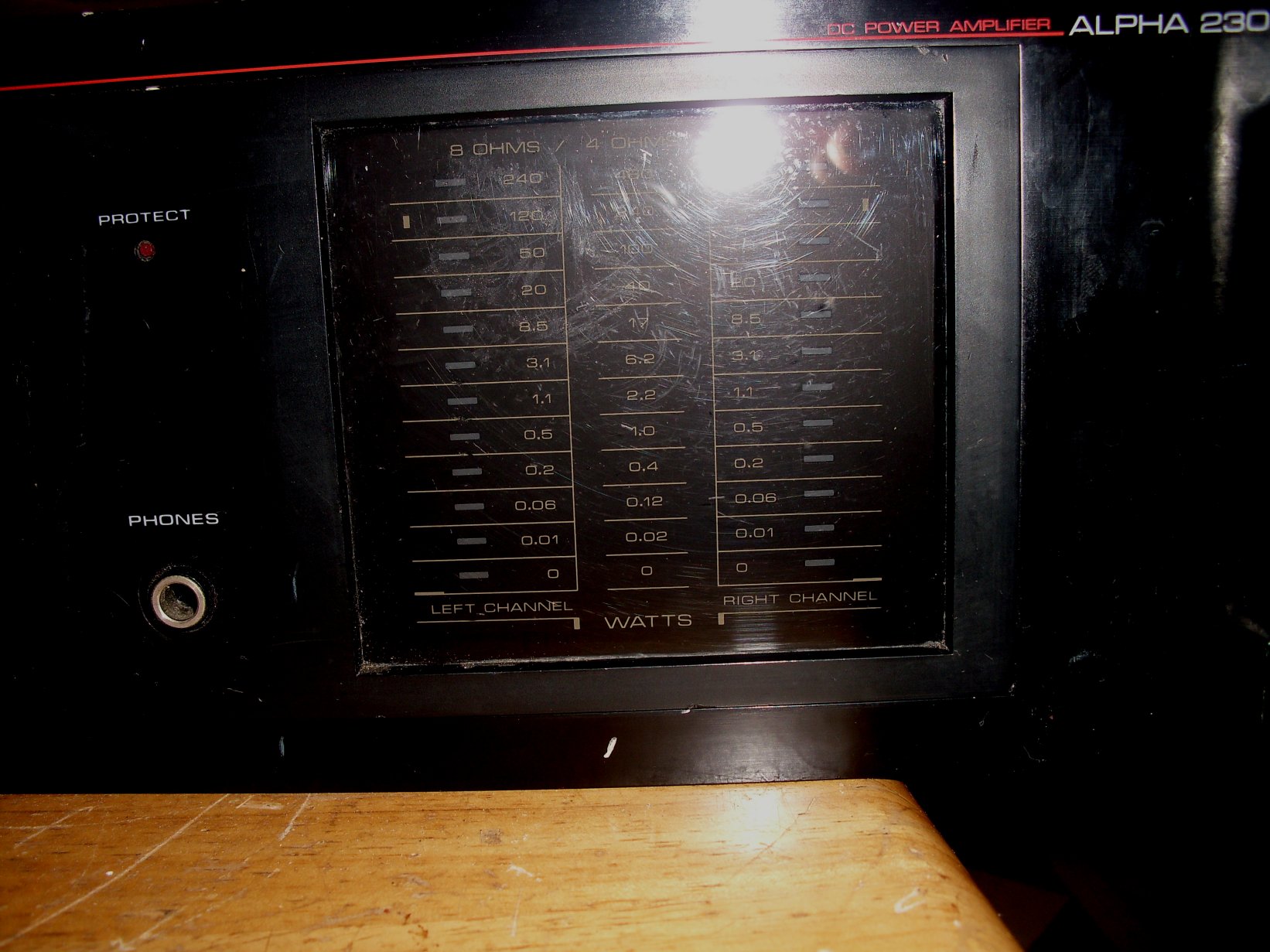

Finally, I have the $20 Nikko .

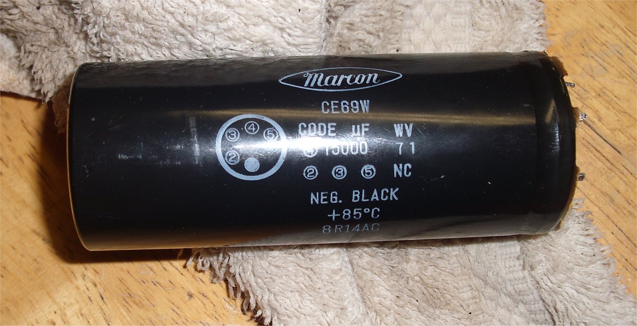

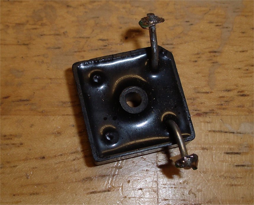

I took longer that I would have expected , but I am not disappointed. The unit was in excellent shape externally (pictures 1-4). Very heavy construction , a 600VA (48-43-0-43-48 / 8 and 16v - 3 secondaries) toriod trafo -tested perfectly .. perfect for a Mongrel PB120+ with dual supplies. The original amp was quite fried , the 15kuF supply caps leaked and burned .. destroying the main PS board and bridge (pix 5-7). The caps were huge, rated at 71WV/5 pin snap-ins ... they failed allowing full unrectified AC to go right to the amp , blowing the VAS,drivers ... everything. All the main amps caps had the tops blow off them (firecrackers 😱) ,the Bridge had the leads fall right out.
I'm past the "dirty work" already , case -heatsinks -trafo ... all cleaned in alcohol , boards stripped out , trafo and front power meter tested AOK 🙂 .
To "implant" a mongrel will be quite easy , might not even have to drill any holes (pix8/9). Unlike the other Nikko alpha thread , I WILL !!! complete this soon .. I have plenty of parts (enough for dozens of amps) and the necessary motivation.
This will be the final prototype for the "KIT" , I will perfect and audition before I pass it on for DIY 🙂 . With the pretty meters , better parts , and my nice PCB work ... this should work out VERY good.

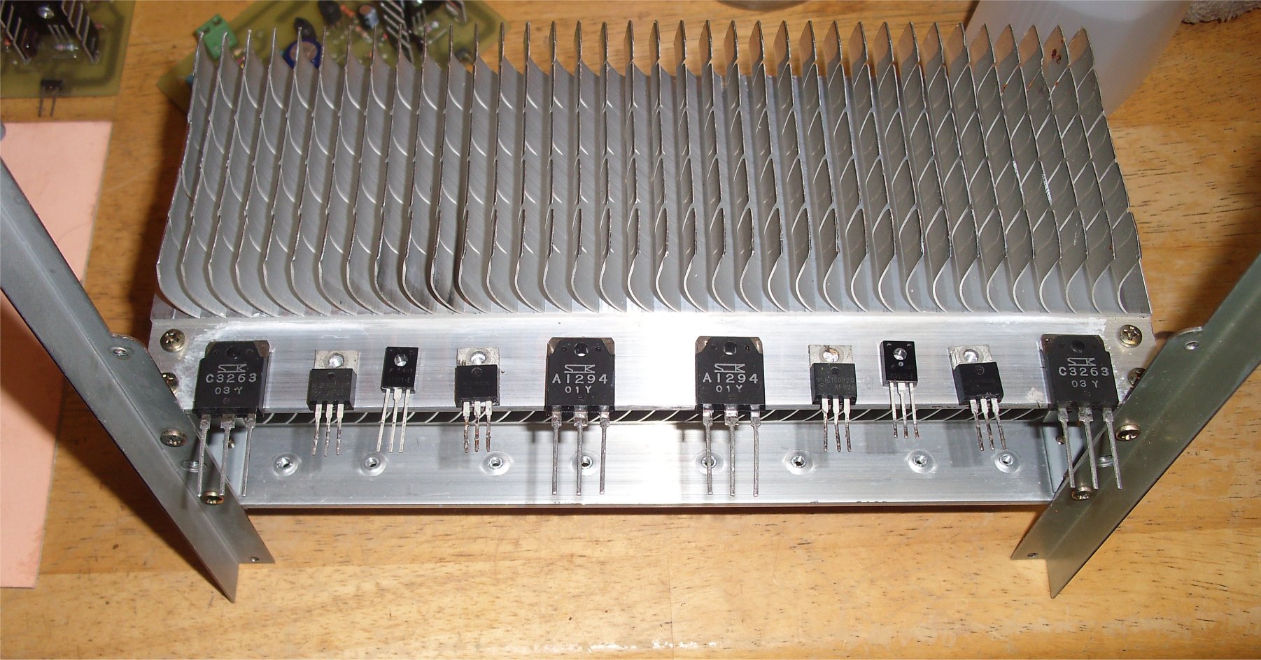

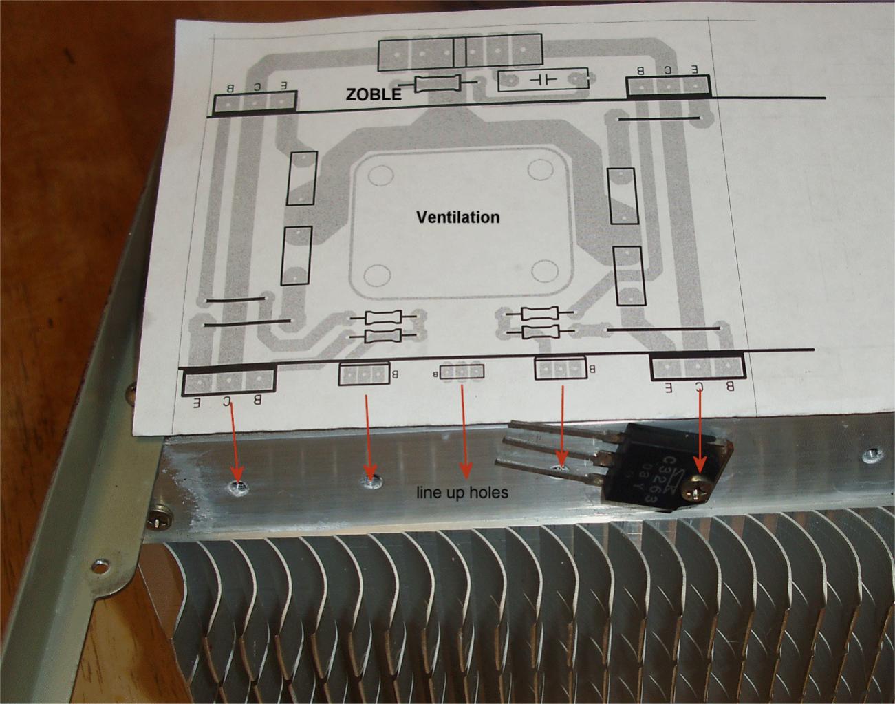

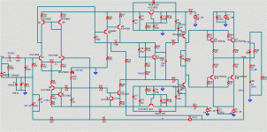

Elegant , huh ? More like "well researched". I studied the original Nikko amp to see how they implemented the dual supply. NO cap multiplier .. just a bridge and 2 caps. I was surprised to see no .1uF decoupling caps in either the low or high power supplies. (Below 1 ) I will have separate cap multipliers per channel fed by a single 65-0-65Vdc supply (1kuf - same as the nikko).
These designs are "right on" with the Nikko as far as grounding/layout , in fact .. the AX is even a little more refined. I also saw the Nikko feeds the drivers from the "high" (65v) supply , this would cause a bit more ripple to the rest of the voltage stage. I decided to compromise , run the drivers from the unregulated 65v and feed the individual voltage stages from the cap multipliers. In the end ..my voltage stages will be at +/-63.5v , drivers at +/-65 , and the OP devices (on their separate unregulated supply) running at +/-58V.
TOO MANY Choices 😱 ... I would ask for comments on whether I should run the drivers unregulated or filtered by the cap multiplier ????😕
Here we are running "power hungry" BJT's. The drivers for both channels will draw up to a 1/3 amp with a 4R load at 120W+ !!
With this choice , I would need MJE15032/33 multipliers or at least MJE340/350's (a full .5A SOA with the 2V drop in the multiplier).
Retrofitting into a existing design (below 2) is a precision endeavor. Ventilation , space (spacing) Dang ! , designing the kit will be easy.
The final amp will be a healthy 120W/240W (8/4R) , have a 10-20 year MTBF , and will be easily capable of 3-400 watt peaks (4R). About $40USD in parts , and you will have a BETTER amp than the NIKKO or most other projects on the forums.
