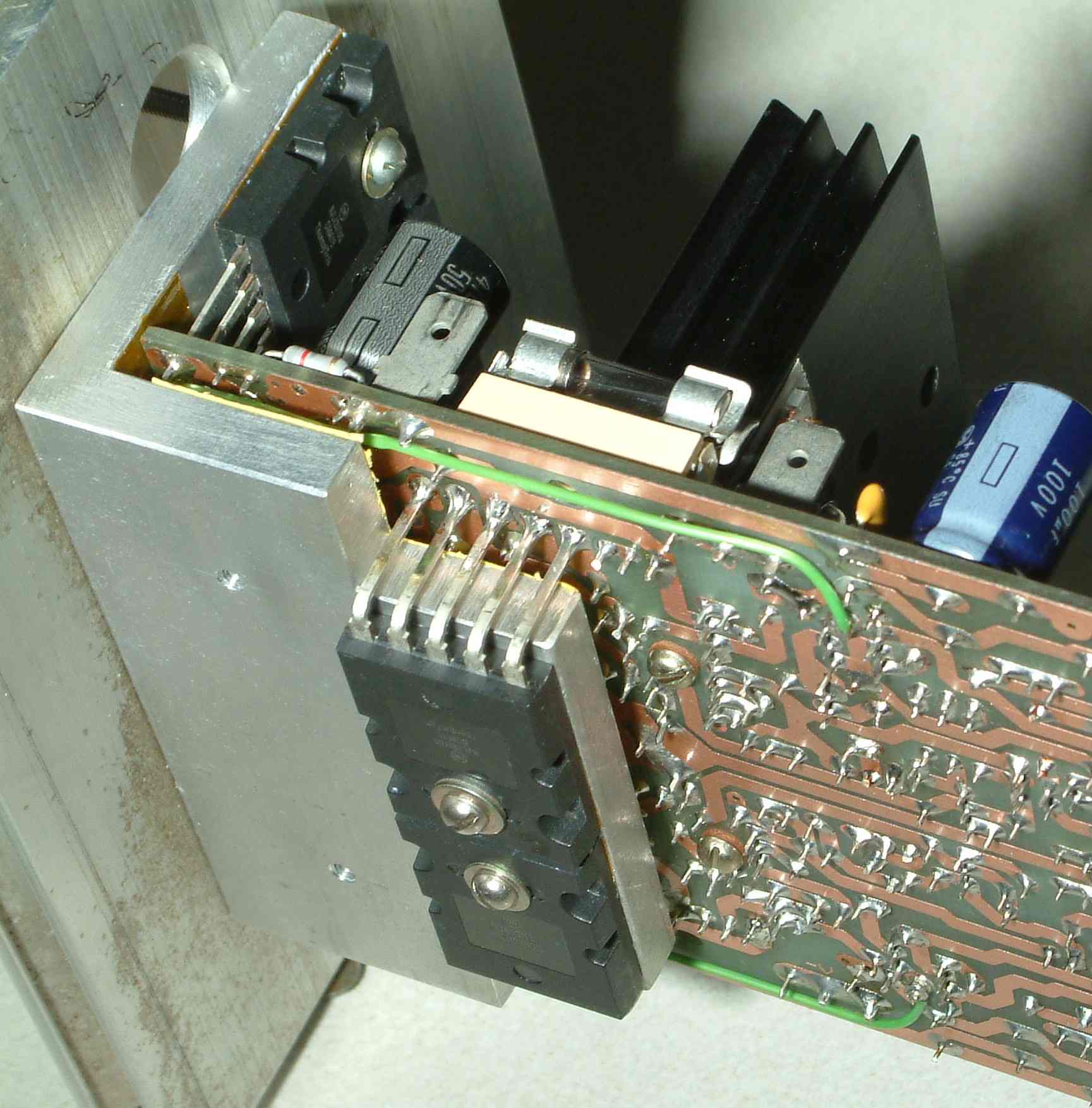

Here's a six transistor OP stage arrangement of mine. It offers an overall pcb size of 85mm x 111mm when used with, for example, my modded FC-100 (additions plus VI limiter) pcb layout. Designed to comfortably fit six into a 2U rack.
Brian.

Hi OS,
Thank you.
Brian.
With your heatsinks, "fishing" the screws through the fins would be no problem , but not everybody has YOUR heatsinks. 😀 What if the fins were spaced different ?? A "tappin'" you would have to do !
OS
My main concern with some of the examples is to Avoid creating a miniature oven underneath the circuit board (heat pooling).
As for mounting onto heatsinks, it would usually work fine if the output devices were soldered after mounting them on the heatsinks. That might not be as pretty as using a bracket, but either solution happens to work.
Yes, a heat spreader bracket might be prettier and easier and promotable, which is good for marketing--one possible way to choose amongst the several well working options available.
I'm fine with whatever option you choose, except for heat pooling. 🙂

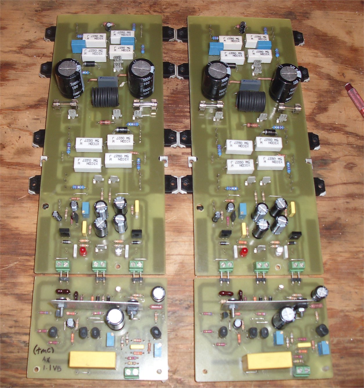

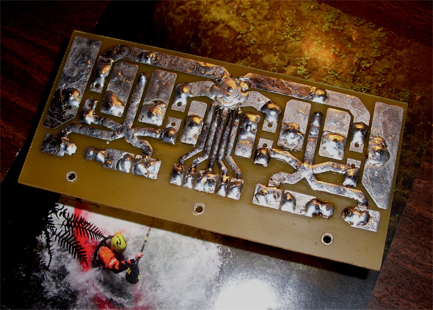

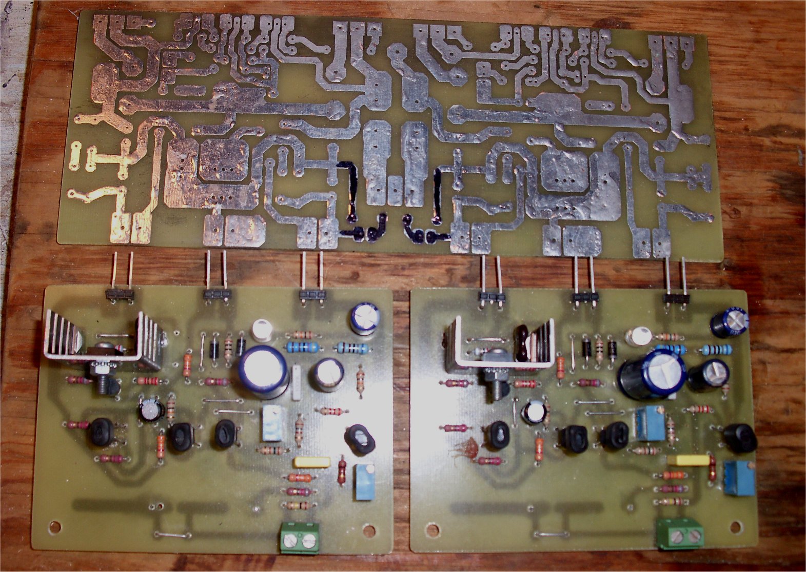

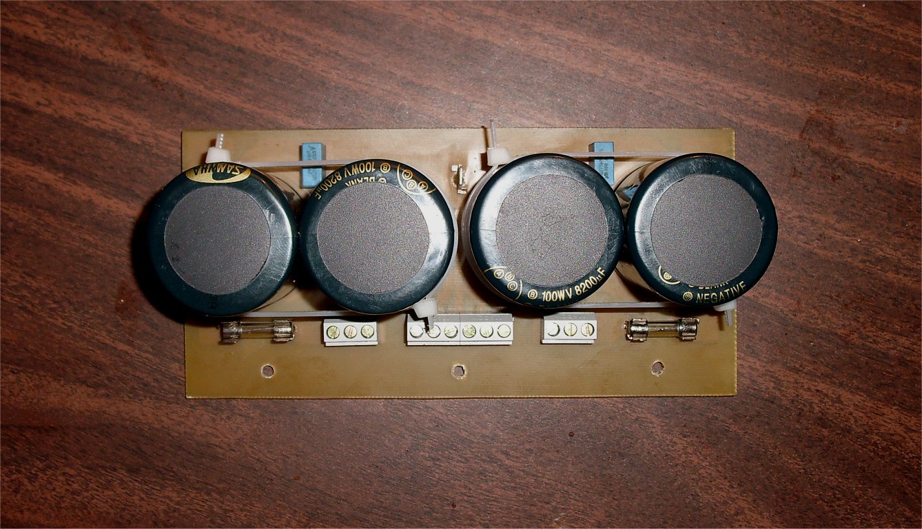

No sleep is more like it. Selling all the previous mongrels (4 PB250's/AX's) , building the Nikko mongrel out of new miracle FR-4 (teflon) , and designing the new cool mongrel kit. PIA , but I like it !
The Nikko big PS board is done , the weird FR-4 is crazy stuff ... IT WILL NOT BURN. (Below 1 and 2 ) are photo's of this "stuff" , it feels slippery like a frying pan and the iron will not de-laminate pads or deform it at ALL !!
I chose the previous example 2 for a board layout (angle bracket mounting) and am working on the final (AX120 kit). I have to take care of all this shipping first , then I will show and tell. The AX120 will be the same as my nikko but NOT modular. It will have the same specs as my PB120/AX combo (120/240w - 8/4R , 5hz-100khz BW , .0003% thd @ 1k/60w). Cap multipliers and dual power supply/ground capable ... same as my modular creations.

I am working on that , even with a 100 X 150mm (75 X150mm is also on the table) angle mount style layout with 2 pair OP's , the 2 drivers and the VBE ... one could mount all 7 devices under the board with larger holes above to accommodate the hardware/screwdriver. If I designed for the clearance of the larger hole but also allowed for the smaller hole , one would have the choice of either thermal option. The PB250's are mounted this way and they are easy to work on , even the Vbe ... which is beneath a 10mm hole.
I , for one would never accept the angle mount. I have tried it and direct mounting is far superior. I will make 1 of my new AX120 with NJW21193/4 pairs AND mount it this way to show the universality of my new design. (250W/4R sub amp).

Time to build some more... (m.o.a...n ? )

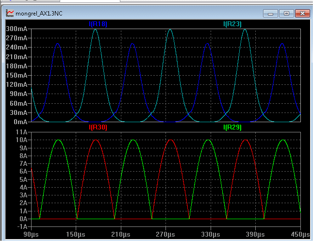

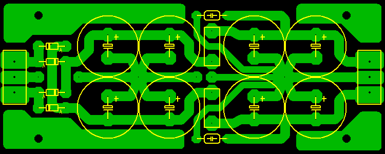

Next is the CRC higher voltage supply (below 1) that Danielwritesback thought I was going to power the Output stage with. 😀 It's star return will go to the center of the main PS's star. Real simple , but effective.
I simulated (haven't done that in a while - too busy with the real thing 😀) the worst case 2R load of a NJW21193/4 OPS. The driver currents would be no more than 600mA - both channels combined (below 2). So , 1.5A diodes and the 8 small caps in the HV supply board will be more than adequate. My added CRC will smooth the current pulses from the drivers enough to run the +/- cap multipliers. It may be noted that I AM running my drivers from the HV supply. This will allow my OPS to swing FULL rail to rail (+/-.6V) , clipping way before the drivers/voltage stages do.
Of course , the Voltage stage will have it own ground return to main star to avoid current pulses from any other source. These considerations may seen "Anal" , but it seems a few Japenese audio engineers agree. 😀
