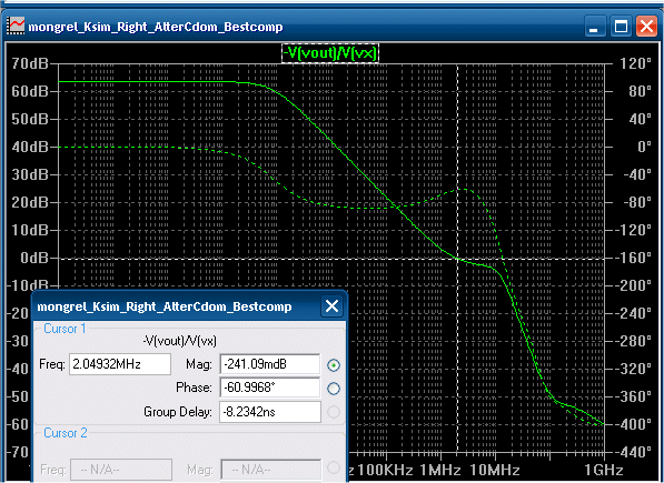

Hey , keen read post #485 ,#487 ,and #489. Here ... http://www.diyaudio.com/forums/solid-state/133306-frugalamp-os-49.html#post1691340
It is optimal for the phase to start at 0 dg , slope to a shelf of -90 / -100dg , and not dropping past that until after the unity gain point. Using these rules , I stabilized all the frugalamps and my present supersym (1 year old

Keen, read #474 ,then look at the example by mjl21193(post #487). I posted because I got strange results from your asc.
Try the new one , it is nearly optimal. (according to #474)

What expression for loop gain ?? I am into gaining anything.

There is a comment under all the simulator commands that contains the OLG trace, I should have indicated it somehow. Plot "-V(vout)/V(vx)".

I found your old mongrel.txt ... here is what I got (-61db)
why did you add 1khz to v5 ?
below is the loop gain plot I generated.
