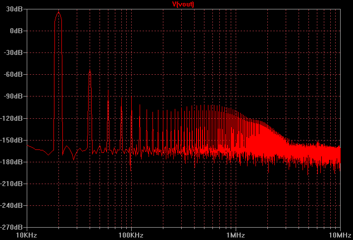

Homemodder, how do you like this? 60V pk-pk into 8 ohms, 68db GNFB. Perhaps with some more mods...
The output bias setting will largely factor in to the harmonic profile. I still don't know exactly how I should choose a bias setting. Slightly overbiasing decreases ultrasonic trash at the expense of H7 and co. "correct" biasing the way I figure it, decreases H7 and thereabouts at the expense of ultrasonics.
.step param Rbias 20 200 20 . If your Rbias is a 200R trimmer , for example. Replace the value of the trimmer with {Rbias}.
Simulation will create ten distortion residual reports in error log as well as 10 FFT's .
I was more uncertain about how one should pick the bias point WRT harmonic profile. But I think now that that should wait for listening tests.

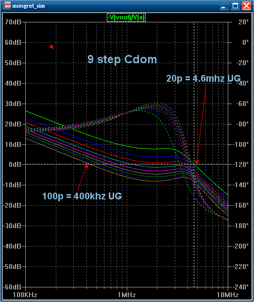

Exactly , with the step , short of having a multi -1K$ distortion analyzer .. you can at least come CLOSE to an OPS's "sweet spot". Take for instance the smaller NJW0281 vs. the big MJL21193 , the 0281 likes 40-50ma and the monster 21193 likes 70+ for lowest THD. This I have confirmed on the real thing.
What was nice was that I knew before I actually had the screwdriver on the trimmer. You can also step to find optimal compensation (.step param Cdom 20p 100p 10p). You have as a result a compound bode plot showing all possible slopes and phase relationships vs. dominant pole. (example below)
