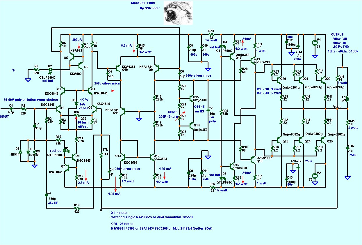

by Dr. EM - I certainly don't mind a more complex design if the parts go toward creating better performance
The design is only slightly more complex than my present one. The 2 transistor CCS's can be SMD dual devices (2n5550) or .08 cent ksc/a 1845/992 devices. The only important design criteria parts- wise is the KSC3503/KSA1381 VAS.
I will begin now to Tidy up the schema , use the new LT to generate a BOM , and make my boards.
And thank you , KEAN. When I finish , I might give you the boards in post #8 !
OS
Finalized the Schematic and generated a BOM .. very verbose. Board layout is next.
OS
That would be great!

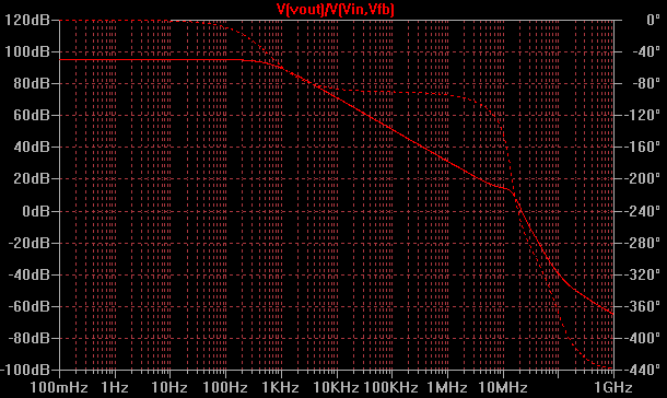

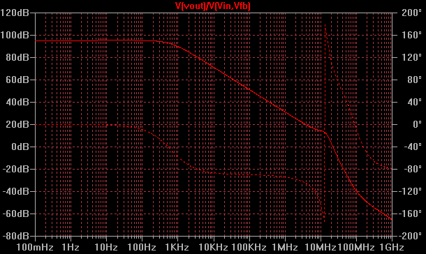

Look at these two OLG plots. They are of the same Mongrel, but with different plot settings. The one on the left has "unravel branch wrap" clicked. The one on the right is without. So your OLG phase actually comes around a full 360 degrees and lands at 101 in the right place. Interesting. I was simulating with the first graph, which explains why my compensation is always rather extreme... AARGH.

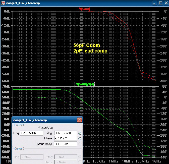

The thing that's confusing is why the circuit is so stable in transient analysis while the OLG phase margin is way out there.
Way out there ? Below (attachment 1)is typical of most amps on the forum (I have simulated them all).
here is a generalized bode plot of loop response ...
Another one..
90db below the "breakpoint" coincides with unity gain.
Here is a thread you should read.. http://www.diyaudio.com/forums/solid-state/133306-frugalamp-os-13.html ... Post 128 starts the lesson. post 139 and 145 concludes the lesson. Cdom , the LTP degen. resistance and any lead comp. will affect the final Bode plot.
BTW - the bode plot below shows a bit of overcompensation.

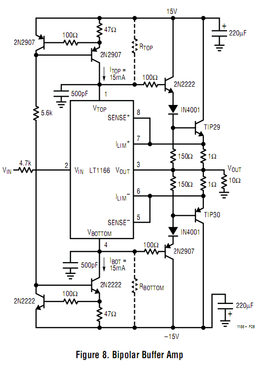

By bigun - Do I understand right - the outputs don't switch off ? And this thing sounds as good as a pure Class A amp ? - then this is great !
Let me clarify , this op stage exhibits non-switching tenancies to a much higher power level than a standard class B type 2 EF. All class B stages work in class A at low power levels , this one carries the effect to a higher level even without the feedback to the CCS's.
One note , this was done in simulation.
At 1/2 power the amp goes true B with full switchoff , but still with reduced Xover distortion (especially H5,7,9,11). With Keen's super low noise floor these higher order components are 125 - 140 db down! GONE 😀 I have used both the standard models from ON and Andy c.'s special ones , SAME RESULTS. All the other amp OPS's (EF2 ,triples) ,do not exhibit this behavior.
BTW , the krill's non- switching behavior also degrades with level/load. IF you want FULL non-switching get a couple of LT1166's (IC below) link: http://cds.linear.com/docs/Datasheet/lt1166.pdf
I might add this as an add-on to this amp , VERY easy to implement.

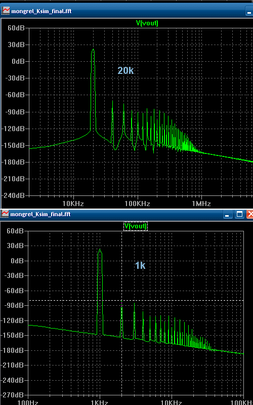

Os for us to be able to compare we need more detailed parameters than say, half power, give us a frequency too. Use say 20 volt swing at 20KHZ plz, I would just like to make a interesting comparison with a amp of mine. My amp displays lower THD than yours Im pretty sure using quite a few less active parts but what Im interested in is to see how the distortion figures compare but the ones of most interest is the ones from 7th onwards. The idea is to see how much the frontend influences these higher harmonics ie Im gonna be surprised if my amp displays lower distortion figures for 7th and up, although not for the THD. In my amp I just use a common triple in class ab biased at 60 ma. I cannot have so much complexity in a amp used in cars, so I rather design around very fast, very linear circuits, optimize the operating current of each active part and parts selection to get high performance.

Thanks Os thats perfect, It still seems to me that getting absolute low thd figures is the way to go. Ill show some plots and the output stage which is common but the input and vas I will cover sorry. I wont bother showing 1K plot figures they are just too small but i can include a 50khz or 100 khz plot to show what the circuit is capable of.
