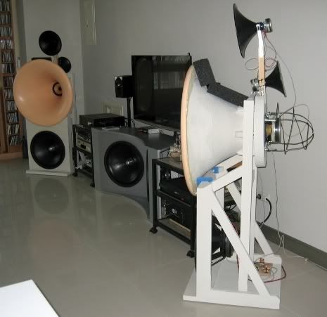

Yesterday I tried adding rear-firing tweeters and making the midhorns open back. (a very crude set-up just for a trial )
(the 'cage' behind the midhorn was for holding the felt pads etc... )
The rear wave of the midhorn is several dB down compared to the front, so I also brought down the rear-firing tweeters a little. Quite natural and relatively fullrange sound is now available at the back of speakers.
The 'environments' of the back of both channels are quite different, left is a corner and right is flat wall. (and I can't do much about that🙁 ) However after re-adjusting the EQ to make them reasonably flat, they sounded pretty good.
The asymmetry of the rear reflections seemed not a problem actually, I didn't hear any real "asymmetric sounds". From the main seating area, the images seemed enlarged somewhat but not fuzzy or smeared. And the sounds are indeed very stable and natural everywhere in the room. (I though it was already very stable and natural in a quite large area, but not comparable with this! )
Previously I got obvious vertial lobing issue becuase as you can see the huge distance between mid and high. Sounds heard (and measured) from seated and standing position are quite different. I can't explain this properly, but the rear tweeter seems help a lot in filling the hole. Now the mid and high are merged much better. And yes! disconnecting the rear tweeter makes the sound muffled right away.
Overall, I like what I hear very much. I'll keep it this way for longer evaluation. Thanks a lot, guys😀
That's really cool this worked out for you! I'm glad to hear it! The audio journey never ends...
Interesting looking setup, BTW. What are the XO points?

Thanks for the kind words. The xover points are 200 & 3kHz or so... They are shallow 6dB/oct. in electrics, while I can't measure the real acoustical ones.
