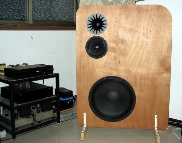

I've (also) played with some OB speakers. One of them had an 8" midrange (modified from a fullranger) + 8" plastic horn for HF and a 18" woofer:
(some more close-ups were posted here:
http://www.diyaudio.com/forums/showpost.php?p=1690331&postcount=32 )
This system had a very good tonal balance and very wide coverage (thanks to the HF waveguide). I could hear the sounds very clearly from 'the other' channel when standing just in front of 'this side'. The tonal balance, sound field and images were very stable across a wide area -- wider than the seating area. Overall this speaker had a very pleasing sound.
But of course it's not perfect (for me). I missed the dynamics, weight, and clarity of my previous big midhorns. I couldn't bring them back at that time (space limitation), so I used a bigger and much louder midrange instead. (The previously mentioned 8" mid was the bottle neck of the system, which had the lowest effeciency in the system.)
Here it is:
http://www.diyaudio.com/forums/showpost.php?p=1729031&postcount=515
(just cut a bigger hole on the previous baffle and stuffed in a modified 12" guitar driver)
A 12" mid (for home use) is somewhat outrageous, let alone an inherently distorting 'guitar driver', but I did like it very much (after the mods), more so than the previous 8 incher. Of course it's not perfect, either. Still ragged response, beaming... etc. you name it. The overall coverage of this system was not so consistent as the previous one. But even so, the sound field and imaging quality were actually still reasonable and acceptable, just within a smaller area. That's fine with me, because I don't need a perfect sound everywhere when I'm not in the main seating area.
On the other hand, the big midrange had its strong point very obvious. The adventage in dynamics were not only in loud passages, but also in the quiet. This makes the music more focused and touchable. I don't have to pay attentions, the details in the sounds grab me positively. By comparison, I had to grab the little sounds myself from the previous 8"er, they didn't come to me. Oh, I mean the quality of sounds, not the fore/aft of images. (English is not my native language, I hope you can understand me.)
When a proper toe in angle is applied, narrower directivity actually helps! When not in the center, you can hear more sound from the far side and less from the near, thus center images and the whole sound field are stable, also the tonal balance.
So, why wide directivity is needed? It's not good for off-center listening positions and unnecessary at the sweet spot. As to those not-beaming small drivers, oh well, ok, I'm bias against them.
As above, 12" midrange is somewhat outrageous and indeed bad directivity in its upper range. 8" would be a very good size as a whole. Smaller than 6.5", I'd guess the lost would be bigger than the gain, especially in an OB.
And no, I'm not a SPL guy. I listen very quietly, usually in conversation level only.
Just my 2c.
