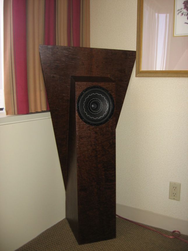

Back in 2008 I heard these in Montreal. A clever up firing corner horn with an 8" fullrange. Certainly keeps them out of the way and the footprint small. They worked well and had good body, except that the room was too wide for a tight center image. I don't remember how they were built on the inside.
I wonder what driver that is? And who did the well done EnABL job? (i couldn’t find any pictures in iPhoto). The horn does strike a note of familiarity… a sketched drawing, not a picture.
