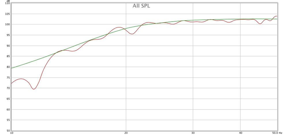

That is the beauty of DIY speakers they can be built and designed to work in the room that you have and with even directivity and the right measurements can be equalized to your preferred target in room.
This is an in room average measurement after processing. The Green line is my target response. 10 to 50Hz no smoothing applied.

I understand a corner line array reduces reflections to a minimum, is this your primary reason for using one? The convenience of putting them in a corner and the small footprint is appealing. I mean, if you could have any speaker type is this set up what you'd choose?
It is RA7's that are in a corner, mine are free standing. For my usage case these are about as good as I could have hoped for as far as compromises go I can live with the ones these have 🙂

Mine are currently 1.3m from the side walls and 0.5m from the front wall and have a decent amount of EQ to get the graph shown above.
how much processing is used?
