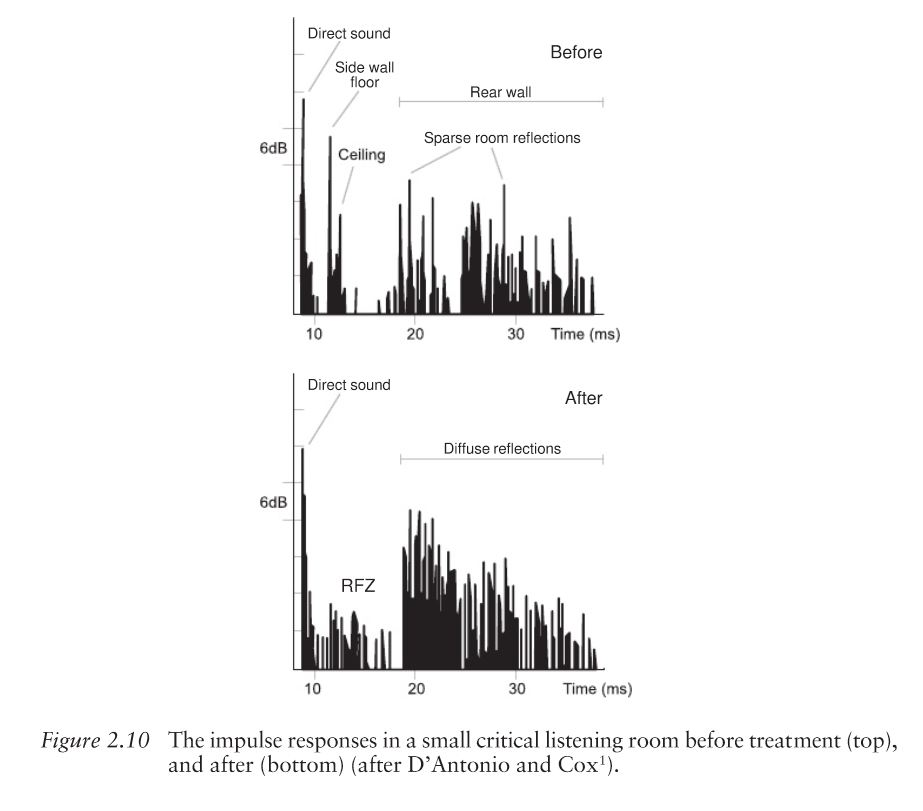

Reflections can have a very seductive quality. Keeping the first ~6 ms clear will allow us to get a good grip on the vocal parts in the recording.
The Haas limit (where reflections get lumped in with the direct sound and experienced as one event) is even longer, though it is somewhat dependent on frequency and the longer time frame will still work for sounds below ~3.5 KHz.
In a Studio Haas Kickers have been popular quite a while ago. Over time they were mostly abandoned as a studio concept, some say because everything started to sound a little better. Those Haas kickers came in somewhere between 15 and 25 ms. Diffused in nature and arriving laterally they can actually add something positive for perception and imaging.
An example of the Haas kicker:
attachment.php
(bottom picture) also known as ISD termination.
The first ~15 to 25 ms having a clear lower level of reflections is most commonly known as a reflection free zone.
For the pleasure of listening at home, having those later (but still early arriving somewhere between 15 to 25 ms) reflections can be a very persuasive thing to have. At least I am not bothered by everything sounding a little better and use extra speakers, making sure they are diffused in nature, as a virtual Haas kicker.
Even later arriving reflections outside of the Haas limit can still add something to our perception. This is described as giving a sense of envelopment, something you'd find in good quality venues. Much lower in level and arriving as late as 150 ms after the main wave front they will be perceived as separate by our brain.
David Griesinger has a lot of info on that subject on his website and scattered around the web.

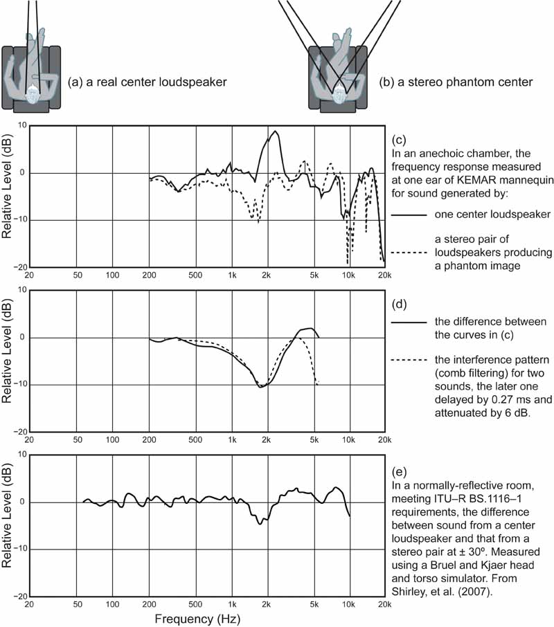

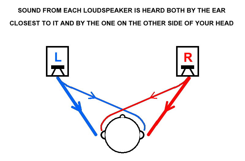

Relative early reflections, somewhere between 6 ms and 15 ms might actually have a positive effect for Stereo in the phantom center, enhancing the intelligibility according to the writings of Floyd Toole. They are said to fill in the dips of the stereo cross talk (left speaker canceling direct sound at the right ear and vice versa). Something (the cross talk) that becomes more obvious if we remove/reduce all early reflections.
attachment.php
Stereo cross talk
A measurement by Floyd Toole showing the effects of Stereo cross talk in a normally reflective room and compared to anechoic conditions:
attachment.php
The top graph shows the difference of running an actual center speaker compared to a phantom center as created by stereo. The bottom graph is showing the slight reduction of the dips as seen in the top anechoic measurement due to room reflections filling in those dips in our stereo environment.
Most papers I've read agree that the very early reflections (below about 6 ms) should best be avoided or at least be minimized to get the most out of stereo. Whether that should stop anyone from placing speakers closer to boundaries because they enjoy it that way remains an entirely free choice.

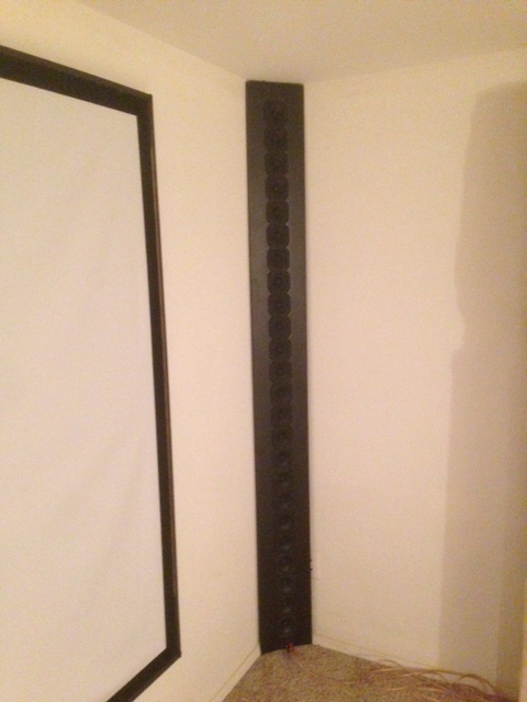

I think I shall be the winner of this challenge. Muhahahaha!
521404d1451195824-corner-floor-ceiling-line-array-using-vifa-tc9-img_1797-jpg
Read more here: Corner Floor-to-Ceiling Line Array Using Vifa TC9
The face width is only 6 inches. It's an equilateral triangle.
I had some audio friends over yesterday. Couple of them are reviewers for 6Moons and Positive Feedback. They were quite impressed and I got comments like, "With this setup, you can basically tell Stereophile to go **** themselves!" This was the first time other audiophiles heard the system, so, I'm glad they liked it.
