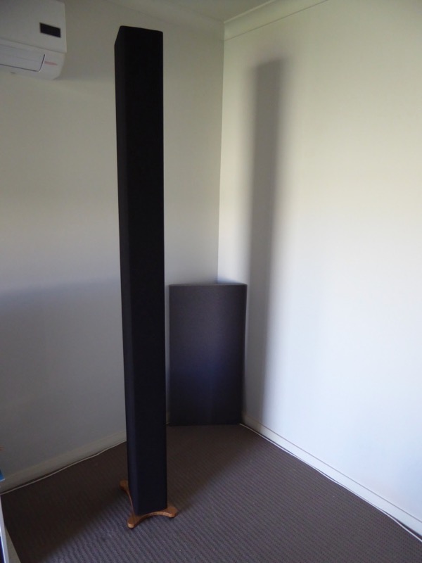

Jon, open baffle should be 4-5 ft away from wall. I see no point in making it ob, if you intend close wall placement. Sure its not going to explode, it just makes no sense. Otherwise i does not matter to me.
Wesayso and fluid win this one.

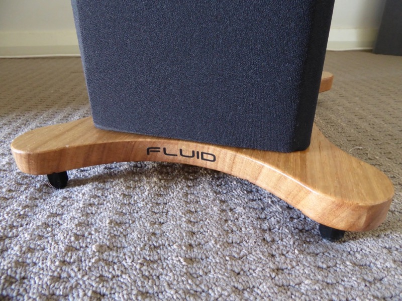

Mine is smaller which may or may not be a good thing for stability. The base is 245mm (W) by 315mm (D)
