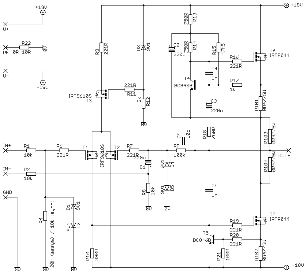

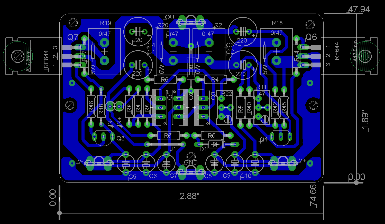

Oh, and praise and admiration will come upon you as soon as you find a purpose for C4 (sitting there, looking good) and provide a flawless implementation for this very use without moving that cap even the slightest bit. 😛
While you're at it, the traces between pins three of both output devices and their corresponding power resistors are still thin. 🙄
I guess you don't want to see the version with the bias trimpot then?

Hi , OK, I'll fatten up the traces... I also thought about paralleling those caps, that IS what you meant?, but not sure how the increased capacitance there will affect the circuit.
I have enough parts for a prototype, but I forgot to get the zener... I was wondering if I could just connect a 5V regulated supply there were D1 and R7 would meet on the schematic, to test things, otherwise I need to wait for RS to deliver, they actualy dropped my ztx450 next day, on Thursday, 75km away, 5 tiny transistors in almost a shoebox.... very bad mkaaaay.
It's not what I meant, but it's not the worst of ideas. But only if you make both C1 and C4 470uF and wire them anti-parallel (so as to form a bipolar capacitor of 235~220uF).
What I was actually wondering: have you really not once considered to leave it out?
Good point, what schematic actually? I'm afraid I lost track of the actual circuit you refer to. We've seen a couple throughout this thread.

Yeah, about the caps, with just a hole there, it looks ugly, but its totaly up to the assembler to put it in, or not... I do not like antiparallel electrolytics at all, based on some experiments I did over the years.
But, even if I had no problem with it, it would realy mess up the top of the boards, especialy if I try to keep the orientation of the caps the same to reduce problems for builders. There is just no place for the traces left.
Aaah, me too! I screwed up there and got the term (foreign language...) wrong, sorry. I meant to say in series, back to back.
In your last layout mod you actually made room for that idea all by yourself by moving the high current trace above that cap. From over here I don't see how any component would have to be moved or rotated at all.

It's just that once you consider differential input, input protection, HF feedback, etc., you easily end up using nearly as many parts as an actual Aleph... 😉
The 5V point I was refering to was where R11, R12 and the zener meets on your schematic.
That zener drops a portion of the supply voltage and forms a voltage reference together with it's series resistor (current limiter, to ground). This drives the mosfet gate accordingly.
If any, you could try supplying the respective voltage difference (depending on your planned supply voltage) to that node.

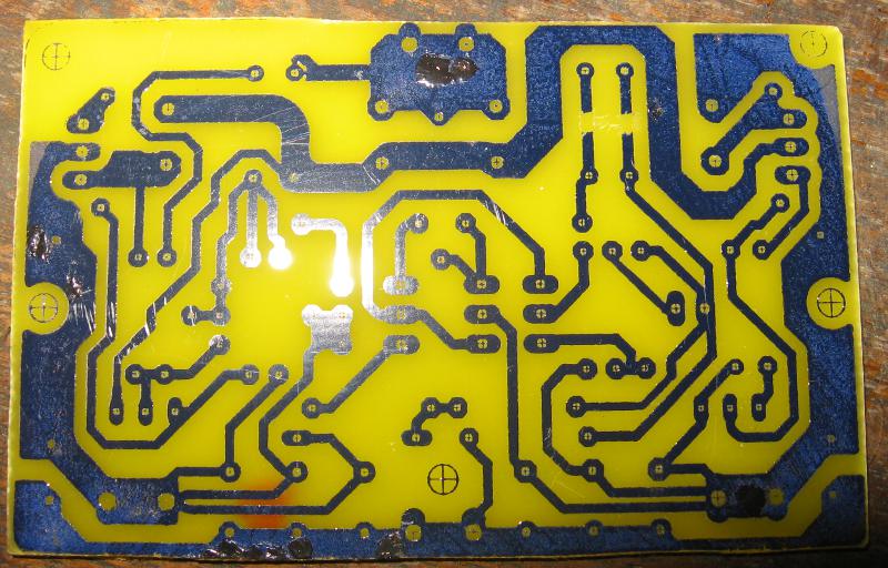

I agree on just about everything I think, except the capacitor, I would need to rotate one as far as I can see, so it will be diffirent from the other 3...
The printed press and peel is allready infront of me, I'm just busy makeing a small stand thingy for my new scope and signal generator 😀
I might as well throw the pcb through the tablesaw so long as i want to start on that tonight. including the erroneously parallel connected caps 😛 (i'll jut cut the trace and pretend its not there).
I ordered the transformer so long, not sure if it is localy stocked or ex UK, I do have a 50VA 12VAC EI core around here somewhere I can use to test basic functionality on one channel so long, untill the big boy pitches up, a nice fat 225VA jobby.

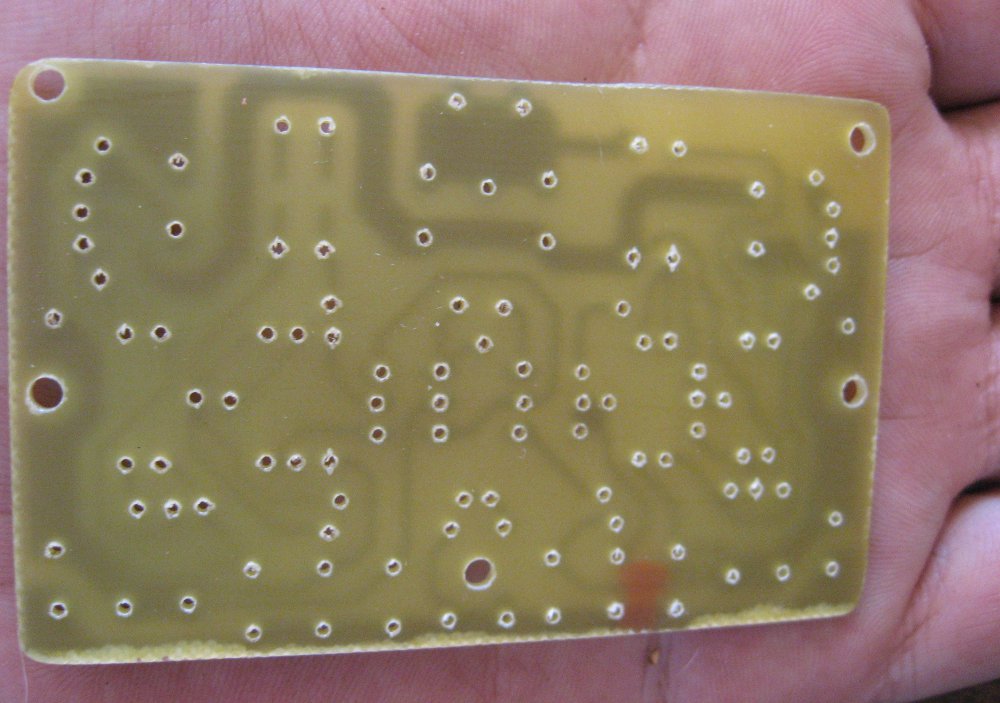

Ok, ready for etching. Oh yeah, gotta cut those traces still..
And use some permanent marker on the thin and fuzzy spots. 😉

Lol I have something even better than a marker, my wife's nail polish!!!!
Definately going to make the bottom trace fatter as I made provision for adding axial caps for decouping the output pairs.

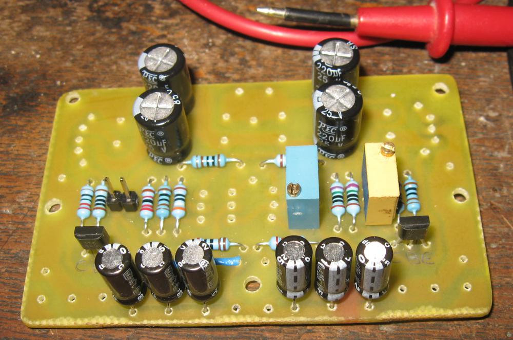

Buggers didn't pack my power resistors, and I still need to figure out some kind of jig to match the fets for the front, I only have 10, hope I can get 2 reasonable sets out.
Also have to find my 1.5mm drillbit for the spades' holes.
And then waiting on the rest of the parts like the transformer etc, and working on the PSU's so long.
Heh, I was caught out a little with the power resistors, the size is correct, but I didn't notice the pins are a little offcentre.
I could manage to fit them all, but spaceing is a bit off from the innitial plan, so I will need to update that eagle package to make it perfect.

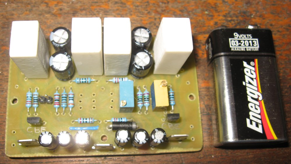

yeah, its not a total dealbreaker, it can be made to work, like I did by just rotaing them till they all fit., thing is if I adapt them to the offcentre package, then that means everybody would have to get the Tyco ones that are offcentered.
If they perform the way I intend for them to work, i.e. stay pretty cool, then its perfect. A cursory overview says it they will see about 1W dissipation, but I used a 5W package.
I always make prototypes before sending stuff to the factory.
Now it just needs a 2 resitors, the FETs, which someone said they would help me with a plan for a jig to match, and the PSU.
