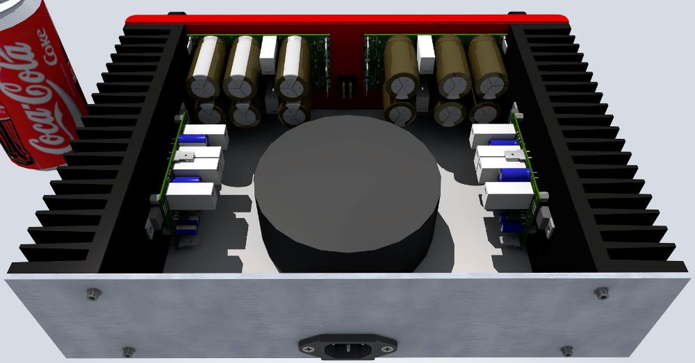

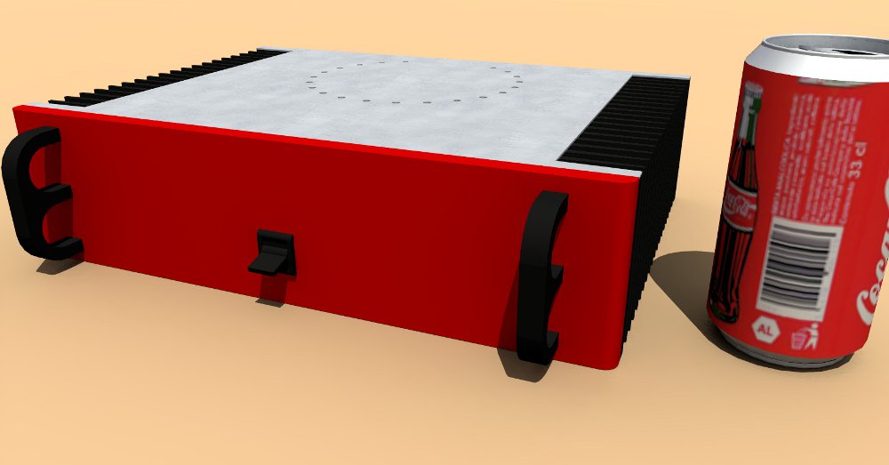

Same heatink, but the 0.8C/W 75mm high version. Cost is not all that much more, of coarse buying two transformers bites.
The case itself was streched a little and is now 300mm wide externaly. (220 internal).
Dissipation figures were as pointed out, 0.6x60=36C above ambient (in a perfect world).
Now it will be 0.8x30=24C above ambient (""""")
Plus it looks way sexy, and I have 'n even realy started playing with the looks and indicators yet, appart from choosing handles (pretty expensive little buggers, but they are realy cute, the top half is actualy cut in little teeth for grip, like a gear.

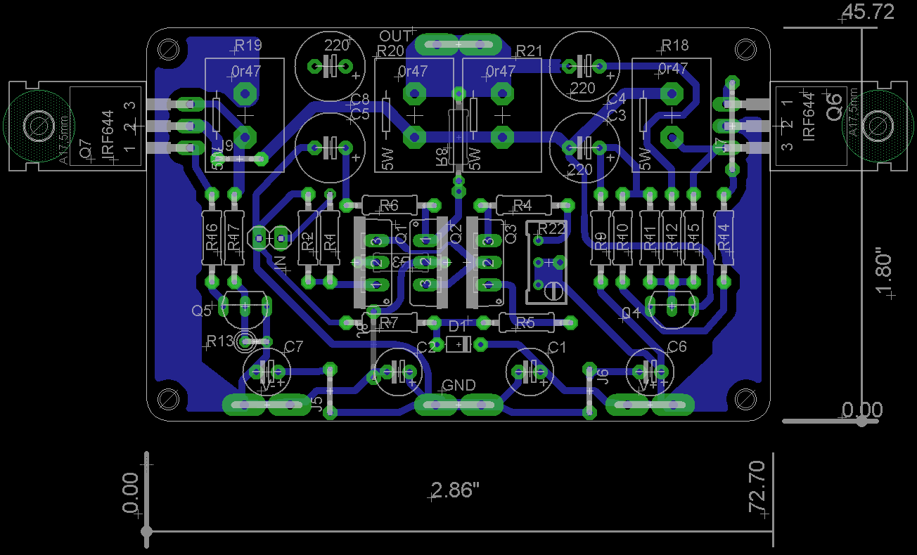

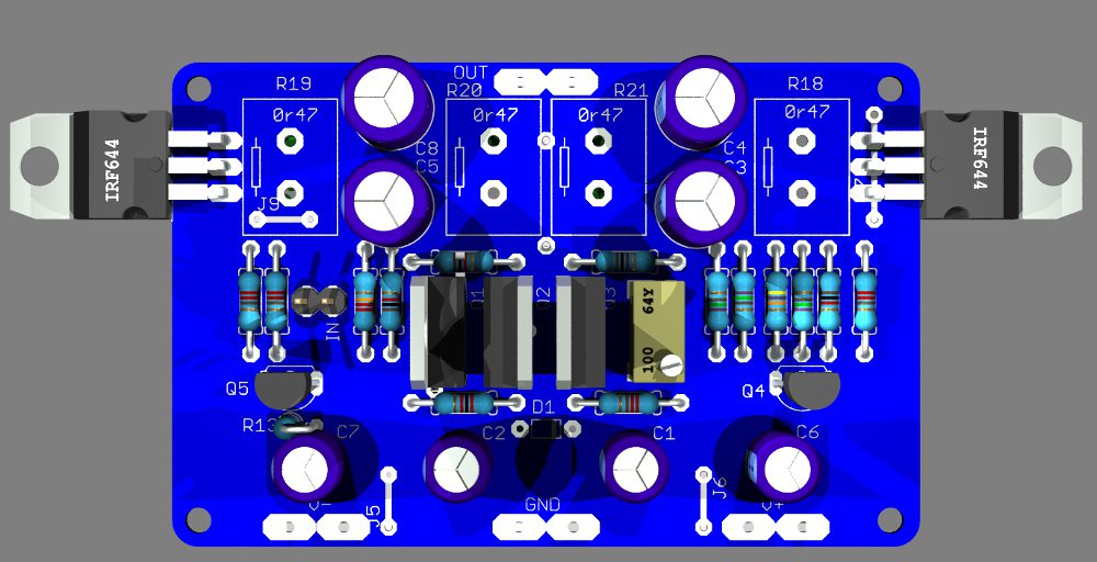

Hey there, I was a little bored this weekend, so I reworked the PCB for through hole components, also got it all single sided with 5 short wire jumpers, feeling just a little bit proud as it came in even smaller than my SMD version.... Will make the PCB's tommorrow, but have to wait for FETs ex UK.

I don't think it would be right selling work that is not my own, appart from the layout.... First boards will just be iron on transfers as testing prototypes, but when I consider how much money goes into PSU and case, I am feeling quite strongly to have some boards made at my local fab house, they do good work, cheaper than asian counterparts, but is a hassle to deal with in that it is a micro business, and they offer less options like fancy colours and gold plateing, (they do do sterling silver though). Costs would be a little south from the previous indication, due to it now being single sided, allthough it would need silkscreen on both sides as there is a resistor underneath.... I reccon there is enough space to pop it onto the top now... just too lazy tonight.

THe boards are your own, the layout is not, you are allowed to do that, if you ask nelson for permission.
However the propose to this, would be to get people mini a boards and put $$ back into diyaudio.com funds.
Asking nelson first will most likly get you a yes, doing behind his back pisses him and other's off 🙂
j
Yeah, don't worry mate I'll sort it all out with grandpa Nelson, as soon as the units are tested I'll let you know.
