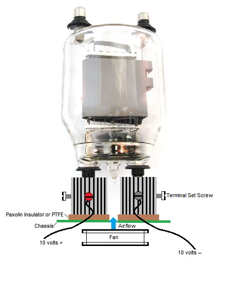

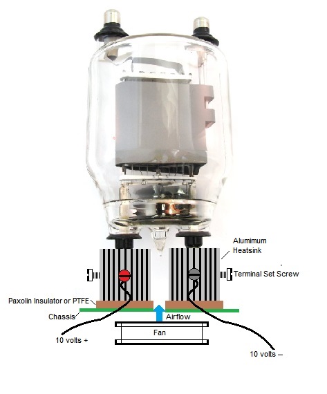

Magz,
attached is a drawing showing the Heat Sinks for the 833...I hope this explains it and gives you food for thought
The only problem with that is that the pins that need the cooling are on the top of the tube, especially the anode pin. I suppose the tube could be flipped over, though...
I have two big 8-finned machined aluminum heat dissipating top caps for each tube. The fan goes under the tube as you show it, and the tube is surrounded with a pyrex glass chimney, leaving about 0.4" air space all around the tube, through which the air from the fan will flow upward around the tube and the caps. That ought to do it; the 833C doesn't require fan cooling below 300W plate dissipation, and I'm only running it at 330W or so.

Hi Magz, understand that you need to cool the Plate and grid terminals...if you are using a Chimney then surely you will need to use a dedicated Blower and not a Fan...I can not see how a fan is going to blow enough air into the Chimney...If you must use a fan then you will be better of doing away with the Chimney altogether.....if you can get hold of a copy of any of the 1940 to 1960 ARRL Handbook it will give you all the information you need on Tube cooling

Well, I called it a chimney but in reality it's really just a straight glass cylinder around the tube, not pinched off at the top in any way, so there shouldn't be much pressure buildup. The idea is to protect against touching the high voltage and to provide some direction to the air flow from the fan to maximize the amount that flows past the top caps, rather than out into the room.
I was planning to flip the tube when I was thinking of making one. I had another reason in mind. I wanted to keep all the deadly electricity inside the box. That way everything above the deck is at low voltage levels.
I read a lot about these tubes, and yes, the plate seal is the one that fails, and I did find a dead tube that had failed in this manner. I read that some users inverted their tubes, and I read somewhere else that inverted tubes had another problem, but I can't remember what it was now.

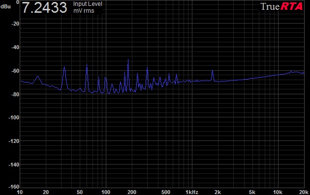

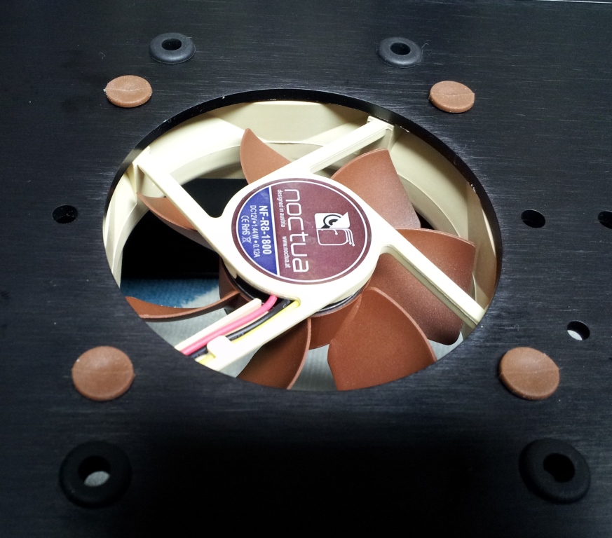

I received the Noctua NF-R8 fan today and installed it using the soft mounts supplied with it (picture 1).

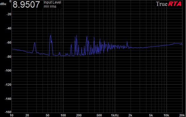

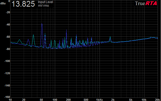

Compared to the Sunon fan, the Noctua is MUCH quieter, both audibly and electrically.
Audible Noise: At 7V, the Sunon noise is acceptable, but the Noctua is silent. In fact, I was able to turn the Noctua all the way up to 12V (31cfm) and leave it there, and it was still barely audible from a foot or so away. Since the tube/fan assembly will be surrounded by a 3/16" thick glass cylinder, I don't think noise will be an issue.
Electrical Noise: The Noctua is also much less noisy electrically than the Sunon. The Noctua at 7V unshielded is actually less noisy than the Sunon at 7V with TI-Shield between it and the probe! Picture 2 is the Noctua unshielded at 7V, Picture 3 is the Noctua unshielded at 12V, and Picture 4 is an overlay of the Sunon and the Noctua both unshielded at 7V.
Unfortunately, the Noctua is only available in their signature tan and brown color scheme, which I guess I will come to tolerate given its performance. I can always get little black screw head covers for the exposed flexible mounts.
The pitch of the Noctua blades is noticeably different from that of the Sunon, and it does seem to move air with less pressure than the Sunon, but it is so much quieter that I can afford to turn it up higher to make up for that.

Noctua Fan
Hi Magz,
Pleased that you have now got a quiet fan...and on behalf of everyone on here thank you for all the research you have done on this subject...I am sure that we will all be buying Noctua fans should we have a need for one. In addition to all of this this forum has given me the inspiration to revisit my abandoned 833 project of a few years back. I have thought about resuscitating it but this time I will be using a different Tube....I quite like the idea of going for broke and using the RCA 851...this is a real beast of a tube but the specs look good.
