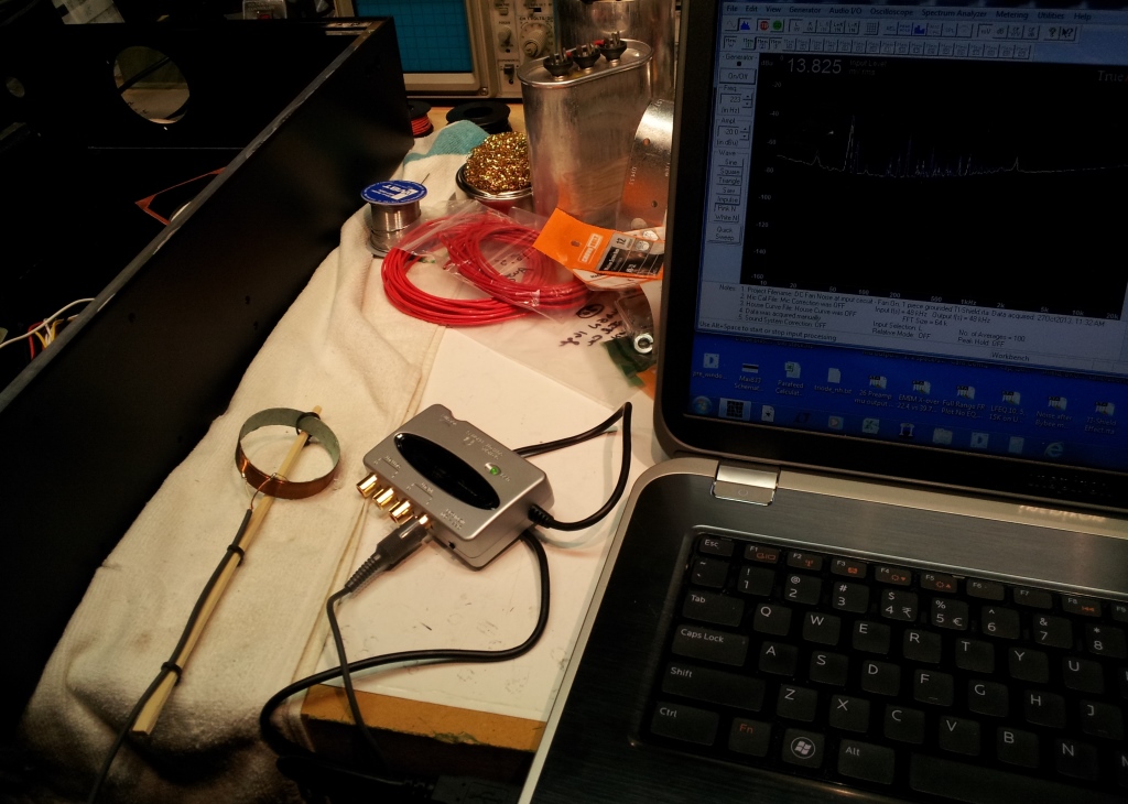

I was curious as to how much electrical noise the DC Brushless Fan emitted, so I built an EMI probe from an old speaker voice coil, a chop stick, my PC with True RTA and a USB interface box. See picture #1.
I tested the probe by holding it near my Variac and the fluorescent lights, and yup, it showed LOTS of noise, which decreased rapidly as I moved it away...good.

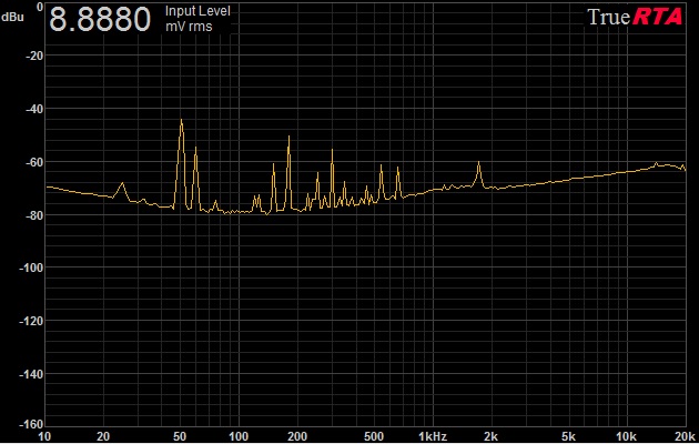

Then I put the probe at approximately the position of the amp input circuit and measured the EMI with the fan OFF and then turned ON. Pictures 2 and 3 tell the story - there is quite a bit of noise emitted by the fan, and it does reach the input circuit. Uh-oh. I thought that since only the side of the fan was facing the inputs there might not be an issue; looks like I was wrong about that, there's actually more emission from the sides then from the front or back of the fan.

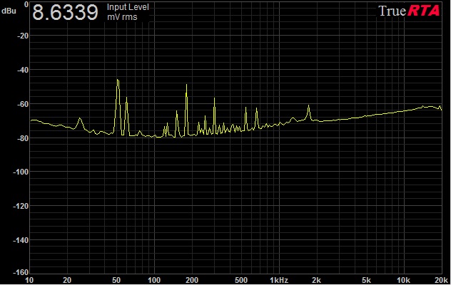

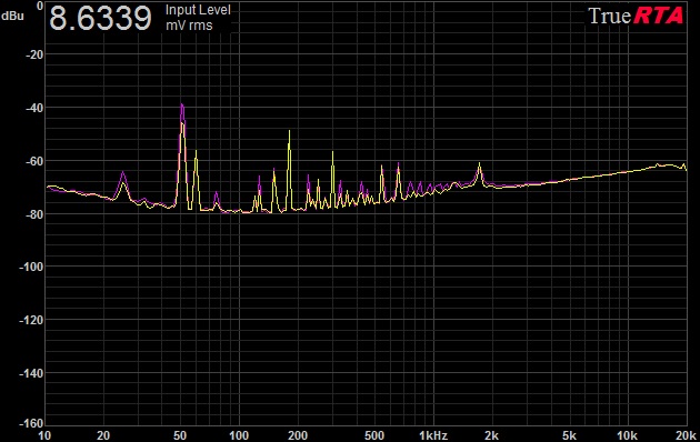

So I then placed a piece of TI-Shield (grounded to chassis) between the fan and the probe, and it did help decrease the noise significantly - Pictures 4 and 5 show the noise with the shield and an overlay of the noise with and without the shield.

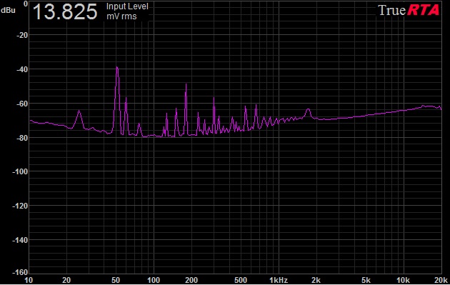

One other possibility is to put the fan on TOP of the lid instead of under it. That would move it further from the vicinty of the input circuits, put the lid in between as another shield, and probably also decrease the mechanical noise resonating in the box. It would be near the 6E5P, but that's easy to shield using a tube shield. I'll have to look into that...after football, of course.
OK, so I tried it with the fan on top of the box and, indeed, it does decrease the noise in the area of the input circuits, about as much as adding the TI-Shield did when the fan was inside the box. See Picture.
So if I put the fan on top of the box and wrap it in TI-Shield and shield the 6E5P I should be able to lower the likelihood of noise pickup substantially.

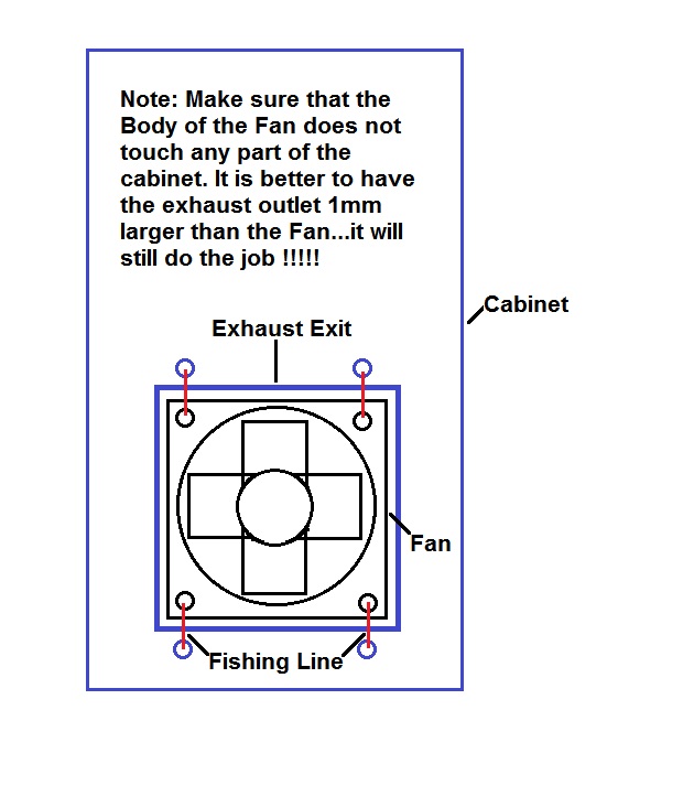

You have two things that are going to generate noise,one is much more intrusive than the other...a low noise fan is not the issue really and anything up to 28 db is bearable...the real culprit is the way the Fan is mounted and the acoustic coupling as a consequence of it.......the only way to limit this is to mount the Fan in such a way that it has minimal contact with anything else in particular metal cabinets or the chassis...as these will surely resonate.......the best way to mount the Fan is on Fishing Line strung at each corner and then tied to the cabinet...this will provide the bear minimum of physical contact....I have tried this a number of times in the past and found it to very effective.
