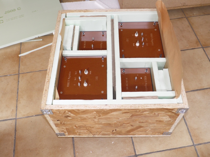

The OPTs and HV chokes are crated and ready to ship from Belgium to New Jersey. See picture.
The crate weighs 92kg!! I'll be picking it up in person at the airport cargo area, guess I need to bring a friend or two.

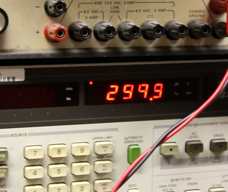

It's been a while due to life's little interruptions, but I am finally back to playing with electricity again. I saw my 8903A hit 299.9 watts a couple of days ago....and this was from a single pair of sweep tubes. As the Mythbusters used to say....It's safe to assume that something's going to go boom!

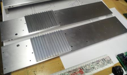

Just a snapshot of the mirror-imaged drilled side panels for the left and right amp. The larger hole is for the RCA jack. I have low profile aluminum heat sinks on each where the Mosfets will attach to the chassis, to help with the heat dissipation (40+ watts from the one in the 833 cathode and another 6 from the one in the gyrator).
I tried to hang as much of the heavy stuff on the extruded aluminum sides as I could in order to reduce somewhat the weight that the top plate has to carry (still a LOT). I still need to do the other sides of each box and once I get the other parts back from FPE, they will go off to Landfall Systems for anodizing.
By the way, if you haven't found Heatsinkusa on the web yet, they are AWESOME! They have a wide variety of aluminum heatsinks, they will cut the lengths and widths exactly to your specs, they ship within a day, and their prices are very reasonable. That's where I got those low profile sinks from.

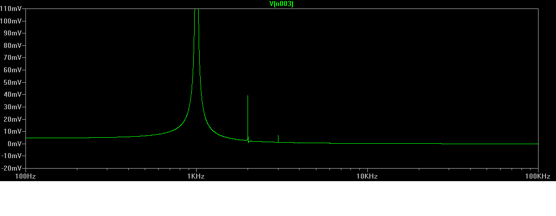

I was playing around with LTSpice FFT functions today, and found some interesting things regarding the harmonic spectrum in class A1 versus class A2. Thought you all might be interested.
As I've mentioned earlier in this thread, running the B+ at 2300V lets me keep the amp in A1 up to 40W output or so, before any grid current starts flowing in the 833. The first picture below is the distortion spectrum at 38W output into 4 ohms. As you can see, distortion is predominantly second harmonic, with the 2H at .45%. Below this level, the spectrum is consistently 2H dominant.

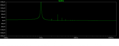

Once the amp goes into A2, however, the distortion spectrum changes, with much less 2H and more 3H. The second picture is the spectrum at 84W output into 4 ohms. Distortion is now predominantly 3H, with the 3H at .76%. This is what was seen in all analyses I ran with the amp in A2.
Anecdotally, I've read reports that A2 sounds a little edgier and a little brighter than A1, and those FFT results seem to reinforce that. In any case, most listening will be in A1, except for crescendos and perhaps drunken volume cranking...
Note: in order to get consistent, believable results from this LTSpice analysis, I had to disable all compression, force double precision math, and set max timestep to 1uS. Otherwise, there's a lot of hash and false peaks along the baseline.
