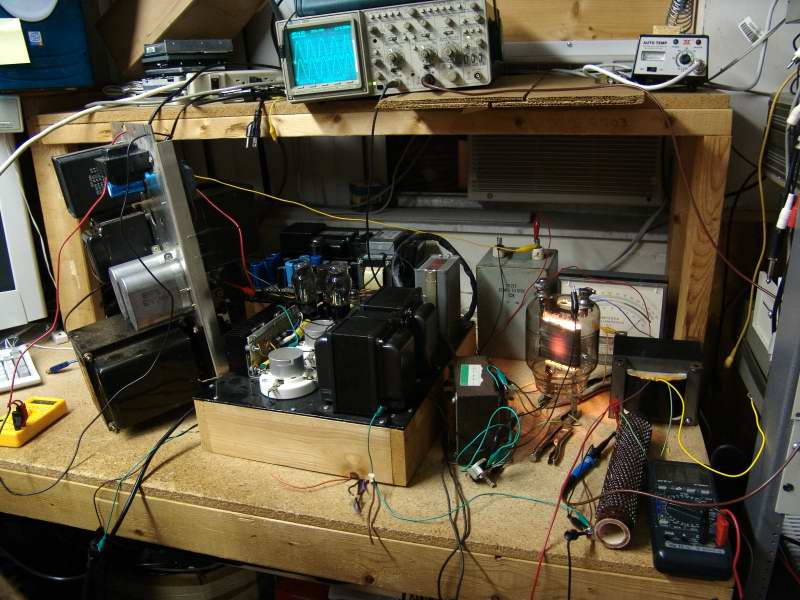

I had 24 tubes that were pulled from broadcast transmitters at routine service intervals. I rigged up a little test amp to test the tubes and a possible OPT for an 833A amp. It put out about 200 watts of audio.
Of the 24 tubes a few were physically damaged (broken glass). One had a visible crack, yet the tube still held vacuum and powered up. I was afraid to run it hard for fear that it would violently shatter. There was another tube with a hole burned into one side of the plate. The glass was darkened from deposited metal. It still made 50 watts or so but distorted a bit. The rest worked good.
Picture of test amp.....note the "tube socket" made with hose clamps and vice grips! Do not try this at home kids....we are trained professionals. 🙂
