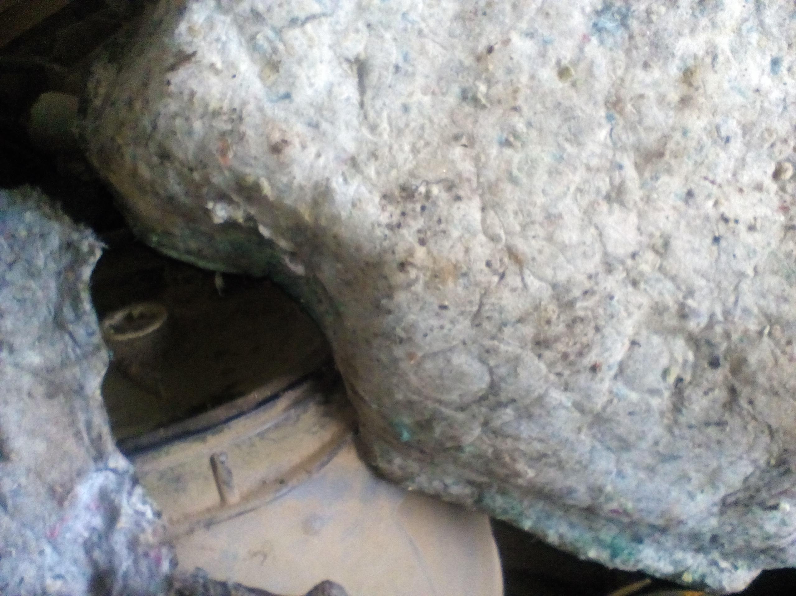

I checked the underlay in the audi but it did not seem to be suitable, was yellow foam fused with the carpet.
I pulled this underlay from a mk4 vw golf, from the driver and passenger footwells. looks like 1/2 inch wool felt, with occasional small lumps of foam in the felt. is this suitable for the purpose, and is pva wood glue suitable to attach it to the plywood. do i need to put felt on the bottom rectangle of the metronome? i see no mention of it.

Not going to try to blow through it tonight, i washed the surface mould off it with a tap so it will take a while to dry out. If i was to guess at effort it would be possible to blow through but at great difficulty. it's like any tightly matted felt.

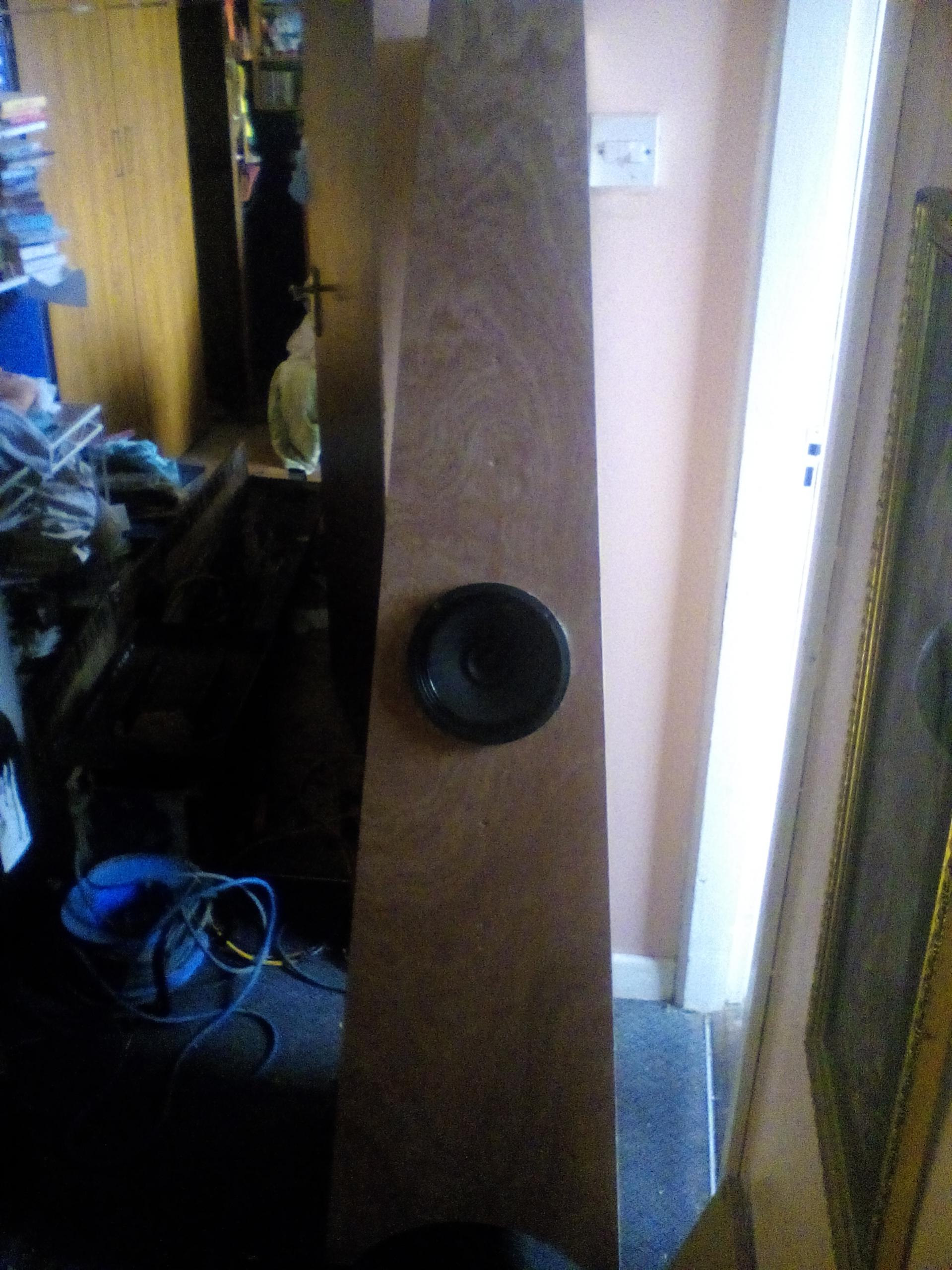

The carpenter almost completed one cabinet today, but made a mistake on the small end which is 4x4" when it should be 4x5.5"
He cut the bass port on a lathe. I am impressed by the appearance and will follow his suggestion of comparing the audio of the corrected next cabinet with the original to see if the flawed dimension will matter.
He fitted a loudspeaker brace as requested, but did not anchor it to the back, leaving room for the felt on the back panel solely. i suspect this may not be ideal, but better than nothing.
I had to collect more felt from a local mechanic to complete the second cab. it was waterlogged so i have it drying on a radiator.
this picture is of the faulty metronome. the top square is actually 5.5x5.5 inches not 4x4 as stated earlier.
I have installed drivers in both just now and am using them.
the mass loading is different to listen to, like when you get into a car and slam the door and your ears pop. perhaps i will get used to it. I used duct tape as a gasket for the drivers.
