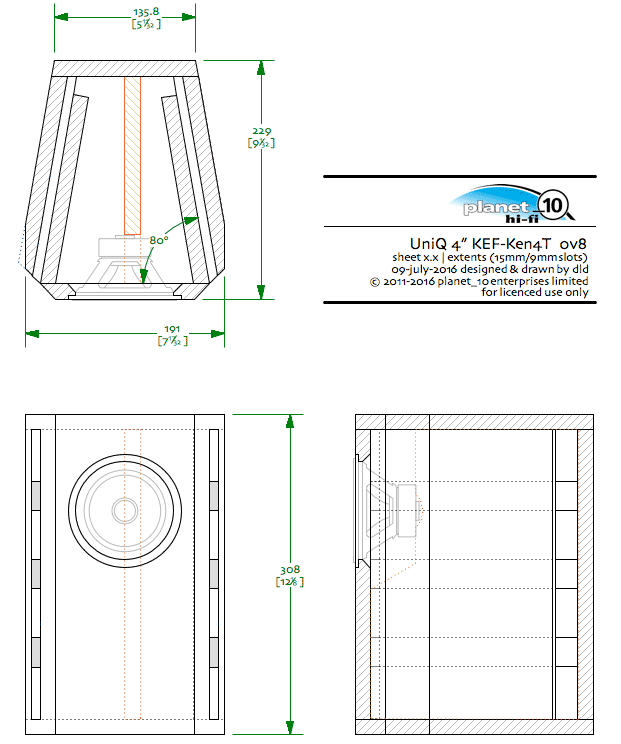

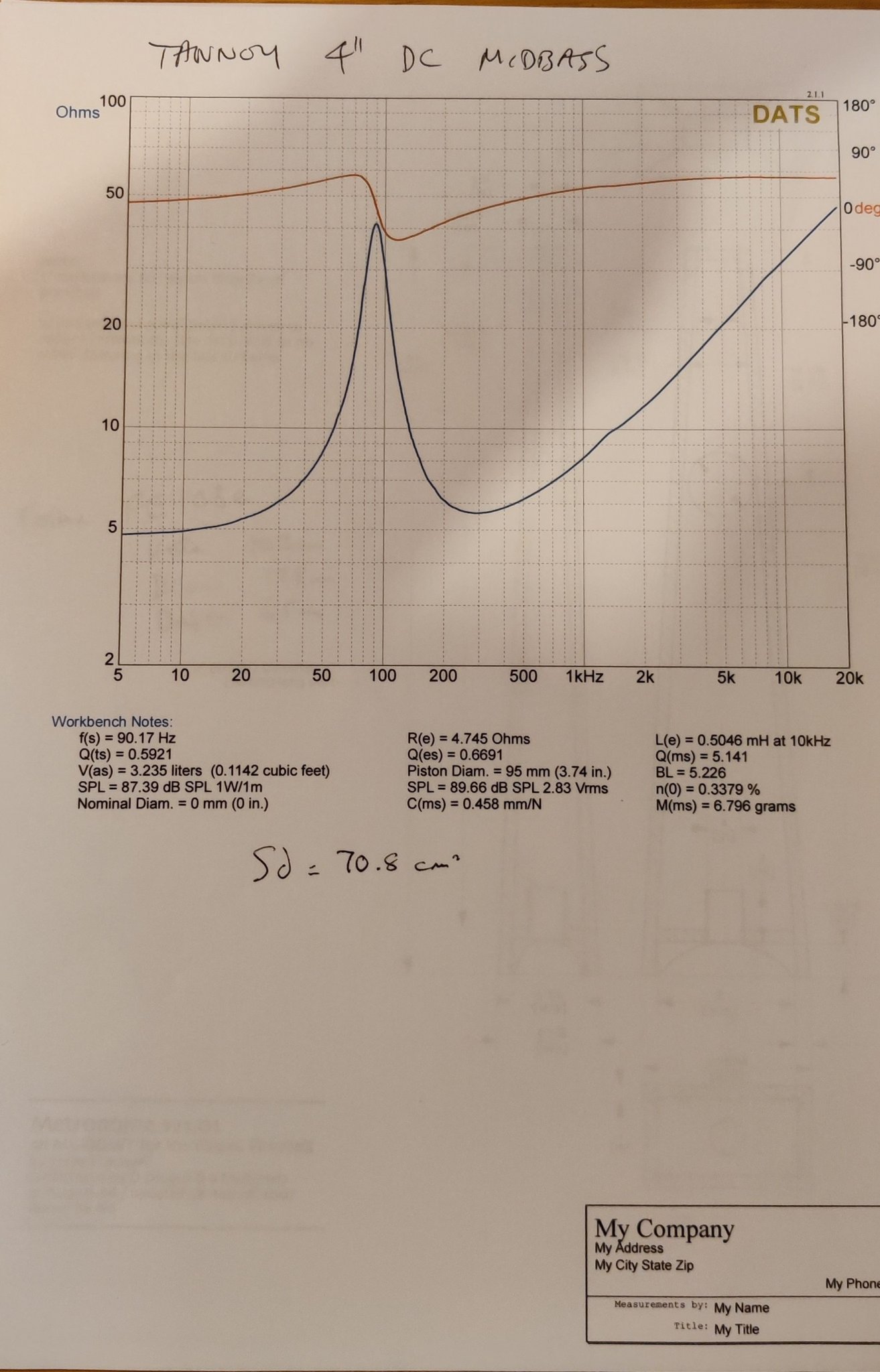

I'm considering using a pair of Tannoy ~4" dual concentric drivers - the ones used in the Autograph Mini - in Metronome cabs. The obvious one(s) to choose as a starting point, based on the size of the driver, would be the original one designed for the FE108e or the one designed for the FE127e. The Tannoy driver is a tad deeper than the Fostex - about 78mm from the back of the mounting flange - but the smaller cab could work if I use an additional thickness on the front face (possibly just a "power bulge"). The larger cab would be easier to mount the driver in. Any opinions as to the most fruitful direction to take here, and what cab dimensions I should be looking at? I've measured the midbass driver params using DATS V2 - see pic.

Any advice on how to model this - choice of software etc...? I've used Basta! so far, which is probably not suitable for this...When i put that 4” Tannoy into a miniOnken the same size as FF105wk, Alpair 6.2p so iy may need a smaller met. It shiykd be modeled.
