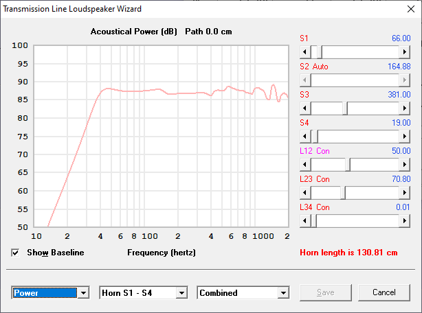

Metronome is an idea, till this AM i don’t know if anyone has devised a Met for the CHN-110. Dr Scott got back to me, here is his suggestion.
If you want drawings email me.
dave
CHN110 metronome
L = 70in
St = 5 3/4in x 3 1/2in
Sm = 11in x 9in
Zd = 35in
Vd = 2 1/2in
Vl = 3/4in
Lag top & non-opposing walls 1in OC-703, SAE F10 or equivalent.
Fb = 37Hz
F6 = 31Hz [nominal anechoic]

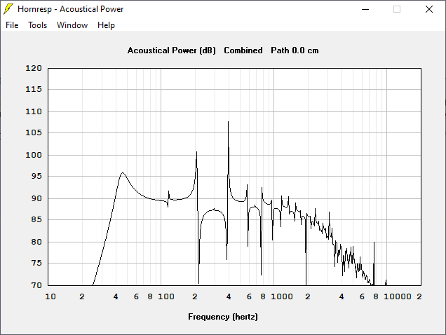

I have a set of Metronome style speakers using the Alpair 10.3M driver that I dearly love. I initially built a much bigger pair about the same size as recommended above. They got cut apart and put in the trash bin in short order.
After I examined the Metronome table I decided to build a smaller pair and modeled in the Leonard Transmission Line software. The resulting build was much better but had a hole in the mid-base. Out came the saw and I cut nearly 4" off the top. Better. After a few weeks I again brought out the saw and cut another 4" off the top. Experimenting with port lengths everything snapped into place with a 4" tube. They have remained unchanged since then.
Top 2-3/4" by 4-3/4" Bottom 6-3/4" by 8-3/4" Line Length 45", Driver Position 20.5 Vent 4" by 1-7/8". Carpet pad from the driver up. Lightly stuffed. (My experience is that I end up removing most of the stuffing.)
Caveats: I have no expertise in speaker design, and the 10.3M is not a CHN-110.

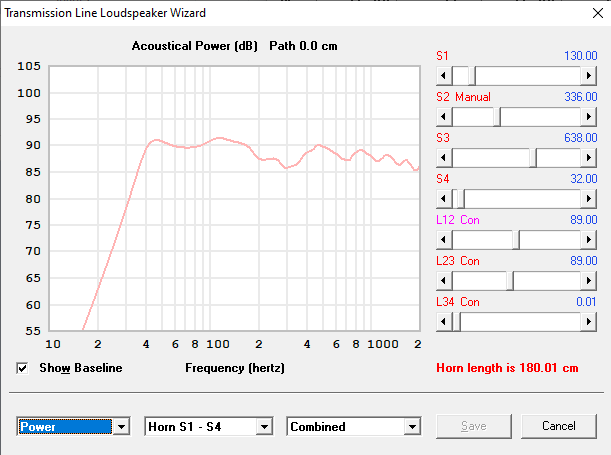

Here is what Leonard Transmission Line thinks how the result should work with no stuffing.

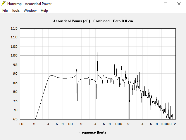

Thanks for sharing! My kind of DIY problem solving. You effectively lowered the driver in the pipe and had you dropped it another 2" to the 50% point would have optimized it even more, though only a little less stuffing required, so of course no big deal. 😉

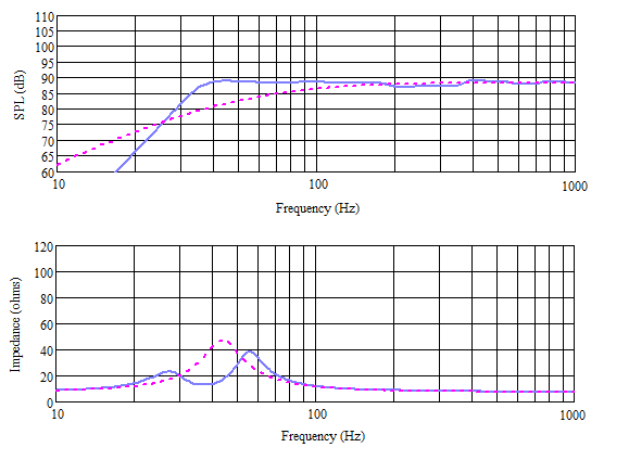

I entered those numbers into hornresp, and the resulting graph largely agrees with yours. Interestingly, the "saddle" (low spike followed by a broad dip before the resonance peaks set in) is shallower in your design when compared to several of the designs in the metronome alignment table with their native drivers. I'm not sure if that has any bearing on sound quality or not, but from my noodling around in hornresp, best I can tell is that both can result in nice looking curves when stuffed, though the flatter saddle tends to require less stuffing.
Attached are hornresp results (stuffed and unstuffed) if your 10.3 design, and the suggested CHN110 design

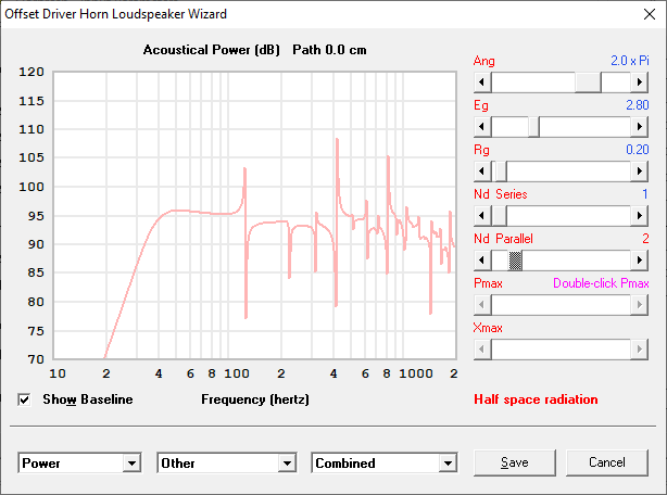

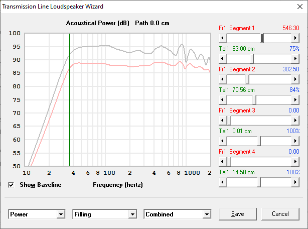

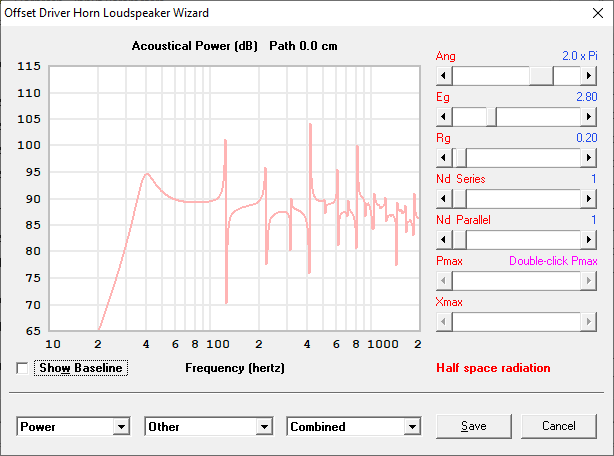

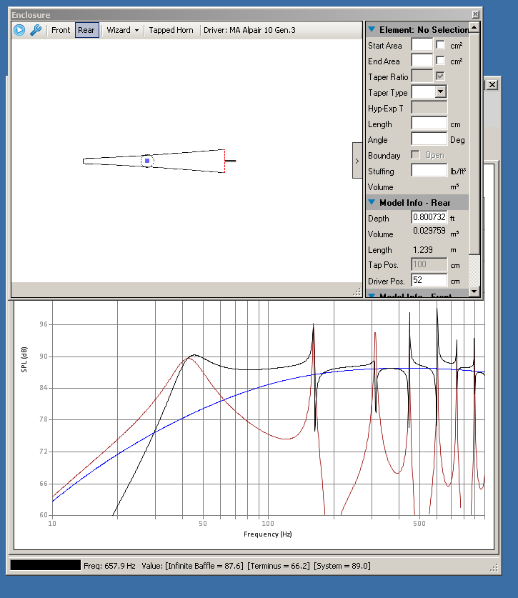

I've been playing around with hornresp, and I think I stumbled upon a design that works well as a monopole or bipole with the chn110 driver. This started out as tweaking the design scottmoose posted for a single-driver CHN-110 so that it would support two drivers in bipole config. I'm not sure if it's a general property of metronome speakers that bipole dimensions also are suitable for single drivers, but here it is
[FONT=Verdana, Helvetica, Arial]So: 64 cm2 (10 sq in)
Sl: 900 cm2 (140 sq in)
[/FONT]
[FONT=Verdana, Helvetica, Arial]L: 168 cm (66 in)
Zd: 84 cm (33 in)
[/FONT]
[FONT=Verdana, Helvetica, Arial]Port diameter: 10.3 cm (4 in)
Port length: 14.5 cm (5 3/4 in)
[/FONT]
Overall volume is just a tiny bit higher than scottmoose's single-driver design, which gives me pause that I could be doing something wrong. (i.e. are any of the dimensions impractical/problematic/suboptimal in real life?) The single-speaker variant needs a little stuffing in the bottom portion to smooth out the initial peak near Fb, but looks good once that's done. I've attached hornresp graphs of stuffed bipole vs monopole, and the raw response of each. I've also attached a pdf of a scale drawing
Interestingly, I tried the same design with the CHR-90, and the results are almost identical to the CHN-110. The biggest difference in the model is the CHN-110 requires a little less cone displacement to reach the same SPL when compared to the CHR-90. Otherwise, they practically behave identically.
