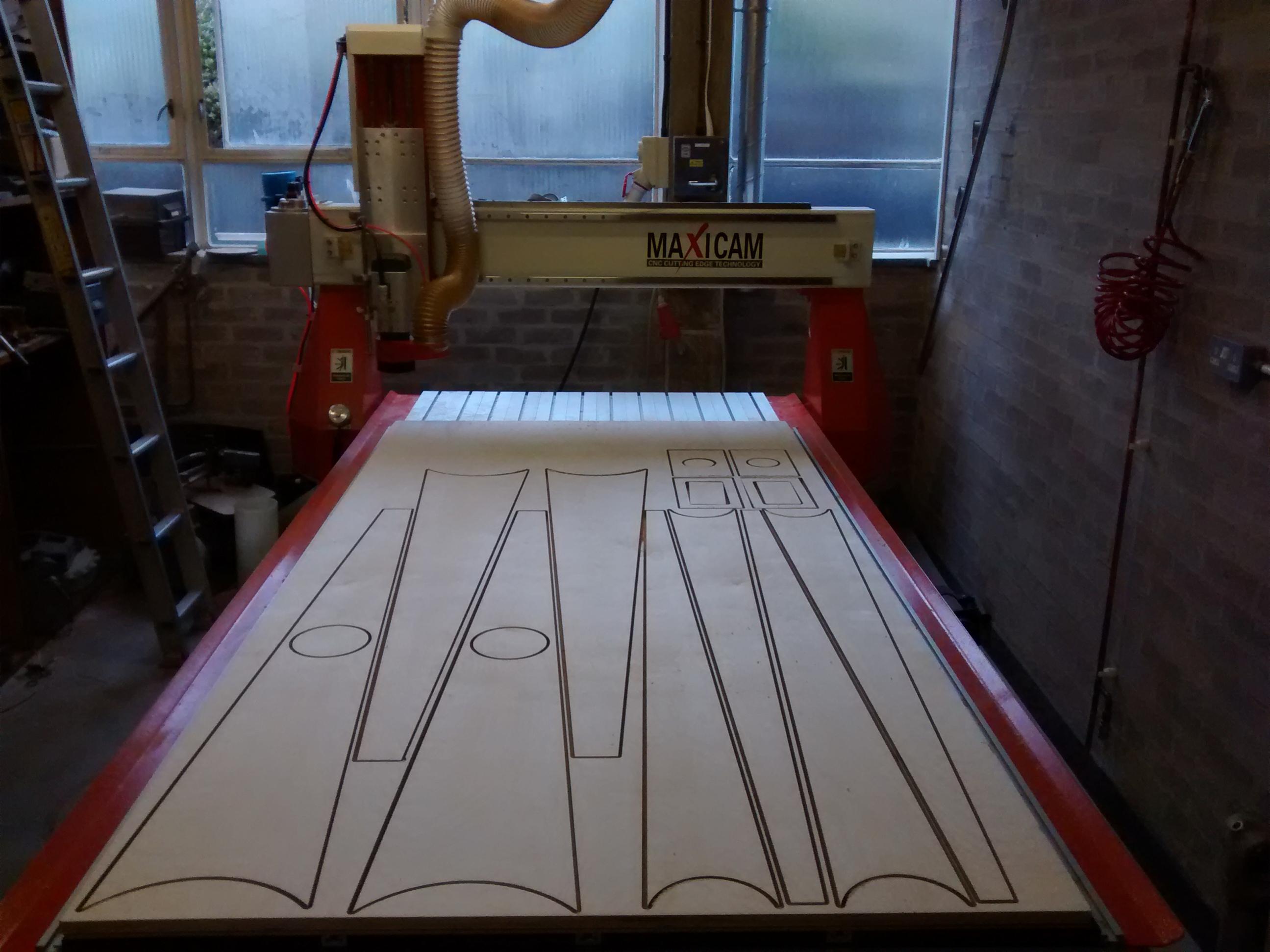

I stared with Jim Shearer's design for the Fostex FF165wk Mets and after fiddling with the dimensions in Mathcad concluded that the design was very tolerant of minor adjustments. A few tweaks were made to make the aesthetics fit the room and I finally settled on the following dimensions:
L - 60"
Ao - 2.5" x 1.6"
Ai - 10" x 6"
Z - 30"
Port - 3" dia x 4.5" long
The birch plywood finally arrived and so the parts were cut using a CNC router this afternoon. The assembly will follow as time allows over the next few weeks.

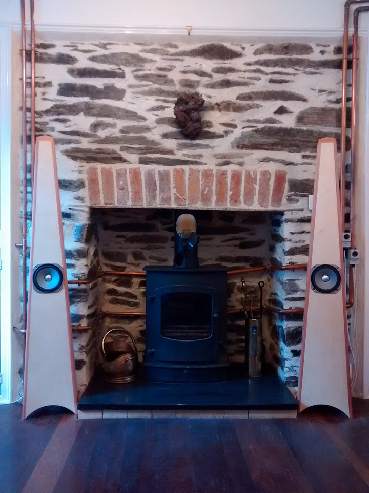

FF165 Mets complete and going through breaking in and testing. Sounding good already but a little bit harsh in the top end - think this is mostly the amp though. I've not done anything to the drivers yet but will add duct seal between the magnet and frame soon. Damping is 6mm foam carpet underlay over the whole of the back and light stuffing above the driver.
Cabinets are 18mm birch ply with Meranti edges and top. The sides are biscuit jointed to the edges and everything was routed flush and rounded over. Finish is danish oil, 2 coats so far but will get a few more. I made an error i the dimensions I posted above - height is 56" not 60" otherwise correct.
Probably. FWIW, the older FFxxxK series drivers I had actually didn't require much break in. They were however very much garbage, in garbage out. The sound was fantastic with my various tube amps, and clean solid state, but rather horrendously bad when hooked up to a high power 'audiophile' mosfet amp. I'd assume the FF165WK shares this family trait to some extent.
That said, I'd advise taking a measurement to see if the freq response is reasonable. Don't be afraid to use a BSC filter if needed.
