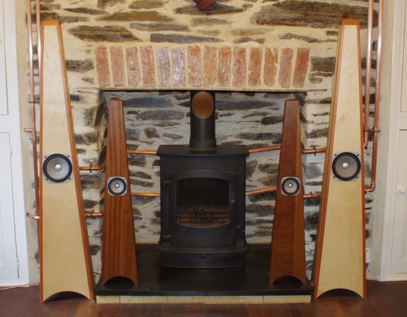

More Mets...
I liked the first pair of Mets so much I decided to make some more - this time smaller and using the Fostex FF105WK, show photographed next to their FF165WK bigger brothers.
Dimensions were optimised using MK's Mathcad and are as follows:
Ao = 1.20" x 0.42" = 0.5"^2
Ai = 6.47" x 4.7" = 24"^2
L = 37"
Z = 18"
Dport = 1.5"
Lport = 3"
This time they were made from hardwood - recycled Iroco lab bench tops planed down to 0.75" thick. They've had about 40 hours breaking in now and are sounding great. I suspect there will be more to come, they are somewhat addictive...
