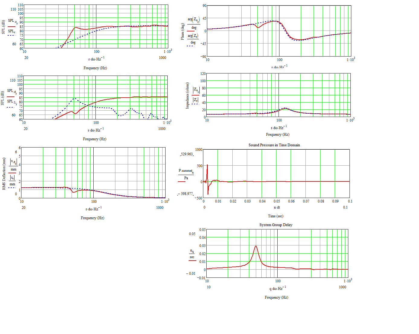

I'm hoping to build a pair of Metronomes using some Fountek FE83 3" drivers. Can anyone help me figure out the dimensions? If there's some sort of calculator out there that'd be great. I'd try to do it empirically but I wouldn't know where to begin making adjustments to the design.
Can't run MathCad 2000 XP on Win7 Pro AFAIK, but this one in Hornresp doesn't look bad once damped to 'taste' [all dims i.d.]:
L = 121.92 cm
S0 = 1 cm^2
SL = 139 cm^2
Zd = 60.96 cm
Dv = 2.18 cm [assumes 18-19 mm thick bottom plate]

I'm liking this. 🙂 Big pipe for the little 'un. Damped out to taste, nice EBS style alignment with a bit of a flick at 50Hz to give a bit more presence. Vent velocity (forgot to add that one, apologies) would normally be a little high for my taste, but being downward firing, unlikely to be an issue here. Impedance pretty unreactive -similar to what I do with some of my over-sized MLTL alignments, but with a much lower damping density. 🙂 Pretty well controlled excursion too. For these, I assumed all faces lined to a couple of inches below the driver, then back & one sidewall to the bottom. Nice job (as always) Greg!
Thanks!
Hmm, the vent is bigger than Small's formula based on Sd, Xmax, Fb for an inaudibly low vent mach, so curious why it would sim a bit high.
Regardless, the HR sim shows no under-damped Fb and a ~62 Hz excursion minima, so curious how it looks with modest stuffing all the down and increasing Dv to 2.54 cm or whatever is required to get the dip up to ~62 Hz.
TIA,
GM
