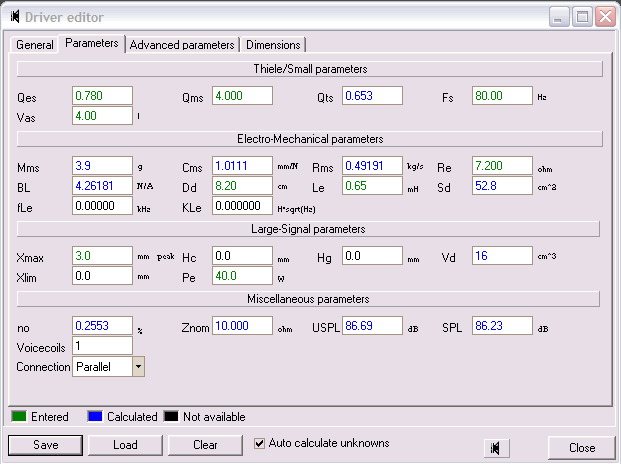

I'm only using the 126E because that's what I have. This is going to be a virtually no cost build. I was also going to try the Radio Shack drivers that I have, but I've searched for the specs on them and was never able to find any. They are NOT the ones that everyone uses, but they still sounded OK in my cardboard boxes. I was thinking that I'd make the bottom replaceable so I could adjust the length by trial and error to see if I could tune the sound.

I think I remember the 40-1041. It was IIRC sort of a less fancy 40-1354, with a smaller magnet. Did it maybe have a plastic whizzer?
I'd expect that they have moderately high Qts, and IMO are more suited to a Metronome than the FE126, but again, impossible to make an ideal box without specs. Anyhow, you would most likely have to measure them yourself, unless someone has one in their stash, and is willing to do it for you. Why not just make a fancier Metronome for them, since you like the sound? The less than perfectly resolved aspect of the bargain drivers will make things like Pandora more listenable.

So if you were looking at the Metronome tables which one would you start with for the 40-1041? It doesn't have to be a perfect match, just close. I have no idea how to measure the driver. If I had the specs I'd take a stab at figuring out dimensions, or again, just use something close.
It's rolling the dice to simply guess, and in fact it will take much less time to measure the speakers than rebuilding an enclosure that doesn't sound good. That caveat out of the way, I'd probably go for the smaller one for the FE167 in those tables. Make some sort of provision for experimenting with different ports, as the stock tuning is unlikely to be right.

Measuring T/S parameters is pretty easy. You need a multimeter, a resistor, and a computer with a soundcard to use as a signal generator. Oh, and a tupperware bowl or some enclosure of known volume for Vas. There are tutorials on the web. Or just buy the USB dongle device from partsexpress and click a couple buttons.
FWIW, here's my SWAG specs:
GM
