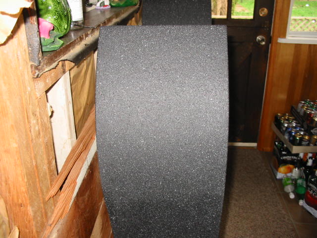

Sorry about your hard work going a little south.I have had a few large projects were handed to me a few years ago to see if I could fix.

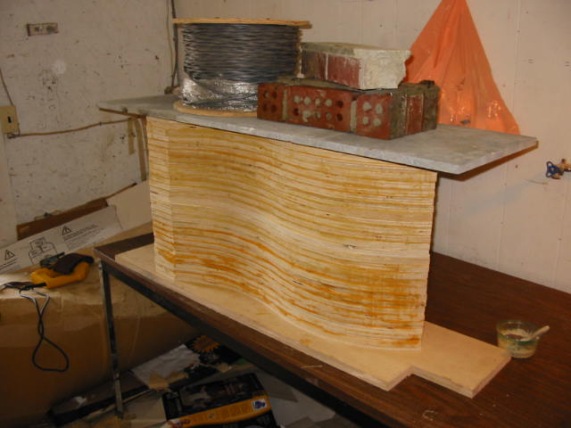

These were cracking so bad from moisture after coming to me it was unreal.Cracking got so bad I ened up using 2 gallons of Bondo scraping it on with a 2x4. Then reclanding them with 1/4" plywood on the exterior.
Here is a photo showing the top lag bolts around them.Then another 2 layers of Baltic Birch were placed on the top.
What I found was the torque from the bolts made it WORSE. Do not put compression on the wood.For long periods.It is different to clamping them to hold during glue drying.
In the end they worked out Great but with 3.5" thick they weighted over 280lbs and my customer got a moving company for the pick up and delivery to his place.Thankfully :)

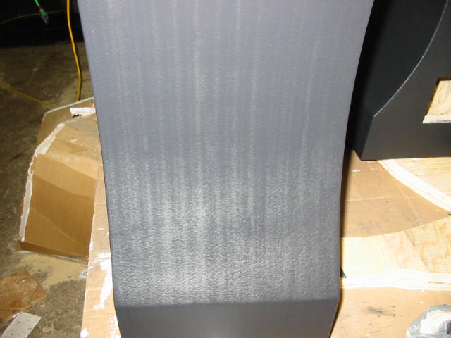

Now the large arrays I did for the same customer used the same method stacked and bolted MDF baltic layered.This array was for 12AC G1 ribbons with Accuton Mids Open baffled sitting onto of 4 TC 12" woofers then the large subs in the corners with 21" Aura's
Notice the curve that happened to the cabinet

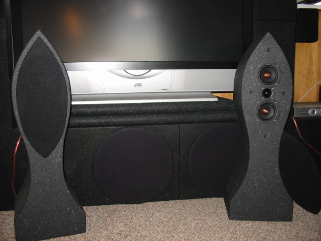

Here is them close to finished with a lot of cutting needed to get them to look like this.Book matched Paduke veneer.The outer stack was done for acoustic then the large panels the ribbons mounted to open back then the panel for the Accuton mids matching them together. This all sits on a W set of TC 12" subs OB.
In the end took my spare time over 3yrs to build as I did them

For sure the ply would not have split without the rods.
I did find my stack of ply ( approx. 38 layers of 25mm ) expanded and contracted enough to visibly ripple the Piano Black gloss and clear lacquer.
We ended up having to clad the stack in 6mm curved ply wood and then spray / lacquer on top of that.

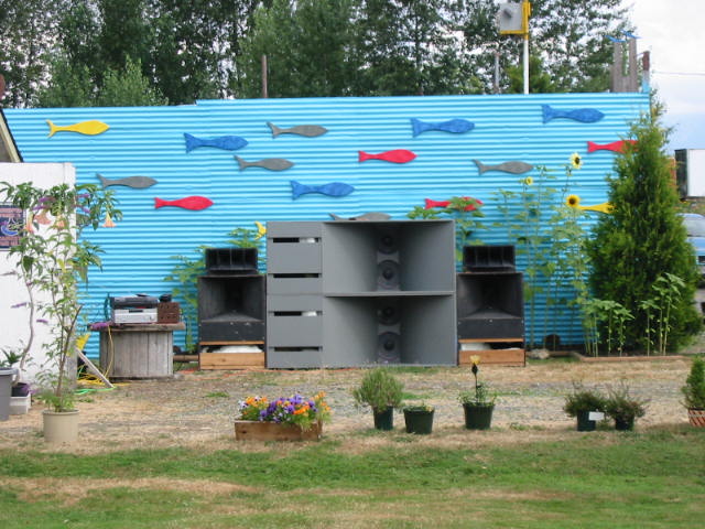

Just for fun, I used the cut-out centres to cover a industrial wall at my friend's place. The Fish Wall.
