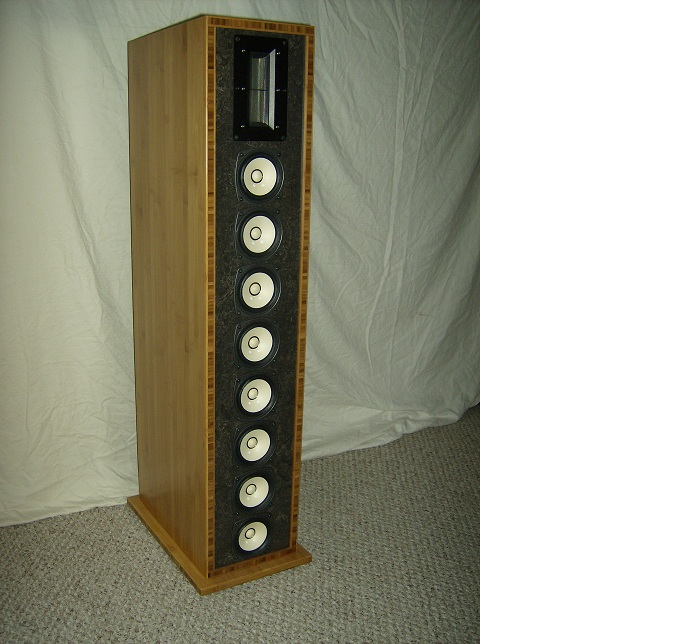

Sorry to see this happen to your lovely tower speakers. But plenty of ideas from the community, and it might be very well possible for you to repair these.
Thinking aloud, maybe you can glue the two pieces together with wood glue (any ideas on how you can create necessary compression/pressure for a good bond?). It is likely that leaks/holes will remain from the craked layers - would application of two part epoxy work to create a seal? Mixed together, most of them form a paste like substance, which you might be able to apply across the length of crack and create a "seal"from the inside.
For now I kinda forced it back into shape with some wood glue in between. No telling how much glue I got in there though, I could force the bolts on both sides of the stack and noticed a reduction in the seam. So I quickly added glue and went on. All in all it took some time so I do not trust this repair too much. All this while cooking dinner (lol).
I'll spend the next couple of days thinking about how to go forward. I won't quit now!
But they won't be as pretty as they were when I'm done I'm afraid. Might as well think about wrapping them with something strong and going for an all black look.
Right now you can't see it was broken. The weather is about to change again so the pressure on the threaded rods will be huge after this change!
Before you rush in, do ensure that you understand what caused the crack.
I am suprised as the rods are compressing the stack, not stretching it.
I'm confused how this happened - as it has delaminated the plywood there must have been substantial forces at work.
I think I understand why it happened. The rods would not let the wood contract fast enough causing high stress. The differences in length in a stack like this can be huge. I noticed at least 4 mm difference in length at times.
I'm sure they were in one piece last night. So it all went pretty quick. Every other layer there is glue around the rods. That's probably what was holding back the ends to contract. My reasoning was it would spread the pressure, but I was wrong there. Lesson learned. Move on from here...
If the rods are holding the structure, I would clean up he gap a bit, maybe even enlarge it and fill with some type of silicon or rubber joint compound to create a permanent expansion joint. I would then carefully route or carve a band around the affected part of the enclosure and put some type of flexible inlay to cover the joint.
Could the top and bottom of the cabinets be adhered to the rods with excess glue? so as the wood contracted the cab split in the middle because the ends were held apart by the rods. If this was the case could you not just remove the rods to avoid further damage?

Hi. I’ve been a professional carpenter and have done a lot of furniture restoration so I feel I have so knowledge to share. I’m confident that with the right approach this can be glued back together without leaving a trace of it ever having happened, as long as you can keep the brake clean and aligned as it is. You’d need a couple of bar clamps of the right length. Even though I’ve never seen them in this length, so a customized set could be an option. If gluing for some reason doesn’t work, then cutting the broken section out and replacing it with a new one would also be possible, but that would obviously mean a lot more refinishing. All in all a major setback in this build, but surely not game-over.
The only question would be, how to prevent this from happening again. The first thing that comes in my mind is to seal the wood inside and out with clear epoxy, the stuff you get at the boat chandler by West here in the Netherlands. If you take the slow curing kind and warm up the wood a little, it will soak up the epoxy like a sponge creating a good moisture barrier and also reinforcing the wood itself.

Thanks guys for saving me the trouble of acknowledging the existence of comb filtering in a line array like this. Yes, I am fully aware of that fact and the above reply does a good job of explaining the effects and a partial cure for it (read EQ).
I know what I'm getting myself in to in this regard. Somehow that isn't my main concern right now 😉.
Thanks for your insight Stijn, and all others that profided ideas and solutions for that matter! I won't quit now. Taking a day or two to examine my possibilities.
The tower is fixed for now, with hardly any evidence it happened in the first place. I was able to force the 2 parts back together slowly by turning the nuts at both sides (equal turns) and taking my time doing that. I'm not convinced the amount of glue I got in there is sufficient though. If I do not do anything else it will happen again I'm afraid.
Stijn, For the epoxy to work, I have to sand down the polyurethane clear coat right? Can I re-apply the stain I used? I'm thinking of using woven glass matt with the epoxy as a laminate to strengthen the enclosure. That was my original plan in the first place. I should have just went with that but tried to take an easy way out after reading success stories from translam constructions using polyurethane coatings. But I have no idea if they used threaded rods in their stacks. And I am pretty sure their stacks were smaller!
My problem is the temperatures are going down quickly outside. At best I can heat my garage 5 degrees more than the outside temperature. No real heating, just a small heater. I can't afford any better right now. So do I wait till spring to finish this? It would almost kill me to wait that long! 😱
The thinner matt clears up with wetting by epoxy leaving me with an equal finish I have now. Still needs a clear coat for UV protection.
I even consider using a carbon/aramid matt although very expensive but that would make a possible finish. Plus the aramid fiber is a very strong fiber in the pull direction. Much stronger than glass matt.
How can I get myself to be patient enough to wait till spring
With a material like carbon/aramid I would have to wait. No point in experimenting with faster harder's (for lower temperatures) on a material of that price.
I'll think it over and any advice is welcome, good advice even better! 😀

I'm not certain it's added strength from a coating (be it fibreglass or whatever) that you would obtain or even need so much as some degree of protection from differential changes in temperature & humidity in the wood and supporting metal rods. It should help to a degree with those, providing the coating is complete, & you can as far as possible keep exposures to such changes as minimal & gradual as possible.
A torque wrench is the only reliable way of equalising the bolt pressures. If the torque required is not excessive perhaps a spring or similar arrangement may permit some degree of latitude on the bolt ends to allow for different expansion between rod and plates?
Monitor and control the room humidity as well - a small in room humidifier may help keep the room stable until you can work in the garage in the springtime.
It's probably been mentioned already but sealing the insides of the enclosure when the wood has stabilized is also a must.

Sorry about your hard work going a little south.I have had a few large projects were handed to me a few years ago to see if I could fix.
These were cracking so bad from moisture after coming to me it was unreal.Cracking got so bad I ened up using 2 gallons of Bondo scraping it on with a 2x4. Then reclanding them with 1/4" plywood on the exterior.
Here is a photo showing the top lag bolts around them.Then another 2 layers of Baltic Birch were placed on the top.
What I found was the torque from the bolts made it WORSE. Do not put compression on the wood.For long periods.It is different to clamping them to hold during glue drying.
In the end they worked out Great but with 3.5" thick they weighted over 280lbs and my customer got a moving company for the pick up and delivery to his place.Thankfully 🙂
Now the large arrays I did for the same customer used the same method stacked and bolted MDF baltic layered.This array was for 12AC G1 ribbons with Accuton Mids Open baffled sitting onto of 4 TC 12" woofers then the large subs in the corners with 21" Aura's
Notice the curve that happened to the cabinet
Here is them close to finished with a lot of cutting needed to get them to look like this.Book matched Paduke veneer.The outer stack was done for acoustic then the large panels the ribbons mounted to open back then the panel for the Accuton mids matching them together. This all sits on a W set of TC 12" subs OB.
In the end took my spare time over 3yrs to build as I did them
I hope you can make them work in the end but having the wood not sealed on both sides was the big thing I did in the end.

Oh, I read you left the rods in there......
I'd put a penny on the rods expanding and, being effectively glued in have expanded caused by the move from 'cold' to 'hot'.
Also the enclosure is 'Horseshoe' shaped, this would make it susceptible to rotational stresses
Throw in a 'bad lamination', looks like that piece had a few voids, and throw in 'transport' stresses.......
I would fix them by finding some one with a decent size band saw and chop them in half - remove enough material so each 'half' can have a bottom / top glued on.
