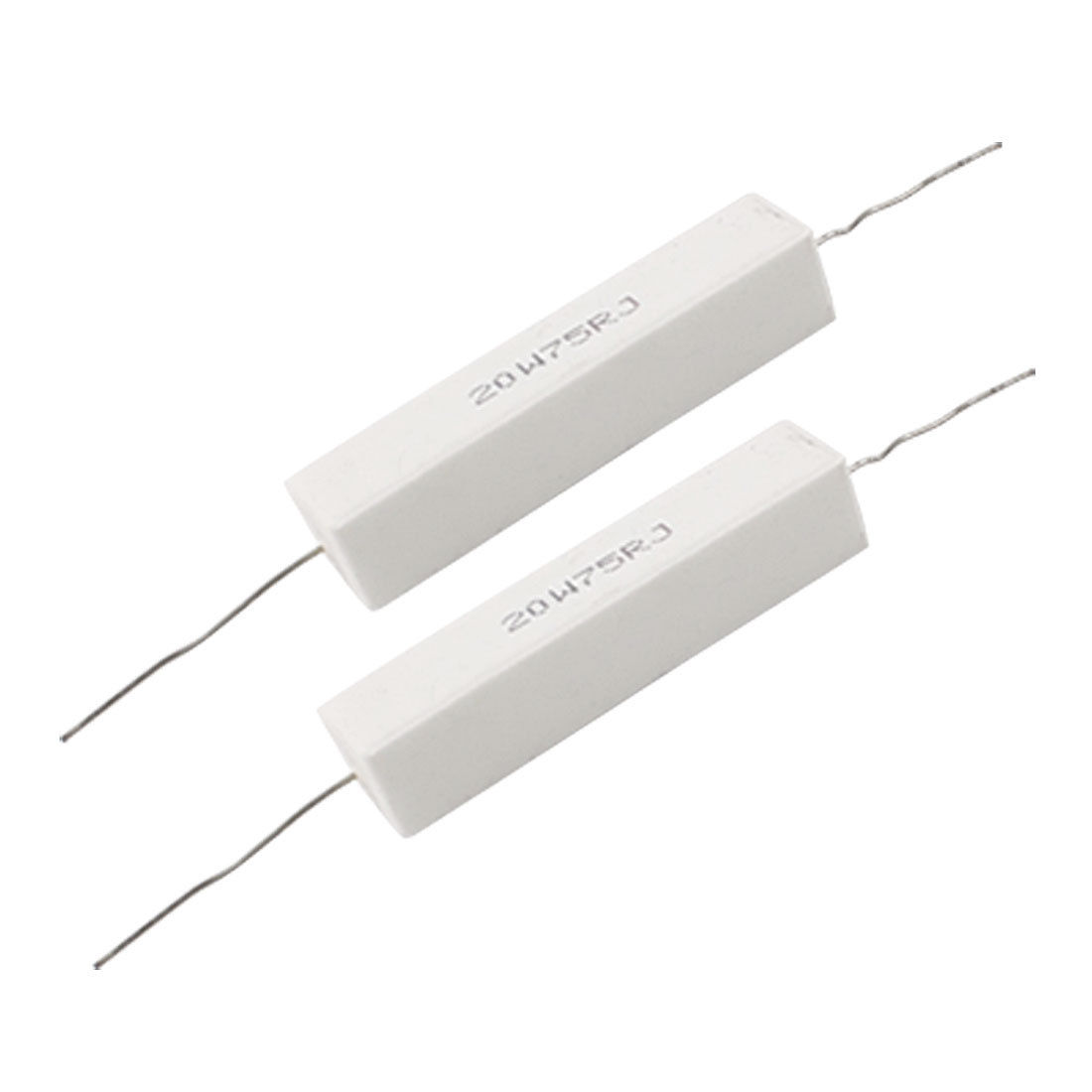

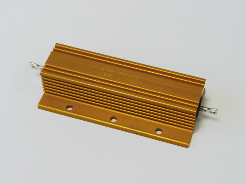

A question I hope to get answered... I need pretty big resistors with good power handling.
Do I parallel multiple ceramic type resistors to up the power handling or would a wire wound resistor work for a big Zobel like network.
I'd expect the wire wound resistor type to act somewhat like an inductor. More so than a typical ceramic resistor would? But good power handling is necessary.
I guess the ceramic ones are still wire wound but I could parallel 5x 100 ohm 20 watt to get one ~100 watt 20 ohm resistor that way.
5 x 75 ohm 20 watt parallel to get 15 ohm etc.
attachment.php
Or would these work as well:
attachment.php
Any help?
For capacitors I'd go for MKP and inductors an iron core would probably be fine for this particular job as long as it's power handling is up to the task. I'm definitely open for suggestions here...

For speakers in domestic usage, you don't need resistors of that much power rating in Zobel.
Anything 3-5W in your drawer would do. I've used 2W in some occasions and they work fine. They never get warm, never fail. (what if they fail? it's alright, just open like a fuse, no hazard)
If the resistors in passive xover get hot and burned-out (in a properly designed speaker/network), you will loose your hearing already. Then it doesn't matter anyway. ;)
I'm not compensating for one 10 watt driver here. I have 25 a side that I look at as one big 240 watt driver. The biggest load will be at the low frequencies. Higher frequencies will be a very small load in comparison. Most of the entire speaker will not see any more than those 2 watt. That is correct. But in bass frequencies there is a lot more with about 15 dB of boost.

I'm not compensating for one 10 watt driver here. I have 25 a side that I look at as one big 240 watt driver. The biggest load will be at the low frequencies. ...
The Zobel is a cap in series with a resistor, right?
So the LF is largely blocked by the cap, there won't be high current of LF going through the resistor.
What are the value of R and C? By which you can calculate at what frequency the C starts dominating the whole impedance of the string.
