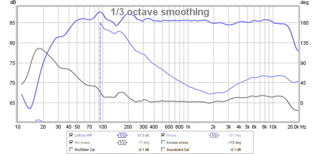

I goes it must have been stray inductance from a sloppy placement of cables on my left speaker. I cleaned up other wires and cables going near it and the phase wrap at 1kHz went away. Both speakers match now.
I took out the infrasonic high pass filter and the sound is much more realistic and engaging. Really like how it sounds now. Listened to two whole live jazz cd's last night. Good stuff.

Good thing you found the cause for that phase wrap. To bad though you had to settle for second order filters...
Here's what my phase looks like, still gated 5 ms amd smoothed 1/3 like yours...
measured at the listening position, 3 meters away

That is some darned nice flat phase there...

Yes, nice phase response!

Working on those eyebrows seems to pay off so far. Not nearly done yet though.
But the sound definitely improved. It's getting better with better measurements, who would have thought 🙂.

The thing I'm working on is getting the timing as right as I can. So far it gives almost any recording an atmosphere, a believable scene if you will. Lots of new clues in old familiar songs, i.m.h.o. due to the correct harmonics. Fun and engaging, snappy and dynamic.
