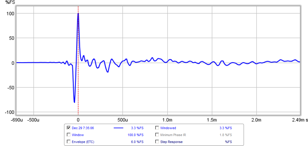

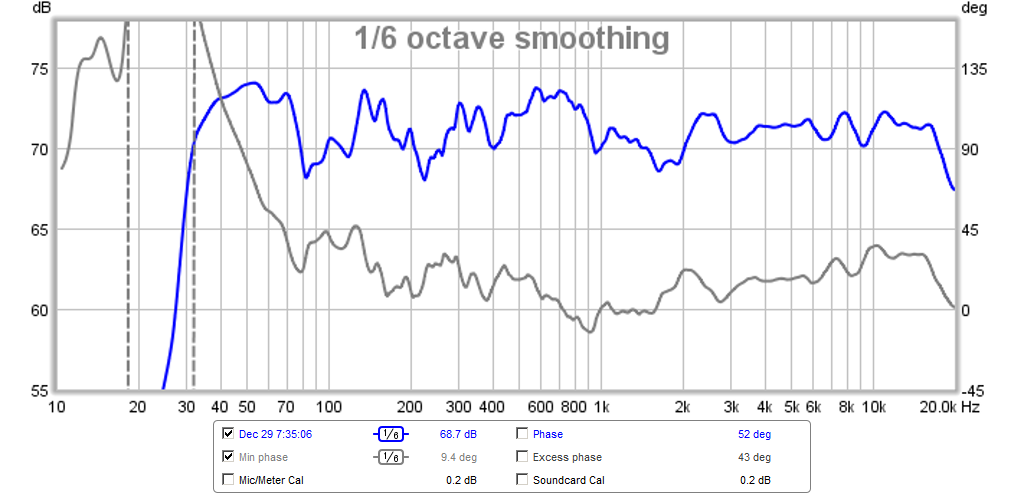

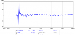

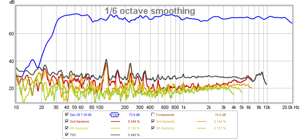

Ok, here is the same song (at least first 45 seconds) played on my reference system and recorded at 96kHz 24bit and compressed to 320kbit MP3. Keep in mind that this is a stereo recording of the right channel in mono. The recorder is a Zoom H4 set at mid-gain. Actual sound levels are in the 95dB range, quite loud. Change the extension from .ASC to .MP3 in order to listen. Let me know what you think. I think I need to build the matching stereo pair. 😀

By the way, while you're here, what's the window you use at 20 kHz? How many samples? The loner I make that window, the more focus I get. Yet it becomes a bit unnatural at some point. Not sure where the limit is.
Glad you're joining in on the fun X! You should make it a stereo set.
It sounds a bit crisp on my lines, will try headphones next. Might just be living with a "warm" speaker setup for 20+ years on my part 😀.

Here is the freq response/phase and harmonic distortion of my reference speaker along with the IR. Perhaps it is the massive single overshoot on the impulse that makes it "harsh". The frequency response is relatively flat +/- 2.5db and not tilted down as HF's go up like how have yours. Perhaps that is what the "brightness" is from? The IR is typically reversed because I think the pre-amp in my mic produces a reversed signal? I have noticed it on all drivers even simple full range at near field (yes I checked polarity of driver with battery).
