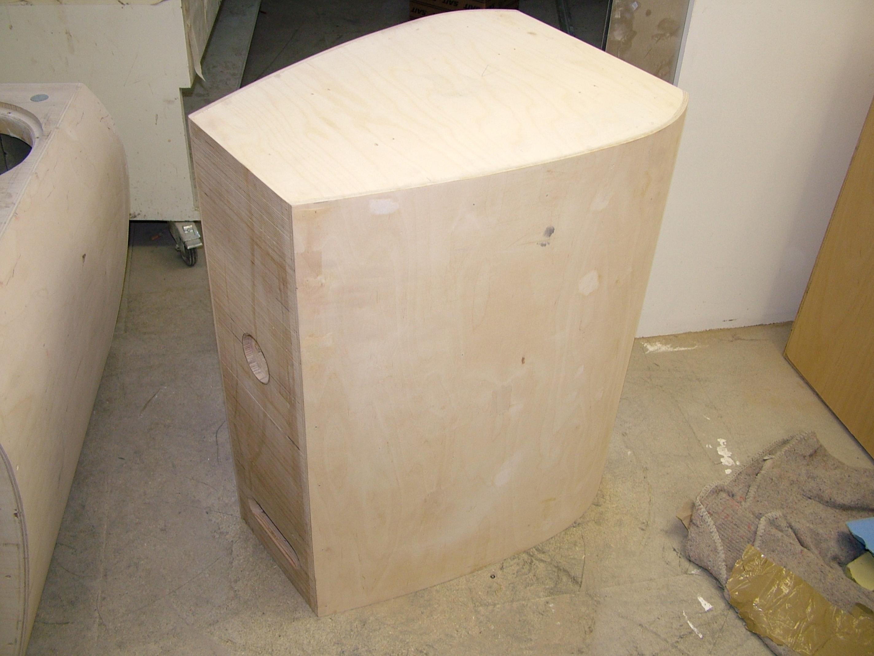

If I were building another pair of free standing loudspeakers I would stick with Birch Ply laminated top to bottom.

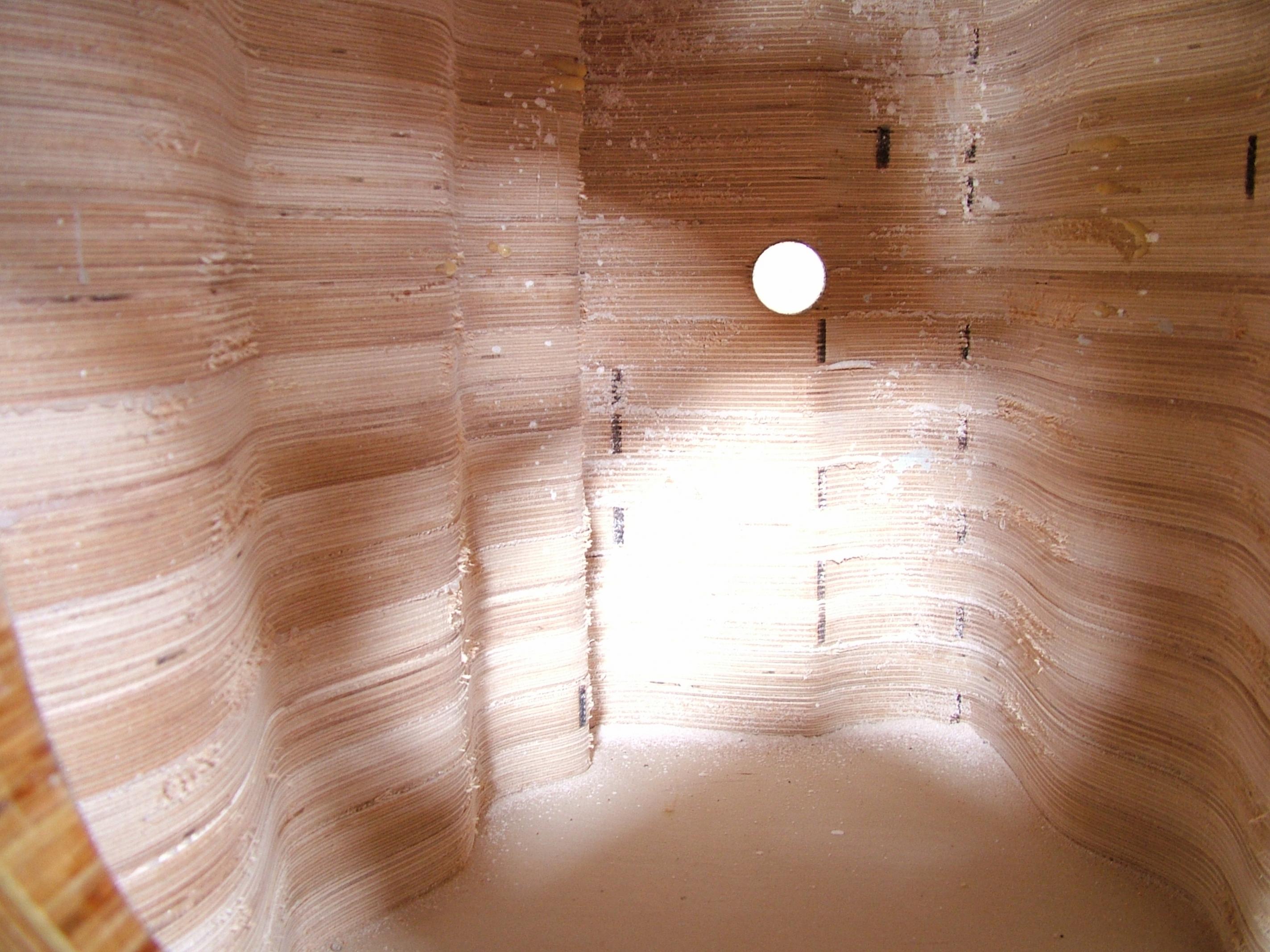

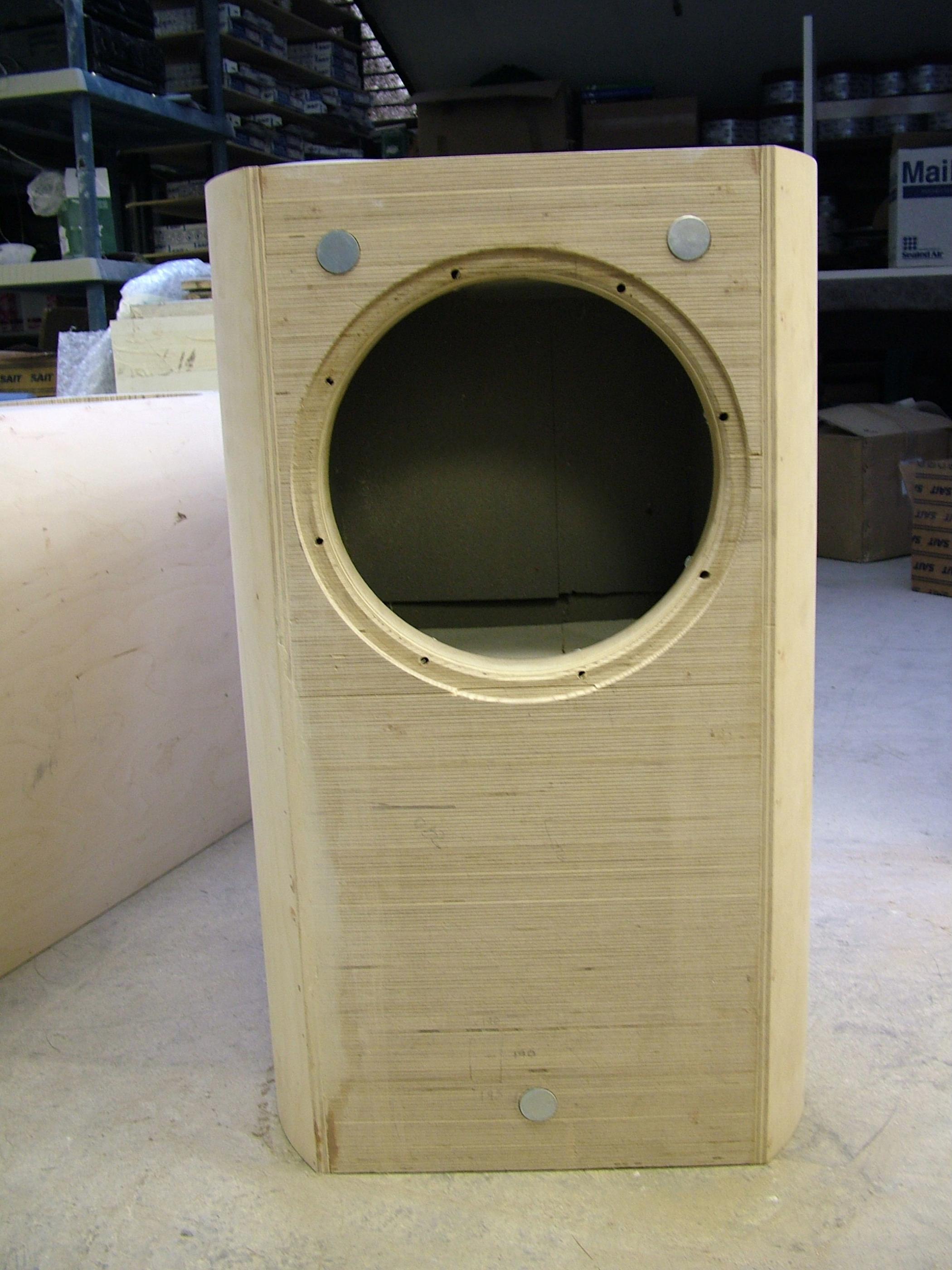

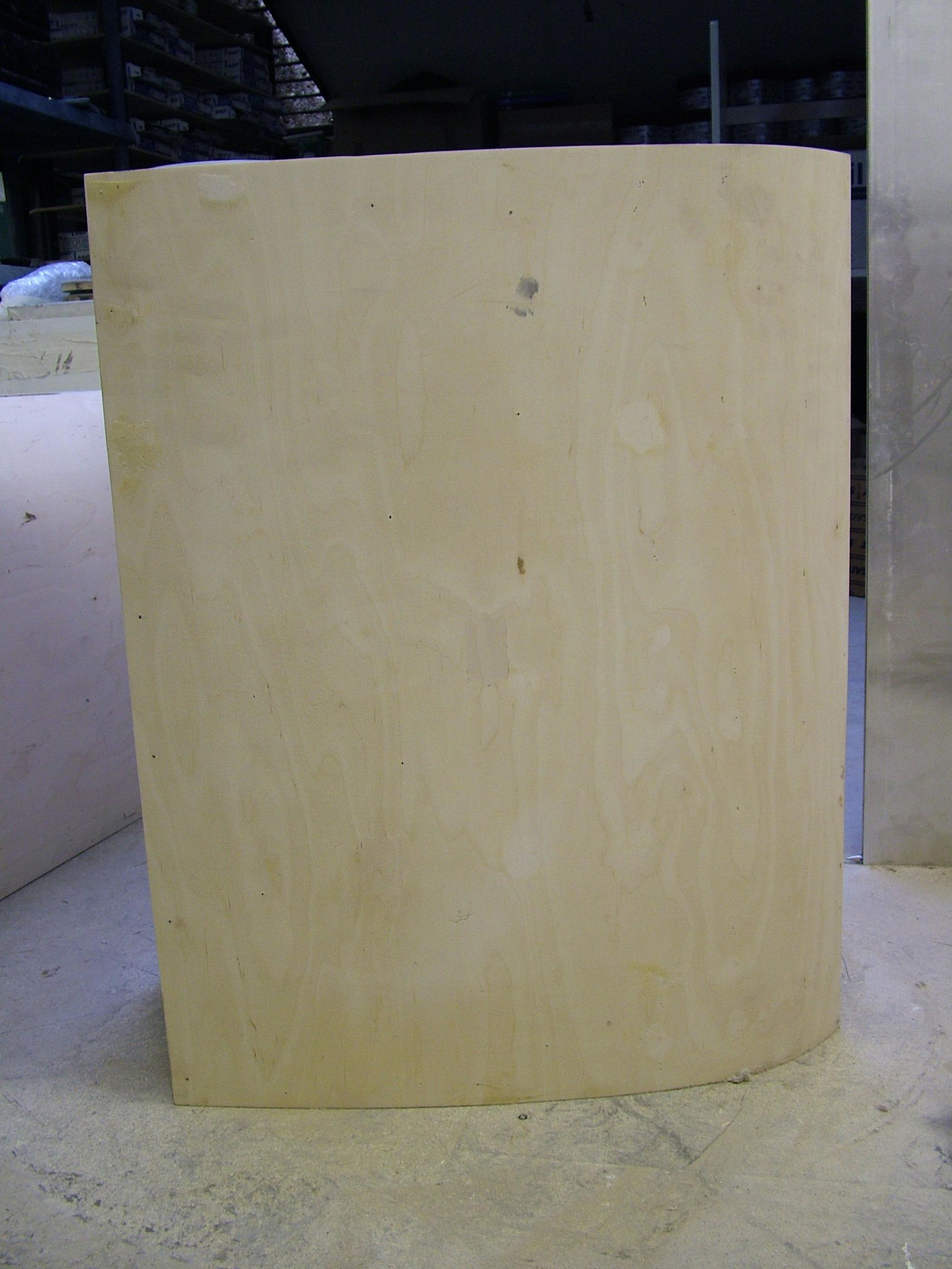

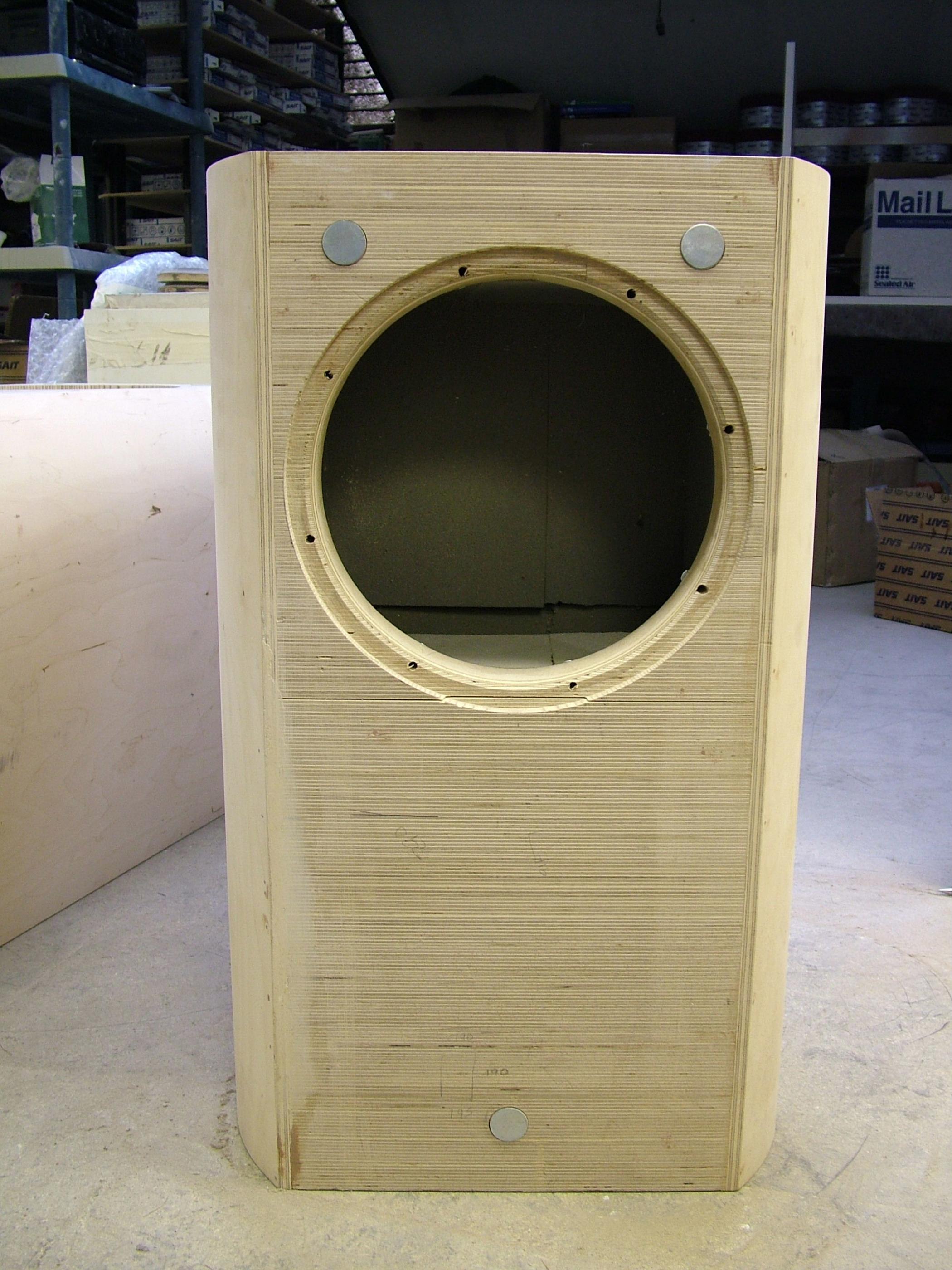

Back in 2005 I built these:
The good news was the looked fab and sounded stunning....
The bad news was 135Kg per cabinet, and that was just the bass section....!
But one important lesson regarding weight, the ratio of driver Mms to cabinet weight is important.
There were noticeable sonic improvements going up from 40Kg to 100Kg and then subtle improvements up to about 120Kg.
The short story is make sure your cabinet weight is at least 80 times that of the total Mms of all 25 drivers combined.
In my case a 12 inch Beyma 12LX60 Mms was around 100g after I added cone treatments, so anything above 100Kg cabinet weight was "Slamming!"
Although acoustic bass was the best way to test, bowed upright bass and low Cello just kept getting clearer and more textured as the cabinet weight increased...
The external looks were...

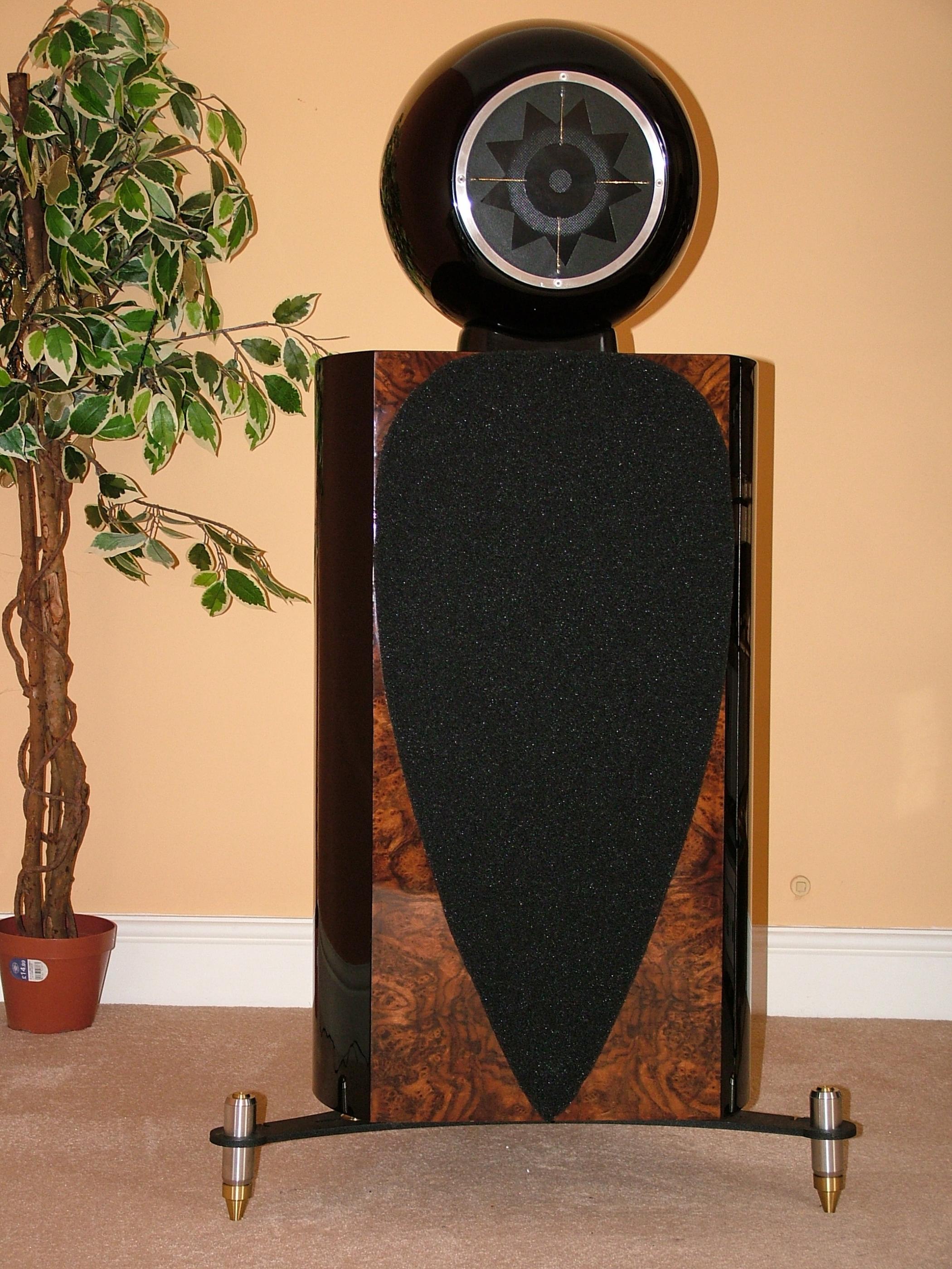

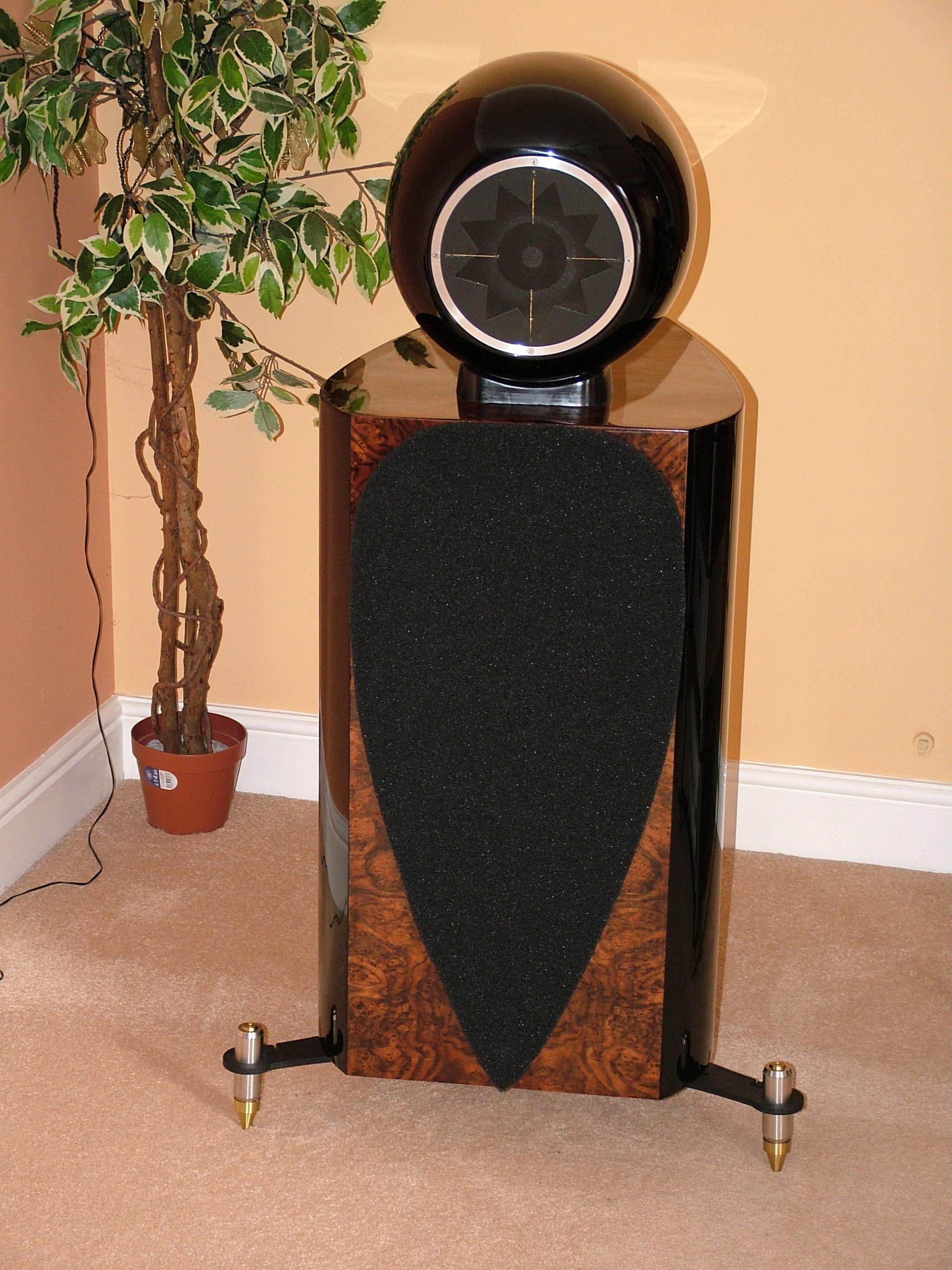

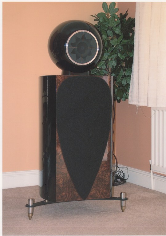

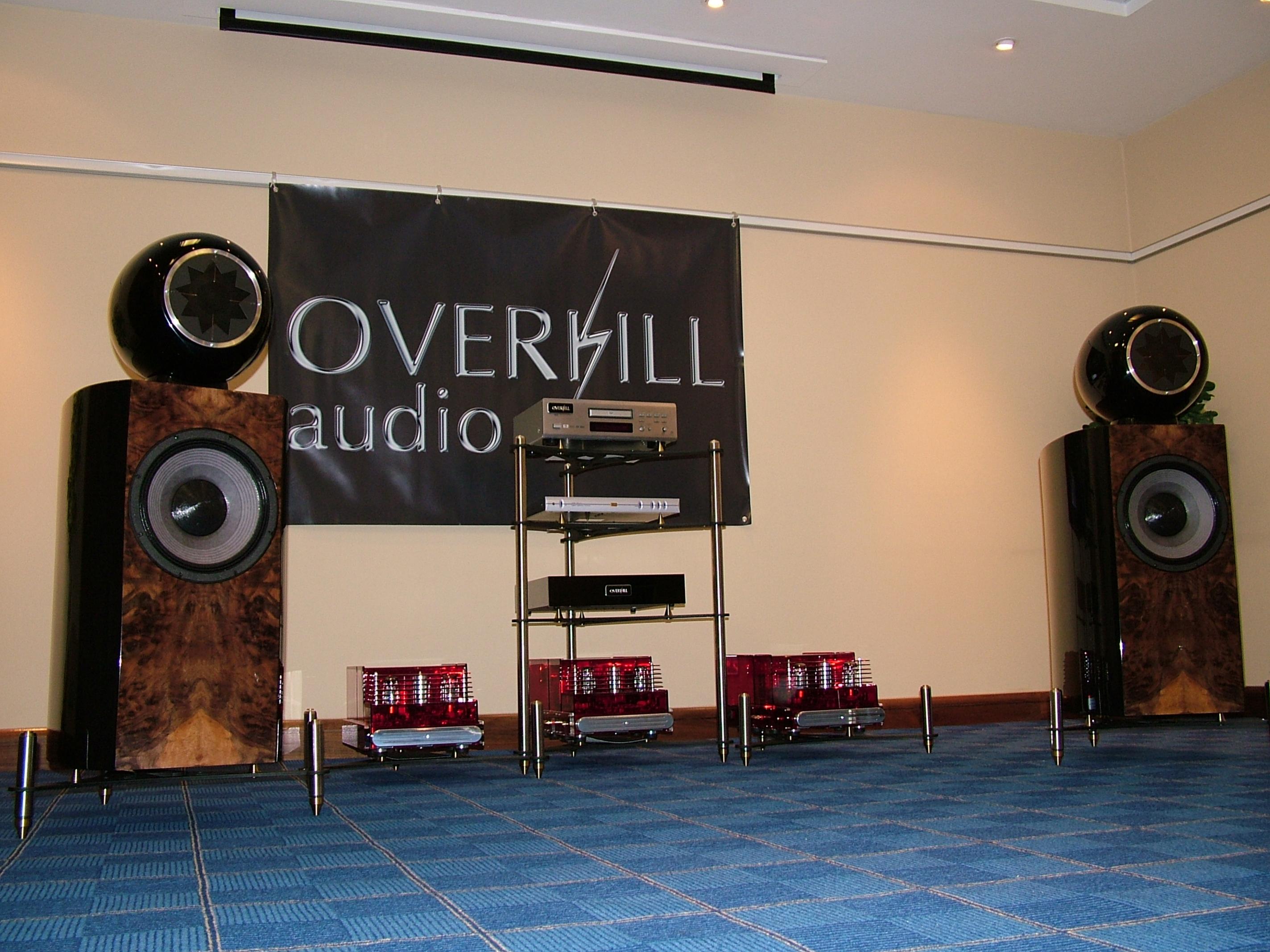

But after finishing....
Its amazing what good veneer and Polyester piano black can do...
We did have clad the stack in 8mm ply to avoid the lines showing through the piano black sides.
