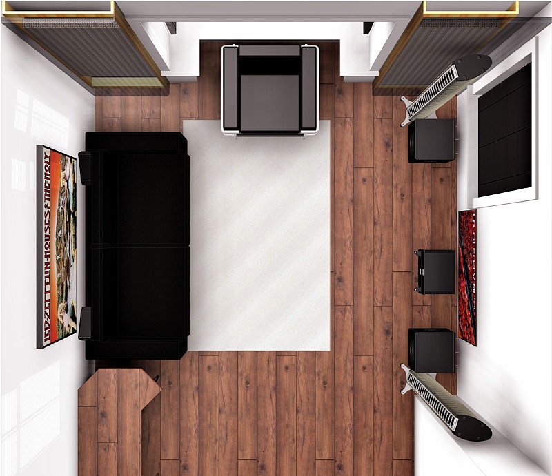

I must say, getting close to what I want/love. One thing still nags me a bit, I have an asymmetrical setup, and that does result in a stronger left side than the right side when listening. The phantom part is dead on straight ahead, but somehow the right side feels less "full", the emphasis is always on the left (where the walls with damping panels are). Due to the walls there that are missing from the right side, it isn't shocking that you'd hear it being different, but it's harder to make up for. I'll try though.
Wall(s) on the left side (with damping panel), fire place and open on the right side.
Maybe I can use the Multichannel setup disk to show differences in SPL. First I need to find a proper time slot again for these kind of exercises.
On other fronts, like the potential for even bass output etc, the asymmetrical part of the room is helping out. We had a famous football player called Johan Cruijff who said: Every advantage has its disadvantage. I guess he was right

Maybe you could convince your significant other to put some kind of tall structure or sculpture on the white wall on the right side. It would help focus a bit of the loss of power you get from there.
Or something like a deep Lightbox with a movie poster in it.
If you mentioned this issue so concisely elsewhere in the thread, I’m forgetting.
I’ve a variation of this issue in reverse: right wall totally untreated (besides a couch); left wall has room-length, floor-to-ceiling shelves. I don’t remove early reflections so L / R interactions with sidewalls should be different.
The effect = dominant right channel in many (most?) recordings, although the phantom center is generally large enough that, as you said, remains spot-on.
The idea of using a multi-channel disk to test SPL is a good one. Wish I still had my last multi-channel receiver…
and the time to use it!
What would happen if you slightly increased overall gain for your right channel, in this regard?
I can do better than that... I already split the Stereo signal into it's mid and side components and as such I can raise the right channel level without upsetting the phantom balance. But, there's always a but in Audio, raising the right channel will also influence the left, as there's a -L component in that right channel. So it's a balancing act, as always. The Phantom part is L+R, which means it already contains part of the the left and right channel. The side information is L-R for left and R-L for the right. So small tweaks is all it takes.
For Home Theatre I already tweak channel balance as if I really have a dedicated center channel. For stereo it works a little different because that center actually contains the side info as well. But I can balance left and right independently.
