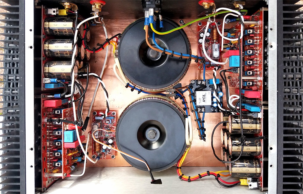

Today I'm sure it skipped a few beats. If it's because I'm not as thorough or clear thinking or what not...
I started up everything slowly and step by step. So only the main amplifier feeding the main speakers. Right away the speaker with the 10F's began singing
but I failed to hear the other side. I walked over to that side to see if anything was wrong. As I got there I heard loud puffs and crunch sounds coming from
the (yes, the Telos clone) amplifier. I looked that way and saw flashes, smelled and saw the smoke coming out and rushed over to turn it off. The right (10F)
channel kept playing for a few more seconds before it cut off. Silence and a smell of burned components...

the other side before turning on the amp. The spades that connected the conjugation network seemed to have created a short. I didn't know they could as I
was certain they were protected enough by the shrink wrap. Clearly they were able to though... It probably happened when I replaced a modem behind the

I've opened up the case and the smell was obvious but I couldn't spot any burned places. It is way beyond my skills so I emailed @koldby to confess my sins.

The amp is a Goldmund Telos 400 clone with 6 pairs of ECX10N20 and ECX10P20 I believe...
@koldby made it some time ago for personal use until I kinda stole it from him 😀. I've been in contact with him and

Is it this one?

Have you used your nose to identify burned parts? Works great usually. Be careful with electrolitycs if curved/deformed on top or hiss'ing audibly ( they'll explode if hissing, probably will if curved).

Yes, I've put my nose in the amp to smell lots of burned smells... but I can't locate where it comes from (*). I've send you a schematic.
(*)= if I'm honest, I think the smell come from the side above the output mosfets, not the speaker protection... the left bottom side where
one sees the top 6 mosfets and the PCB above it...

Thank you, got the schematic.
Very impressive built by Koldby, at first i thought it was a commercial unit you posted initially! I really like the 'plan ground'!
I would not be surprised if mosfets are fryied.
Dual mono could be a bit more problematic as psu capacitors ( or even bridge) might have suffered and i found it to be difficult to identify previously when i faced same kind of issue.
Loudspeaker protection circuit might not protect against some fault conditions.
