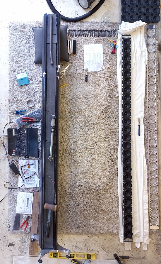

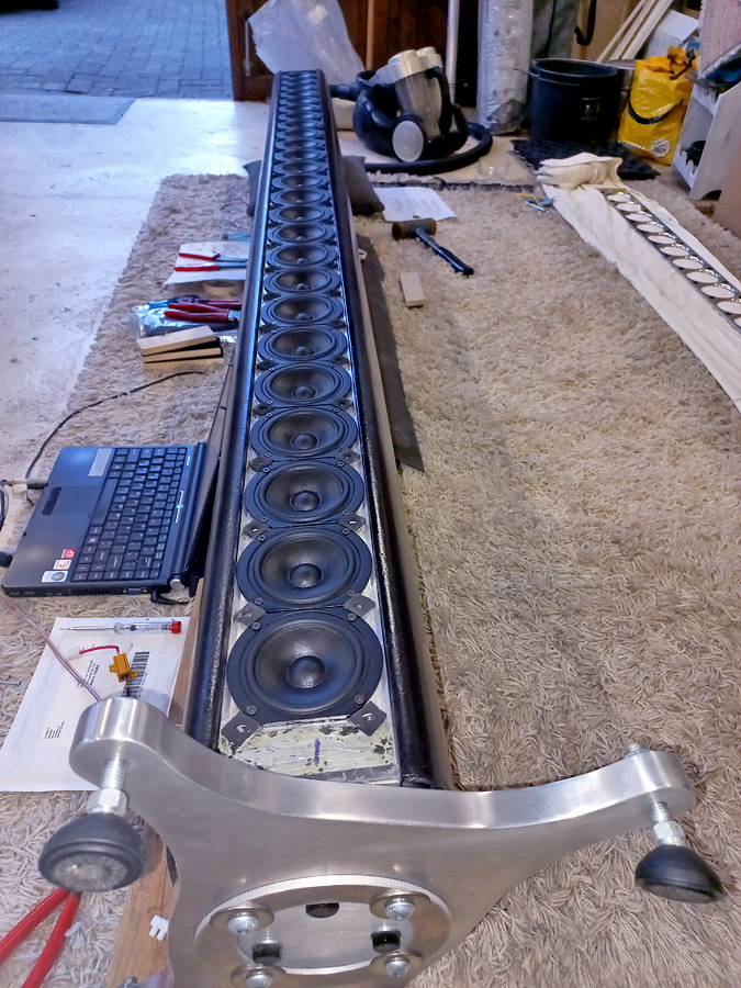

Countdown to sound has started. Cool!It will take a while though, to mount them all but it has begun!
Still busy, getting closer...
Didn't bother to clean up for a series of high tech photographs...
As there may be some critters walking around, everything get's sealed in-between sessions 😉.

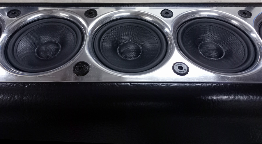

Closed up the first baffle today, second beauty baffle still needs some repairs on seals...

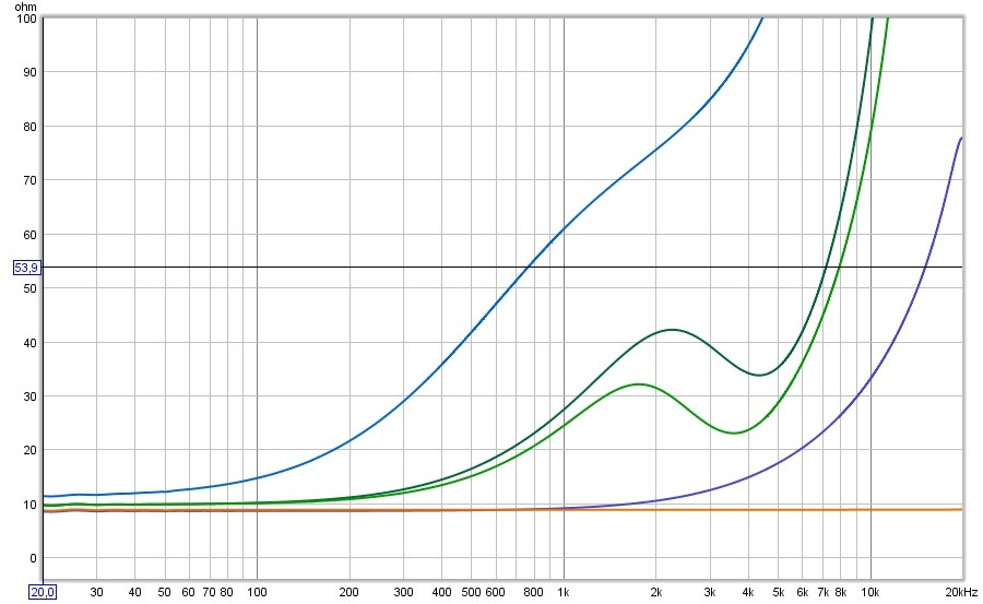

Ran some control measurements to check all filters...
All looking good so far, next step is to attach the drivers...
One check open, one check closed (but not yet bolted down)... that's where it ends today.
All in all, I'm happy to have gotten this far (Monday being my day off from work). Soon I'll start to hear something that might resemble music!

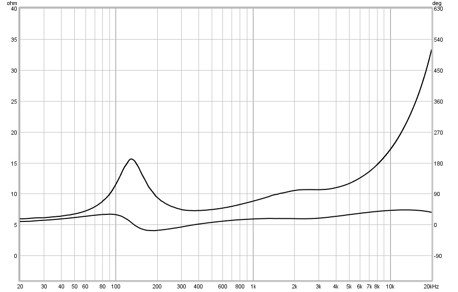

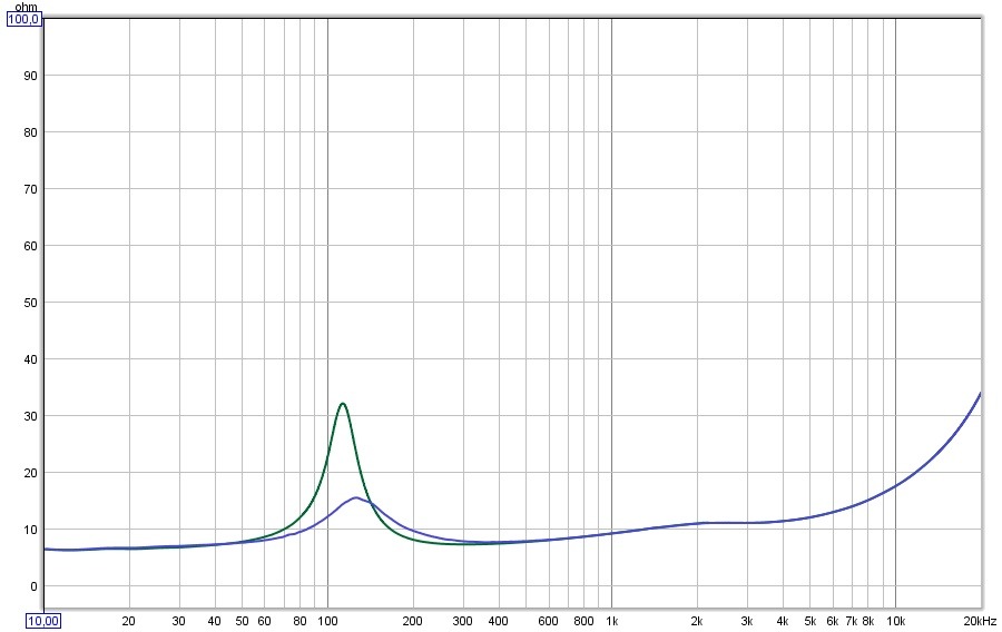

My guess is that it is working! Here's the right system impedance:
Exactly as planned, so I'm pleased with that. I'll rerun it after a few weeks, as this was still in the garage (18 degree Celsius) and with fresh
new drivers out of the box (aside from a few impedance runs). First dinner, after that the move back into the house. 😉
