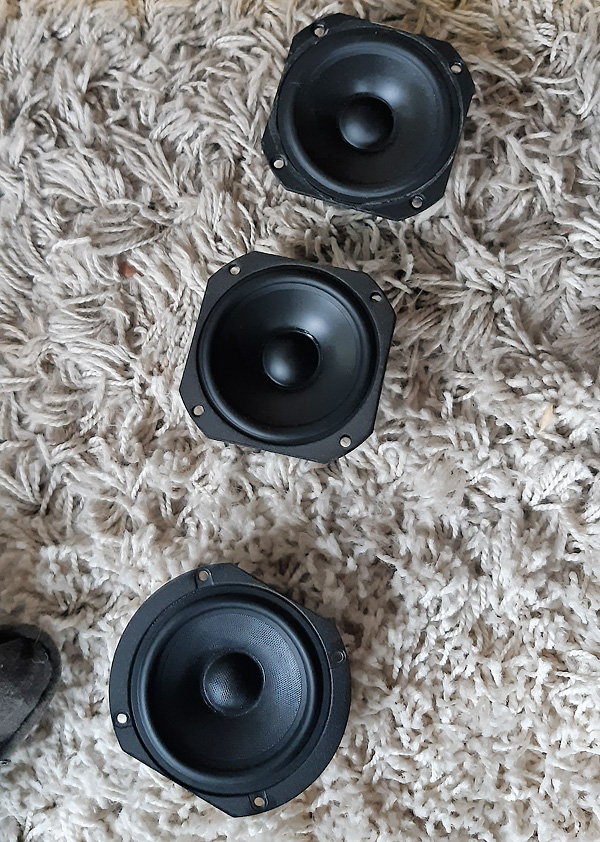

Let me run into the garage and test the TC9 vs 10F.
I'll pick an old TC9, a newly bought TC9 and a 10F for this test.
attachment.php
Reserve TC9 drivers and a couple of old ones that I exchanged
Here are the DUT's:
attachment.php

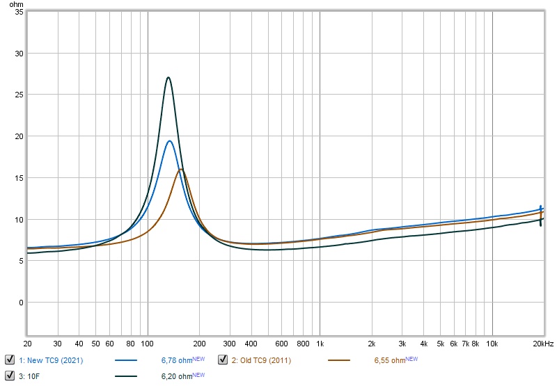

Their impedance:
attachment.php

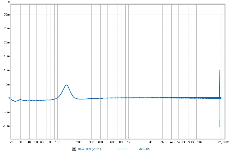

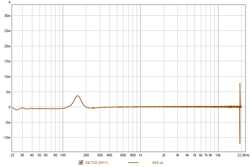

New TC9 group delay tab:
attachment.php
Old TC9 group delay tab:

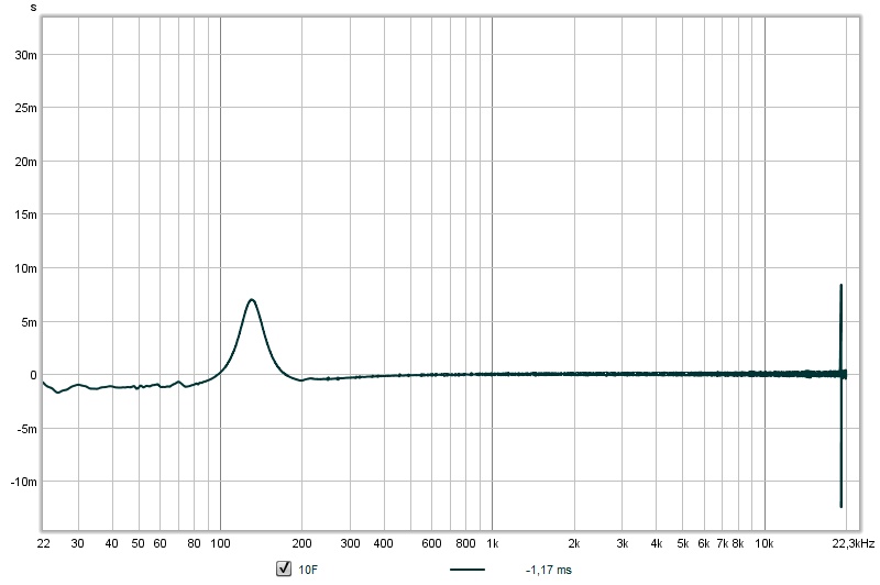

attachment.php
New 10F group delay tab:
attachment.php
What do you know... 🙂 they look very similar today when measured one after the other. 😱
So it's temperature related? I've seen big differences with the array measurements once the temperature goes below 20 degree C.

Don't really see the purpose of the group delay here?

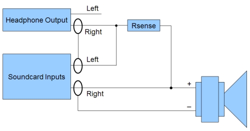

My impedance measurement setup is an old Vista laptop with REW on it and a rigged up cable like this:

Why do I look at group delay tabs during an impedance measurement? Because it's there.
I've looked at all tabs in every measurement from the start to see if I can learn something from it.
Does it make sense to look at it? Not that much, if there's no new information there 😉. It was the cause for me to use a conjugation network for my arrays. Be it right or wrong.

Don't remember what the rsense is, I think it was 100 ohm and tight tolerances.
What matters to me is that I can measure a resistor and get the right value. The same goes for caps and coils. It gets me close enough if the impedance of a driver matches the factory shape and value (on average). I measured the filters with caps and coils and compare that to simulated values. It works out very well, especially considering the tolerances of the components used. So that builds up trust that I can have confidence in this simple impedance jig. I've used it many times over the years. Temperature is a factor though.

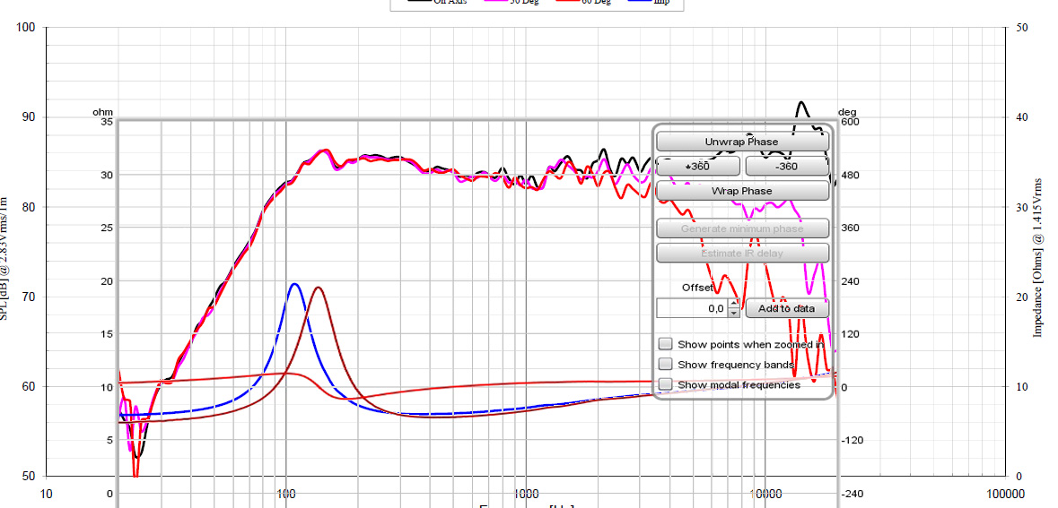

attachment.php
The impedance peak doesn't line up completely here, but I'm not that worried. As I can compare it between drivers and have a frame of reference. My garage temperature today was 18 degrees Celsius. I've seen it shift to either side with different temperatures. This driver also is new with no play time.

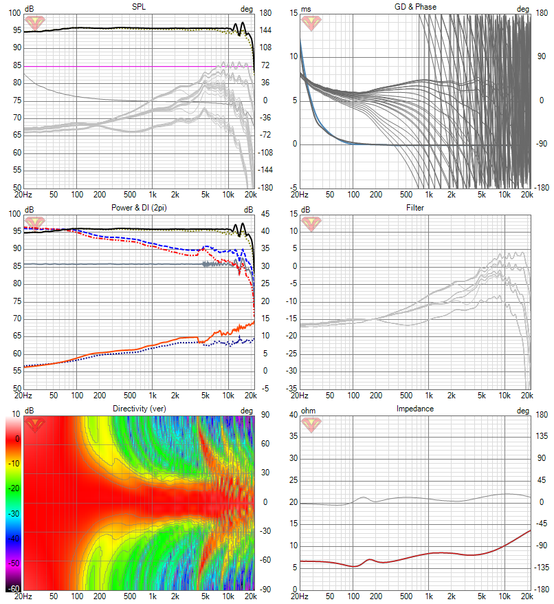

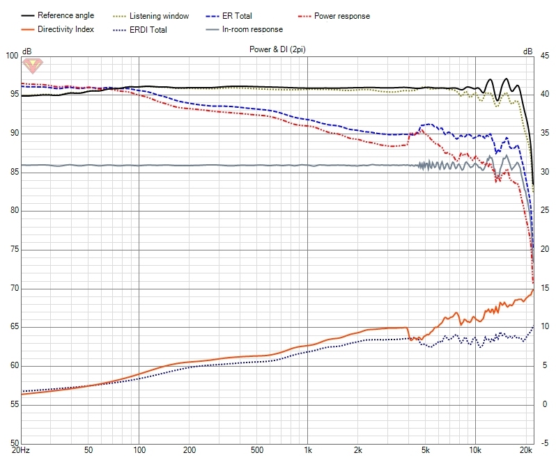

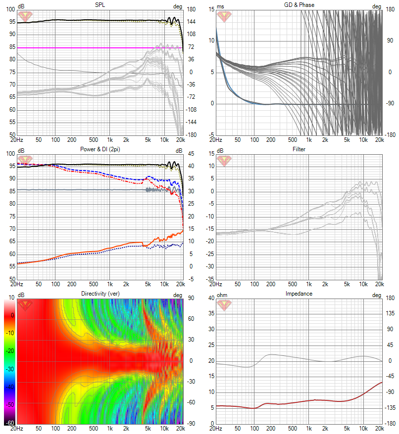

Slightly edited and updated filters for the 10F. Due to the slight differences in the impedance curves between
TC9 and 10F the filters reacted slightly different too. With the altered filters the top end is behaving a tiny bit better.
All it takes are 7x 10 nF capacitors to upgrade the filters for each array (3 filters need editing).
The 0.01uF Vishay MKP 1837 will do that job nicely.
There's still some differences but that's so minor I won't bother changing the components to alter that.
Here's the TC9 six-pack in comparison:
attachment.php
