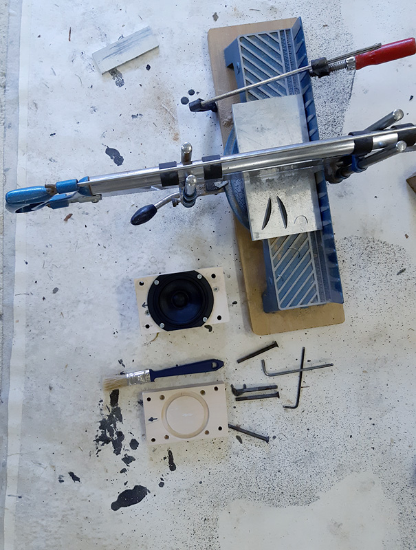

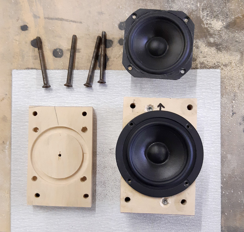

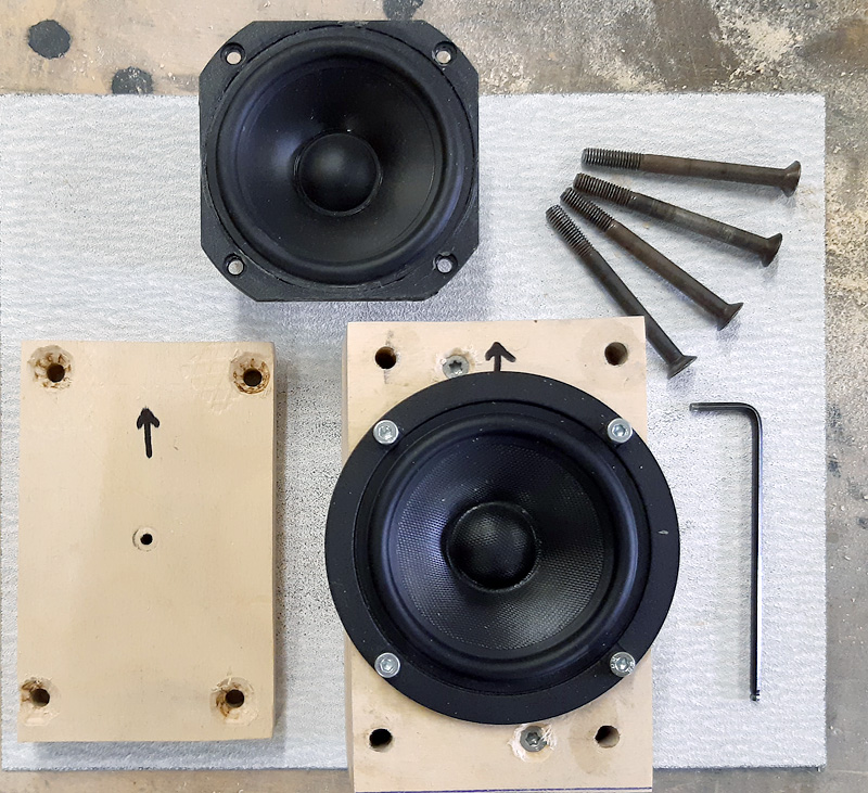

Made a template out of wood. I started with some pieces of aluminium but decided against it. Too dangerous for my current state of health 😉.
So wood it is.
attachment.php
Locking the driver in place:
attachment.php

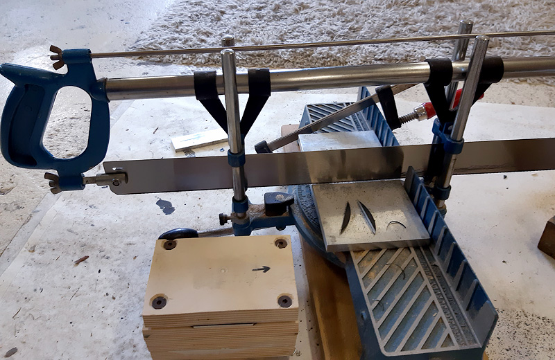

Using old fashioned hand tools:
attachment.php
A hand-down from my father, no idea how old it really is, I remember him using it when I was just a kid some 45 years ago...
Much to my surprise I still could get new blades for it so I bought one specifically for non ferro metals (alu, copper etc.).
attachment.php

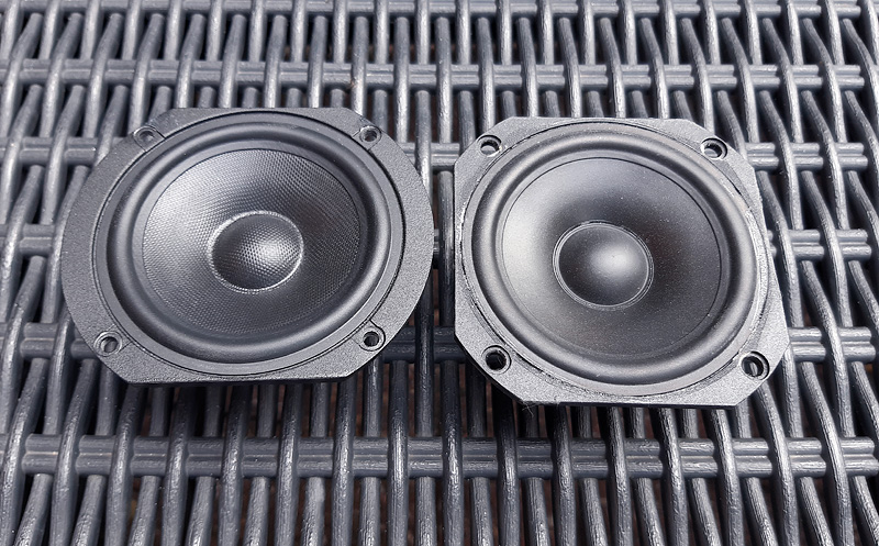

Not too much thinking, just doing 🙂. Not much heat or vibrations and easy enough to work.
attachment.php
That concludes this adventure. Very doable even with these old hand tools.
I just might opt to do all cutting this way. Save without any heat build up.
All it takes is some time...

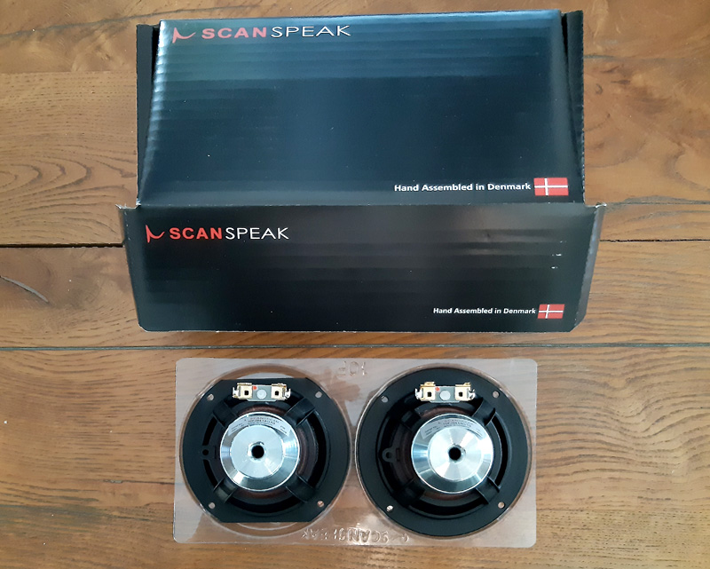

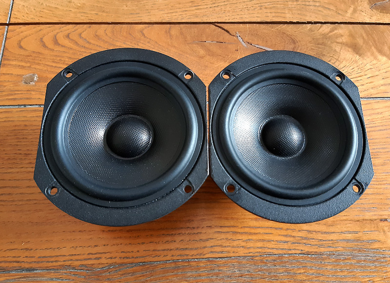

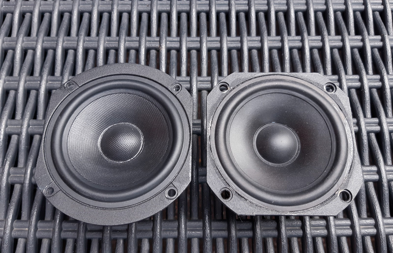

Small holes on the 10F, 3.8 mm against 4.3 mm on the TC9.
They share the same pitch though.
All in all there's a couple of small differences here and there. But it will fit like a glove.
That's a very nice precision cut wesayso, bravo!
The truncated driver looks great... now 49 more to go... 🙂
That might explain my thoughts of doing the cuts by hand...
More control that way and less added temperature or vibration while cutting.
The template makes it quite easy and repeatable 😀.
Due to drawing the model in 3D I was made aware of these tiny differences.
That made me even more careful to figure out how to center the driver properly on the template etc.
I took a little extra time thinking about it to make sure I can get repeatable results.
