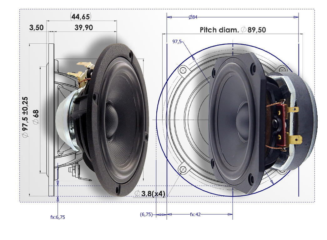

Call me crazy but the plan to go for the 10F series is growing by the minute.
I still have some questions pending though.
I spend today going over a lot of options, just to see if I missed anything. From everything I could find, the 10F is the one that impresses most with it's data. Second best probably is the no longer available TG9, suffering from the same construction as the third candidate the TC9.
Visaton B80 is a hair too big, lots of others are too small or can't really compete.
In every way I look at it, the 10F is an updated family member of the TC9/TG9 series. It shares basically all dimensions, while being equipped with an aluminium basket, glass fiber cone and a strong high Bl neodymium motor.
From all possible full range candidates I looked at, it had the strongest motor of all. Except for it's closed spider brother, the 8424G00. The one I use for ambient duty (thanks to @BYRTT )
I even began some preliminary preparation work:
I'm not doing this for bragging rights. I just don't like what happened with the TC9 drivers and don't expect to get a clear answer there.
Due to my recent health troubles I quit smoking, I can pay for this upgrade by what I save there alone... 😛 (well, almost)
As TNT put it so eloquently: YOLO!

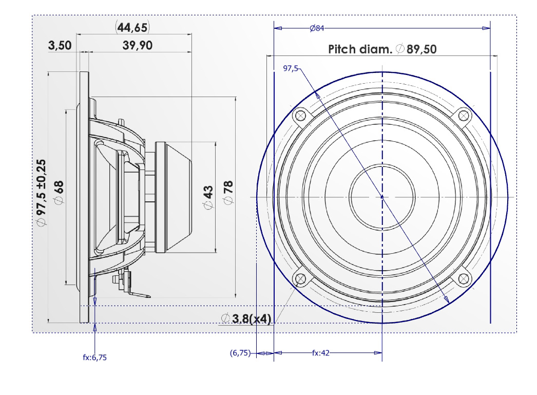

About the 10F 8414G10 I found this bit of information online:
However, upon asking a representative of Scan Speak I get the following information:
Voice coil wire: CCAW, 15% copper
Connectionwire: Cu
Voice coil former: Glass fiber
A bit less exotic I'd say. I seem to recall reading about the glass fiber voice coil former on another test report somewhere. I dislike finding conflicting information, hence my question directed to Scan Speak. It could very well be the slightly more expensive 10F 8424G00 has some differences there. It has a closed off area beneath the spider and is more of a mid range. The moving mass isn't the same between the two and there is the obvious difference in magnets and even in voice coil length.
About the voice coil in the 10F 8424G00:
So that's where that came from and why the 8424's price of admission is higher.
Voice Coil December 2013 said:For a 3.5” driver, the 10F/8414G10 has a fairly standard 19.4-mm diameter voice coil wound with round copper wire on a titanium former, terminated to a set of gold-plated solderable terminals.
Connectionwire: Cu

Lavoce; Bl of 5.3, that's impressive! But something doesn't add up....
A quoted x-max of 2.1 mm while the gap height is 4 mm and voice coil length 6.2 mm.
In comparison the numbers of the 10F:
A quoted x-max of 2.3 mm while the gap height is 4 mm and voice coil length 8.7 mm.
See how that works? The x-damage figure is quite small too on the Lavoce. 3.1 mm vs 7.5 mm. I do like a bit of wiggle room there!
That's a first to see a relatively normal sensitivity of a BMR. I'd wish it would be a little bigger...
The Wavecor is a bit too wild for my taste on the top end. If I'm really critical the Lavoce is too, one can fix certain things with DSP, but I'd love to see an IR first.
The 10F is without doubt the best measuring driver I have seen in this class. Second best has been the TG9 and third best the TC9. Sadly, that remains important to me.
