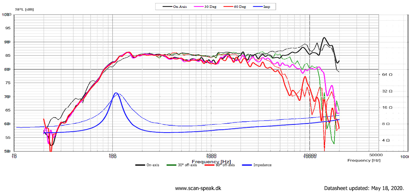

The advantages of a stronger motor (higher BL):
T-S Parameters in the 21st Century - YouTube
TC9, Motor Force Factor BL: 2.91
10F, Motor Force Factor BL: 4.27
(Re is the same in both cases)
Higher BL makes the frequency response rise up to higher frequencies. Which can be seen in the comparison I posted and agrees with the Youtube presentation example. Correction is needed with EQ. No problem, that's what I do anyway.

I thought the Youtube clip on BL was interesting....
Basically, every firm that makes full range drivers is balancing the parameters to get to a result. What I liked in the video is that B&C actually increase BL to get a better woofer, while stating: FR can be "repaired" with EQ. But the woofer's operation is more stable due to having the higher BL. Subwoofers even show a flat topped BL, as do the more expensive mid-bass woofers from ScanSpeak.
If you look at the samples provided in the video, then look at the TC9 and 10F curves, it is almost a text book sample of what is the difference there. Stronger (neodymium) motor on the 10F, copper voice coil wire on titanium former(*) instead of the lighter copper-clad alu on the TC9.

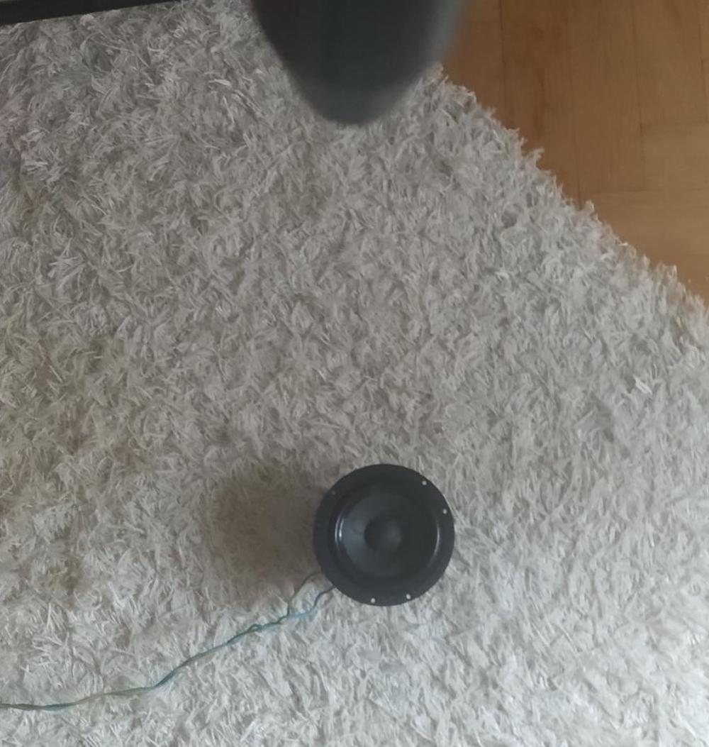

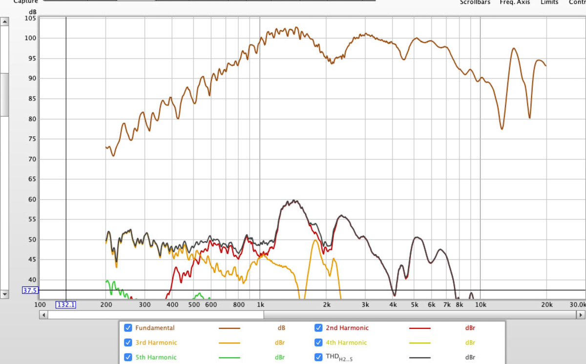

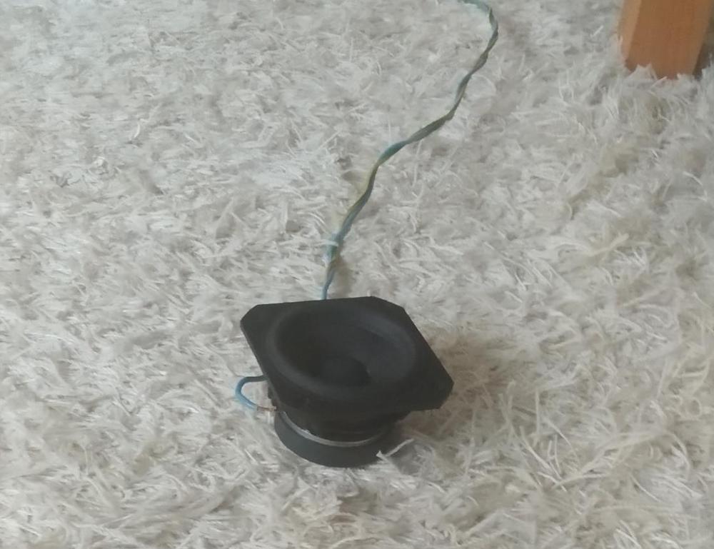

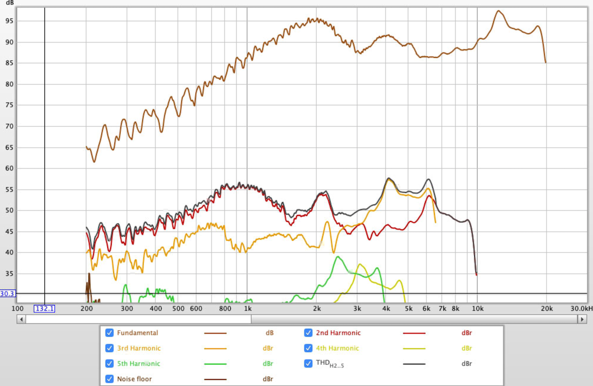

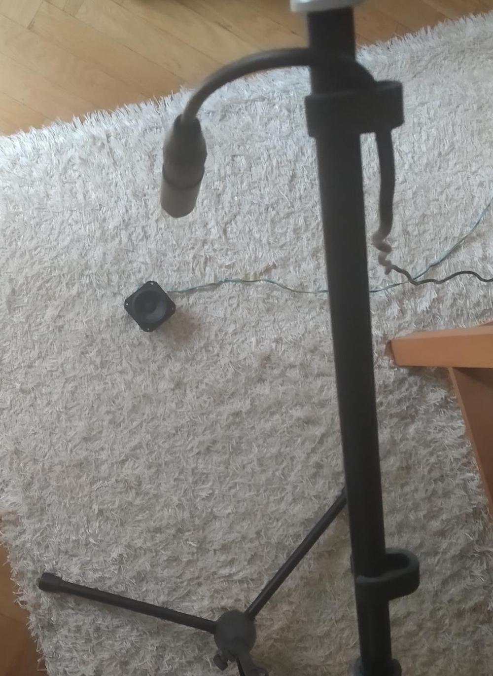

So I got 2 SB10 drivers. This is in no way a dead serious measuremt session but here goes...
I sat the drivers on its magnet on a soft carpet. Mic was 1 m above. I calibrated the levels to within +/- 1 dB so its SPL in the graphs.
I also got my SS 12MU out as well as the smaller SB65... I measured both the SB10s.
I did not move the mic, output level or mic gain between the drivers - just hooked in the new one and pushed Measure...
Traces are in order: SB10 #2, SS 12MU, SB 65, SB10 #1 (hoover over the pictures...)

Thanks for those, TNT. It isn't looking like a clean driver yet...

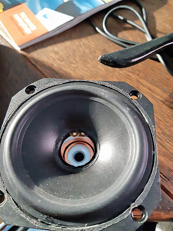

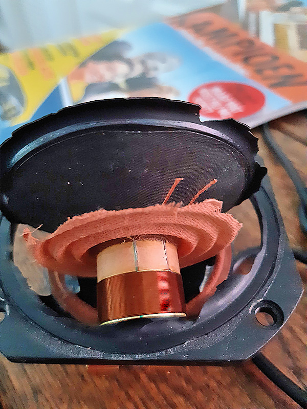

Sliced up another broken driver. I could scrape the wires of the voice coil clean and measure a 6.5 ohm resistance. The wire leads worked all the way up to their connection point beneath the glue. That leaves the unseen connection between lead wires and voice coil wires as the culprit. Unseen due to the blob of glue.
Sad, but it's another confirmation of what's going on here.
For Drengur a picture of where on the TC9 this takes place. You see both the lead wires sticking out, I could verify the connection tabs having zero resistance all the way up to those wires sticking out.
Next I hacked up the surround and spider to scratch the voice coil wires to see if something went wrong with the voice coil itself.
Here I could actually measure the voice coil resistance.
(yes, I hacked trough anything that was holding me back from measuring the coil. Not aiming at repair work, just making sure I've caught the source of the problem)
It confirms the use of copper clad aluminium voice coil wiring and aluminium former.

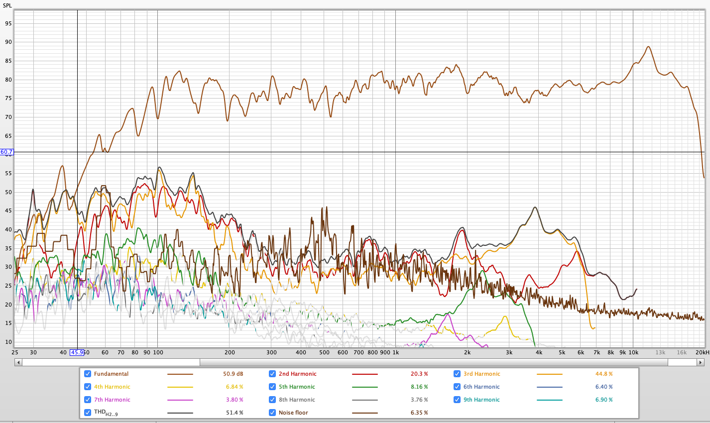

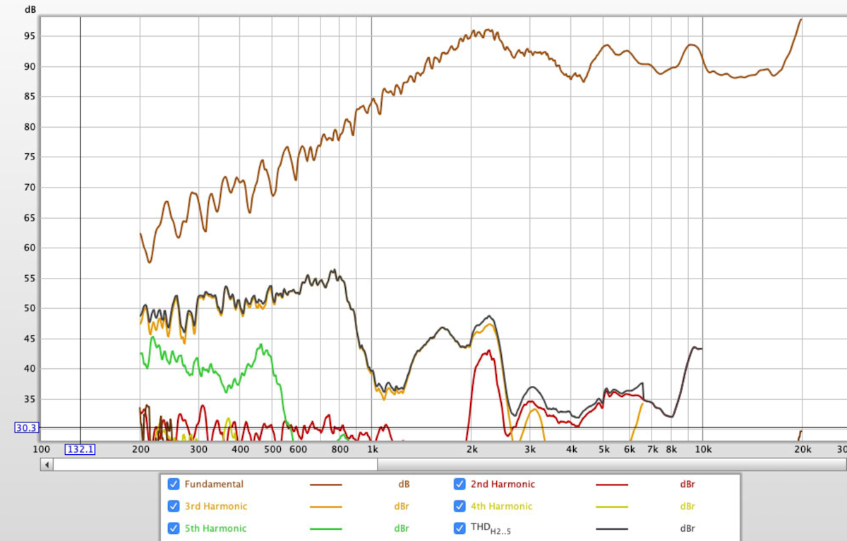

Yes - it seems like the SB10 has more distorsion in general than wanted. And indeed a raise of 3rd at 4k. A pity. Cant find my 10f/ ... a mystery ...
plucked out my SB10 as well, in a small 1.2 litre foam core little sealed box.
The 4kHz distortion is still there indeed.
Here it is, along the impulse.
I really had high expectations for this driver. I wanted it to be amazing.
