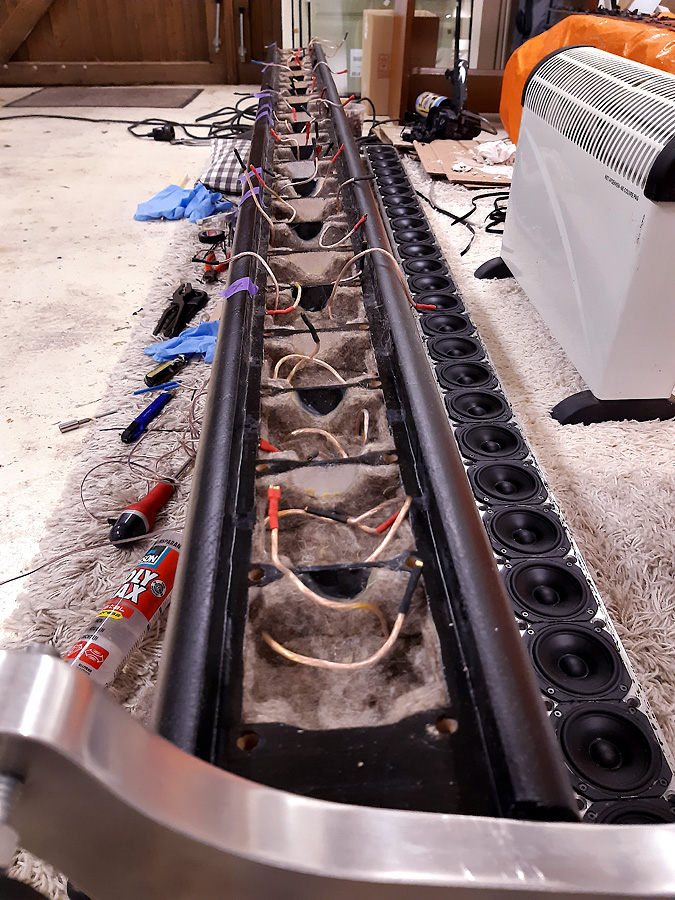

Work should begin on getting these boards inside the arrays this weekend.
865105d1596306665-towers-25-driver-range-line-array-boards-picture1-jpg
Quite chilly in the garage but I'll have to start at some point. Still loads to do before I'm finished but I'm getting excited again to start working on the hobby projects.
I turned on a small heater and the radio (essential ;)) and will start dismantling the baffle very soon. I hope the butyl rope I put between both baffles doesn't give me any headaches. I'm kind of nervous to start... :wrench:

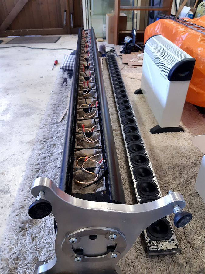

So it is going to be a challenge just removing the inner baffle. I first have to remove all butyl goop. It isn't too bad, just time consuming. It's the same stuff that is used to glue modern windows in cars.
The first outer baffle is off already, without harming the cones. That was the important part. I'll order some new butyl rope for re-assembly. It really does work wonders for damping the baffle. Way better than the neoprene that was in there before.
The baffle with drivers is lifted, this day is gone though... losing the temperature to be comfortable enough to continue. Tomorrow I'll disconnect the drivers and hopefully will be able to dive into the chambers to connect the filters. This is going to take me a while...

Just a picture to show the operation is really going to happen...

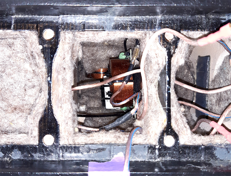

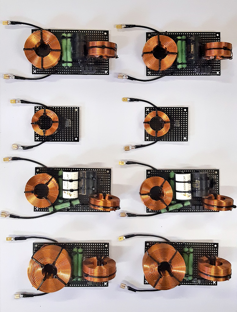

I'm moving along though, not as easy as I thought it would be. Working in tight cramped spaces with relatively low temperatures aint no fun! I could not use screws to fix the crossover modules. So I had to come up with another way of mounting them. Tie-wraps to the rescue. I'm about halfway through the first array modification, I got to stop early because of other obligations, that's the way it goes.
Changing the grouping on a fixed and ready array is not as easy as I thought it would be. I'll take my time and get it done. Just not as quick as I would want to.
Another day of work is done... All filters are in and before I accept I did it right I'll make some test cables to test each of the series connections in the array to see if they have no open circuits.
Here's one of the bigger filters in its place in the enclosure:

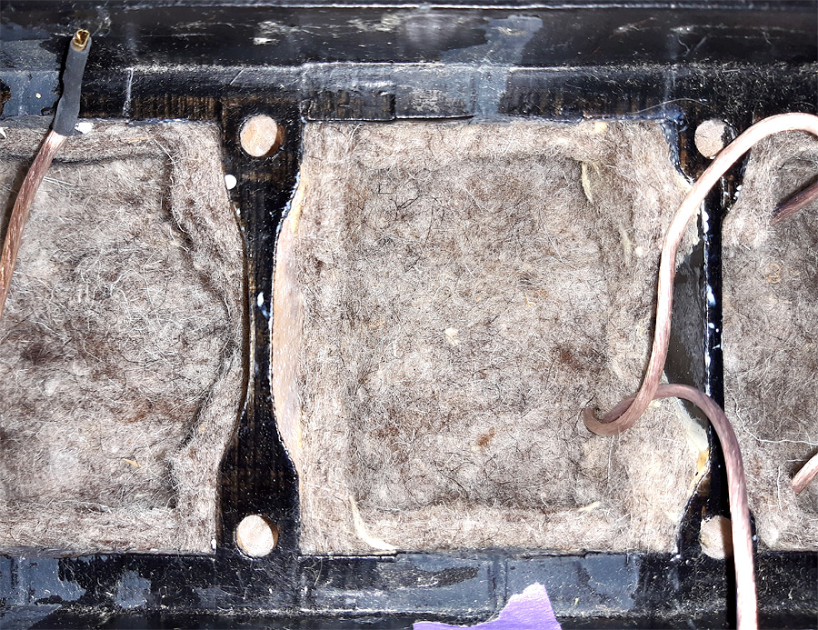

And after closing it back up with damping material and wool felt:
attachment.php
No more evidence I was ever in there again ;). The purple tape is to remind me which places needed an operation. :)

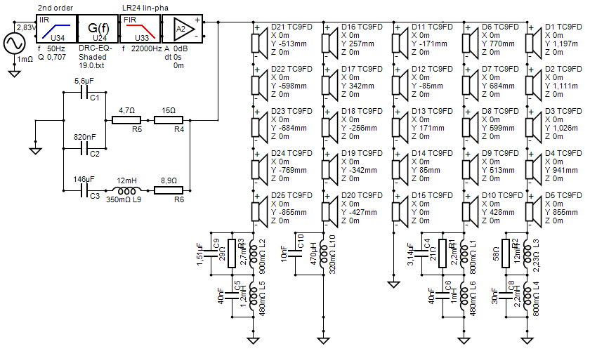

I did go back in in some of the chambers to re-seat the damping material as over time I found better ways to get it back in through the wiring and all the way down into the chambers. Hopefully the filters won't take up too much air space, I tried to get it as small as possible volume wise. They do sink into the chamber quite a bit and the chambers all have breathing holes to nearby chambers so I'm guessing I'll be alright there.
The biggest filter is mounted into the top chamber, which has a little extra spare space anyway. I've connected them exactly like I ran the sim, meaning they are all inserted in the negative wire:
