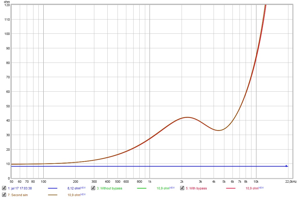

Question, do all these reports of a"audible improvement" show ZERO change in Z or FR or THD sweeps or CSD?

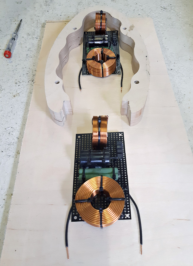

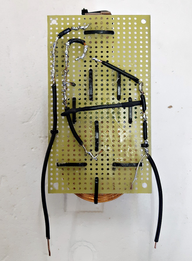

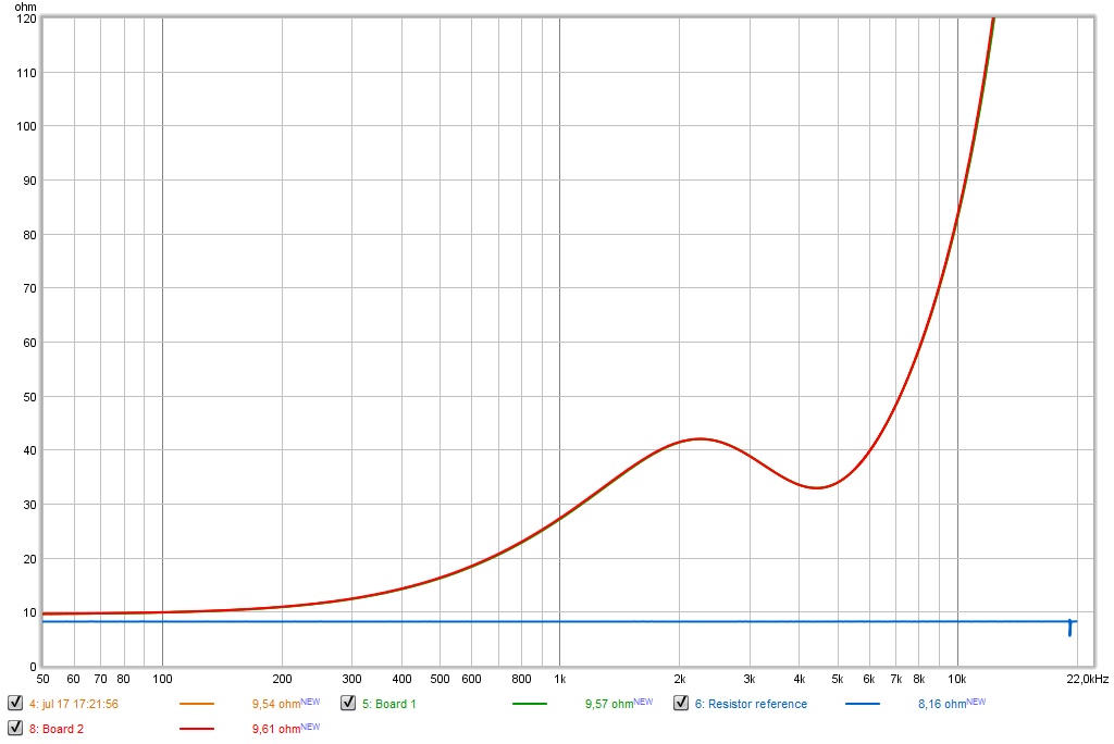

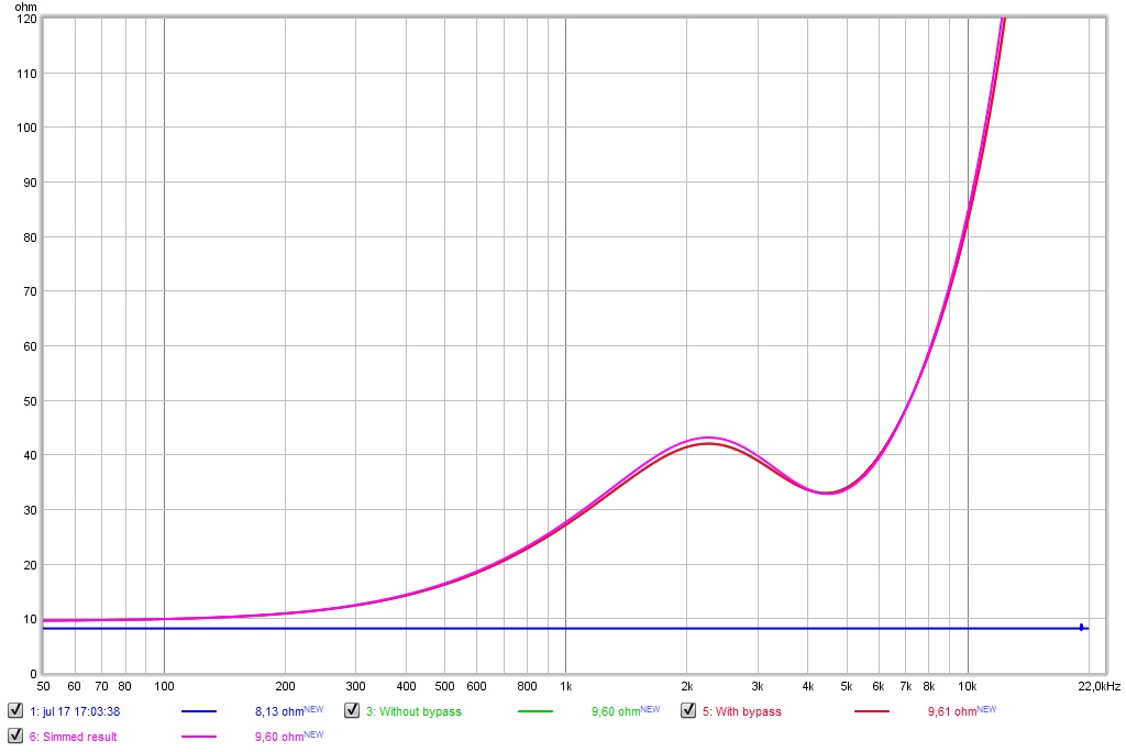

Okay, I have wired one board and measured it with an 8.2 Ohm resistor I had, after which I added the Vishay MKP1837 0.01uF and measured it again.
The board:

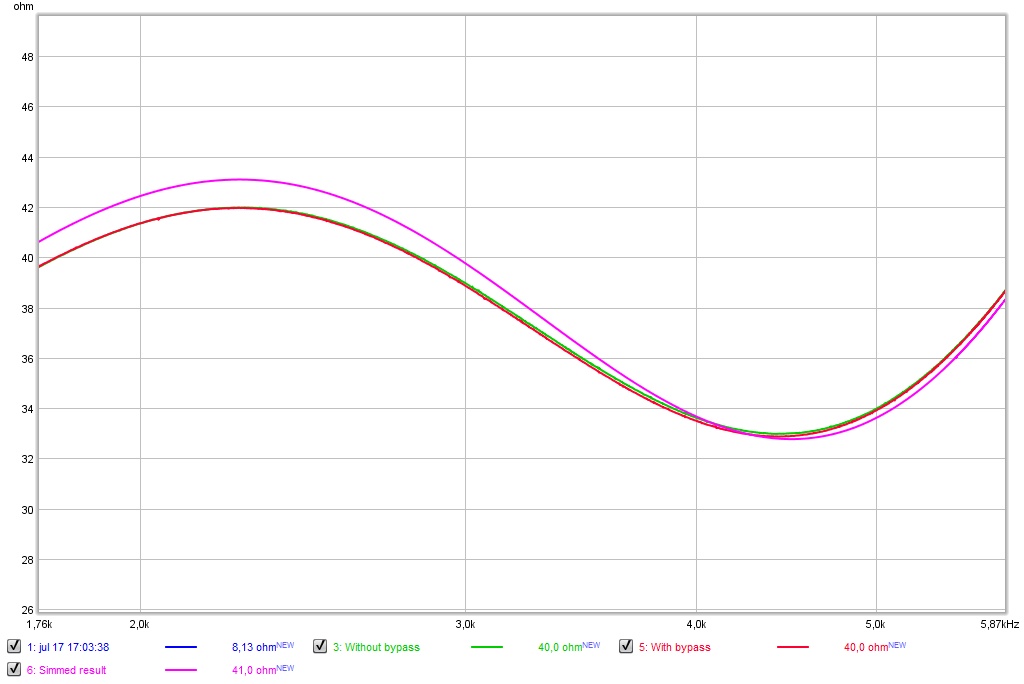

The results, together with an exported sim from X-Sim:
And a more detailed look at the part where the frequency is boosted a little by the cap(s):
As can be seen, the impedance measurement with the Vishay dips slightly lower. However there's another deviation from the sim that's larger than this slight difference, and that seems to be either the value of the bigger 2.7 mH coil or the resistor.
Simming it with a 29 ohm resistor (about 3% lower than it's 30 Ohm value) looks like this:
So, there's no definitive answer to the bypass cap's functionality, but it does seem all components are quite close within their tolerances.
I'll let the bypass cap stay, I see no immediate reason to choose otherwise. This board seems to be pretty much spot on target, considering component tolerances. If all other boards turn out equally close to their simulated values I'll be a happy man.
On to the next one I guess...
The board:

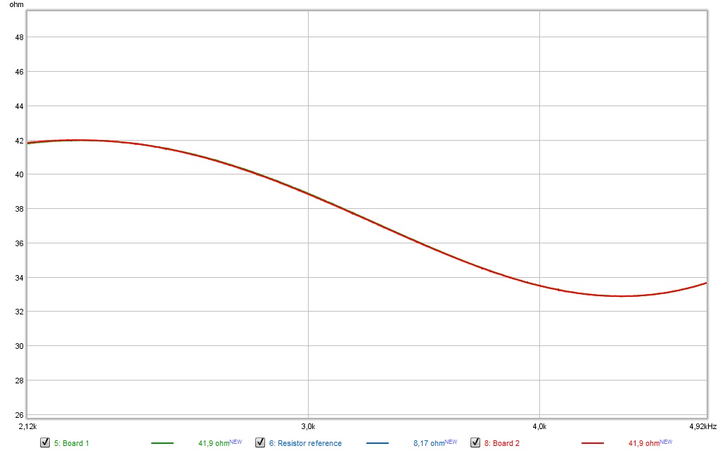

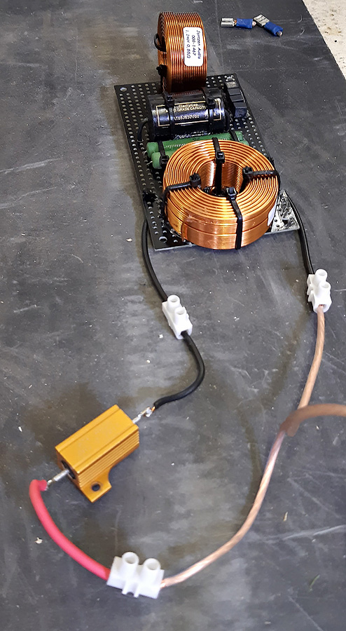

Next in line, board no. 2, the copy for the other side.
And a measurement of it,
So far I'm impressed with the results, spot on! They are essentially the same in an impedance measurement.
And I'm not kidding about that, here's both zoomed in pretty far:
Not bad eh? You can just about make out a faint green trace below the red one...

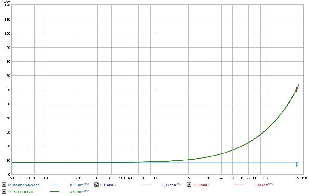

Board 3 and 4, the simple ones...
In a sim (X_Sim) a value of 0.470 mH is pretty much spot on, the caps both act as ~0.008 uF so again a small deviation, both boards are measuring the same though.

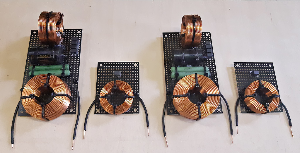

Production thus far:
I can make two more boards with what I have on hand. Sadly the store I ordered from is closed for another few weeks so I can't get my order fixed until the 29th. Here's to hoping the last four boards will turn out as close as these 4 are.
All in all I'm pretty happy so far. I have no real experience building crossovers so I took my queues from Troels and Tony Gee.
And the handy tip from fluid about cutting the boards. I used my Dremel with a cheap set of Diamond cutting disks (sourced from Amazon) and cut them by clamping the Dremel to my table and having a side bar from a few pieces of wood for guidance. The cutting disk went through it like butter. I have 20, still using the first one and all cutting is done already.

That's the idea, I want to mount them with Torx wood screws and rubber rings between the board and the enclosure, hence the test fit in the enclosure profile above.

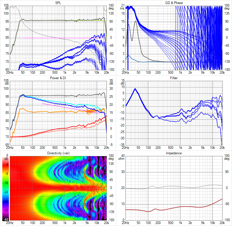

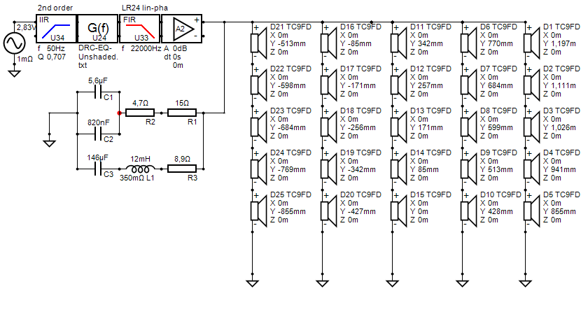

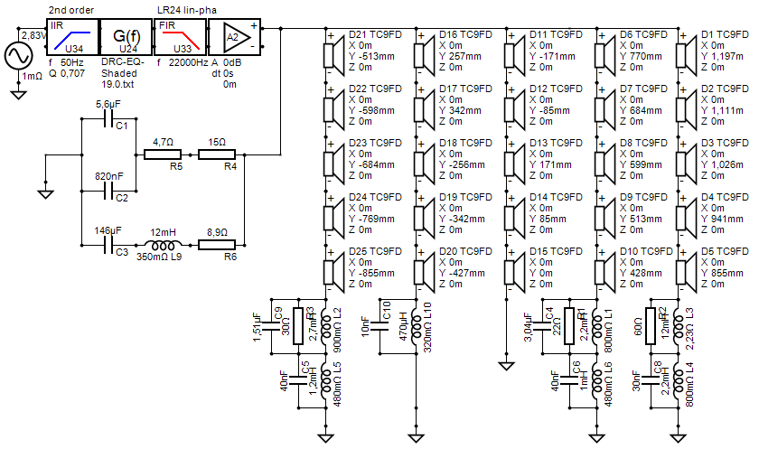

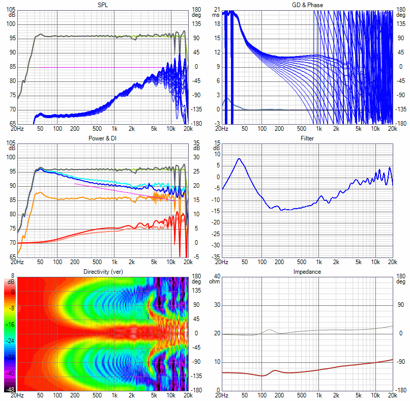

Up until now I've had the 25 drivers in each array run full range. Like in this schematic:
That leads to this prediction in simulation after DSP correction:
The boards I'm making should have an advantage over the above, by having slightly less deviation moving up and down in the sweet spot. The top end is more balanced and way less peaky outside of the corrected window.

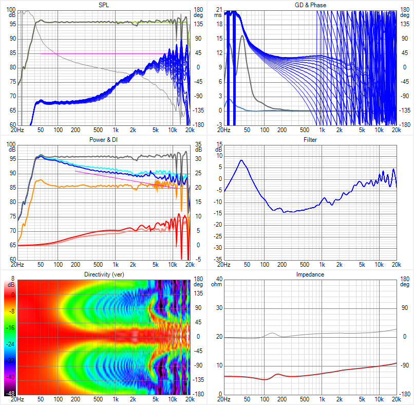

The schematic I am building:
And the prediction that follows (again after applying DSP):
If you look at the vertical window it should be clear that the frequency shading that is applied manages to focus the vertical window over the entire range of interest. This should create a wide enough sweet spot in all directions and keeps a reasonable (a bit more dark) performance standing up.
Look at the orange line in the left-middle graph as the predicted in-room result. That's what these boards are for, creating a slight advantage overall but an even more clear advantage at high frequencies. The red line is showing the Directivity Index.
This should make it easier for me to use a single point measurement for DSP correction while keeping a good performance around that single point. All in theory of course, we'll have to wait and see if it is an audible improvement. The correction file has less wiggles and this is my queue that overall this result should be worth the experiment.
There's still 5 drivers running full range, around those 5 drivers the top end is gradually shaded in each successive group. This keeps the dynamics of the array in tact while (hopefully) clearing up the top end and having an advantage for "in room" reflections from floor and ceiling vs the unshaded array.
