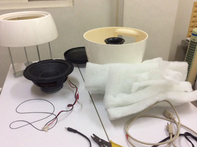

I just disassembled a Scandyna sub to fix it for a friend.
Quite the flimsy construction, especially when looking at your box and.... the number of screws!
This one is only thin plastic, the dampening material is very cheap and thin, and was placed very loosely around the sides.
No wonder that thing was booming like crazy

It sure looks flimsy! 8" long throw woofer? One would wonder what makes more noise with all that plastic, the driver or the enclosure... 😛

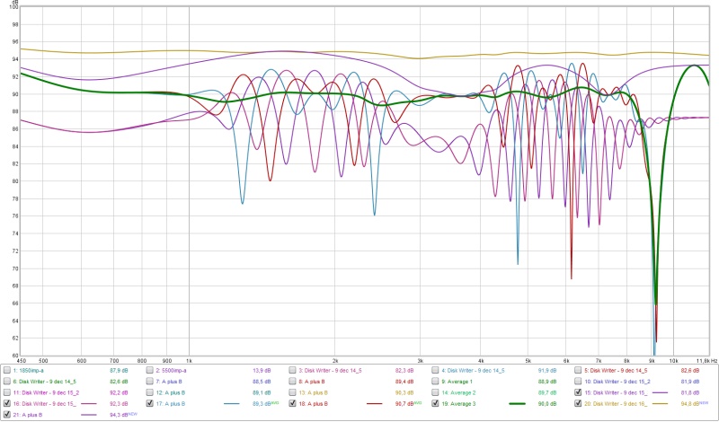

Exactly, the phantom problem exists for me with 5.1 sources too, except this time we do get a dedicated center channel to work with.
I've got to "fake" the tonal balance of the center channel as if it's coming from a front source.
It's a little easier to do than files originating from a real stereo source as it does not disrupt any side panned sounds (yellow line in the upper graph).
The phantom center balance at the ears looks like this:
attachment.php
(green average in the above post)

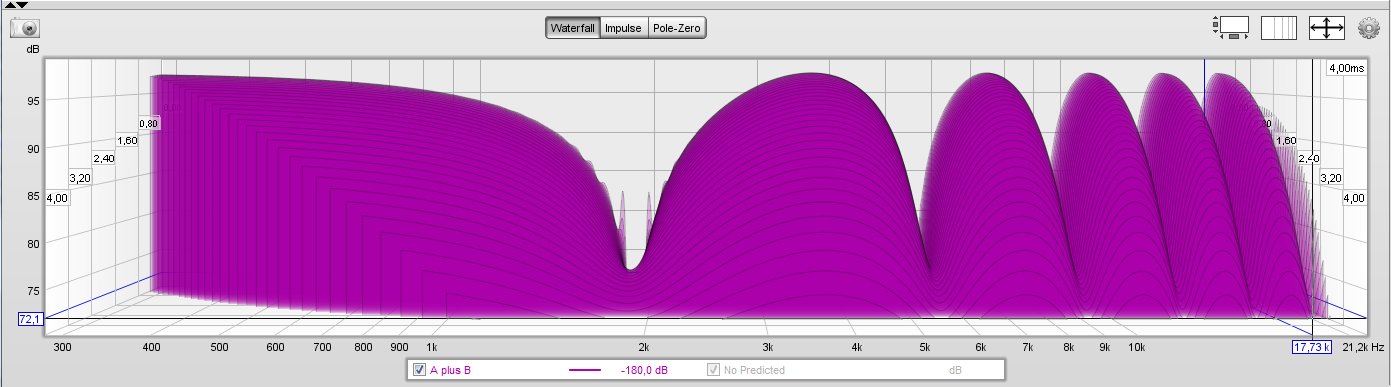

As opposed to the usual cross-talk dips which present themselves at both ears:
attachment.php

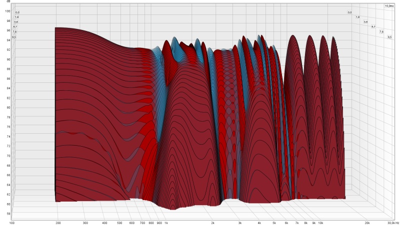

Yes BYRTT, it looks like a big mess, but think of it, any signal from a speaker out in a room that hits your ears wil look quite similar if you have some kind of early diffraction or reflection upsetting the balance. You can't see it if the measurement is smoothed, but just look past a known room reflection in a waterfall plot. 🙂
The plot I show here is taken at 3.5 ms after the main pulse:
attachment.php
Within my room, the first larger reflections happen after 6.5 ms, before that it still is a clean clear ridge. I've basically added virtual reflections to the phantom signal to disrupt it and fill in the dips. Mid/Side EQ is still used to balance things out even further.

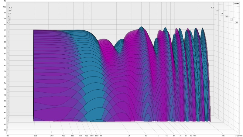

The biggest difference with this compared to the original shuffler (not the later phase shuffler that followed) is timing. This is what that one looks like when we compare them in a similar way:
attachment.php
The later we time the "correction", the closer the dips and peaks become. Honestly, I do have no idea what the ideal timing would be yet.
But when we fill in those dips for phantom center material, it starts to sound more right, tonally. The reason for me to time it later than the previous shuffler from Pano is
that left and right balance becomes more equal in the proces. We don't seem to be al that sensitive to a closely timed comb pattern.
