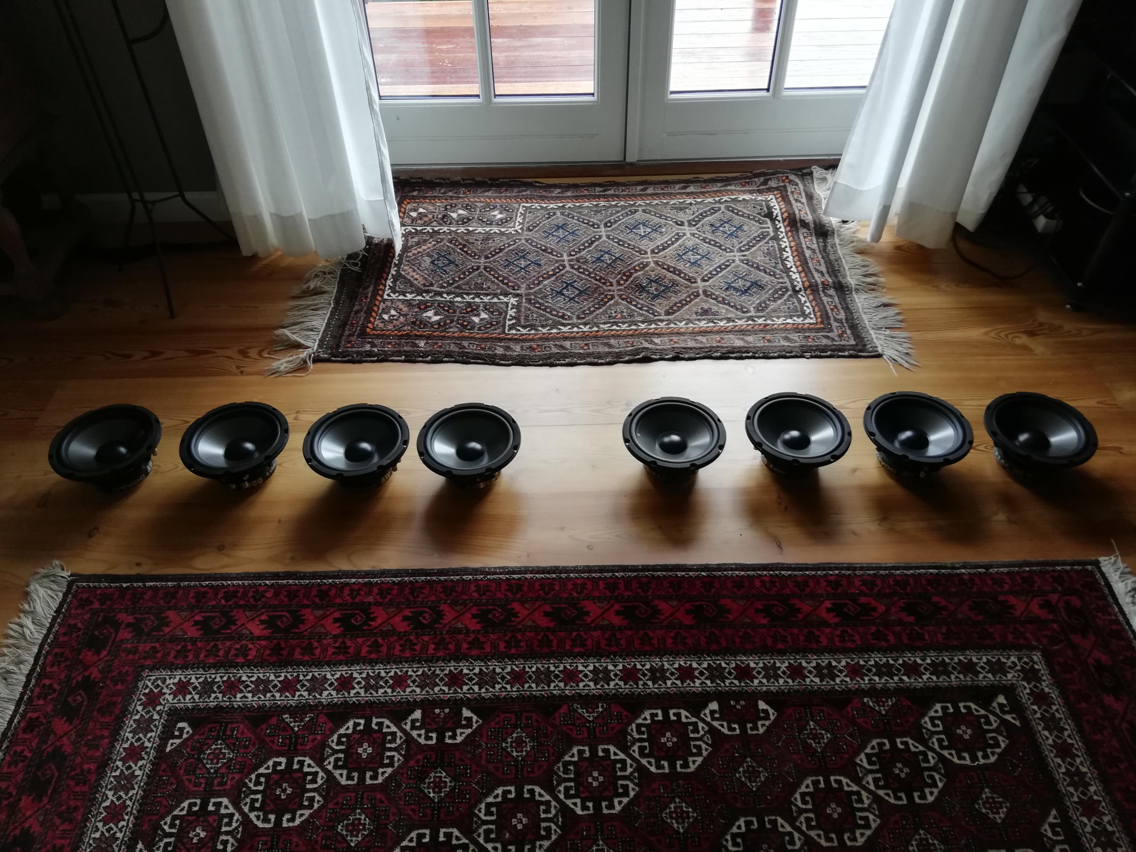

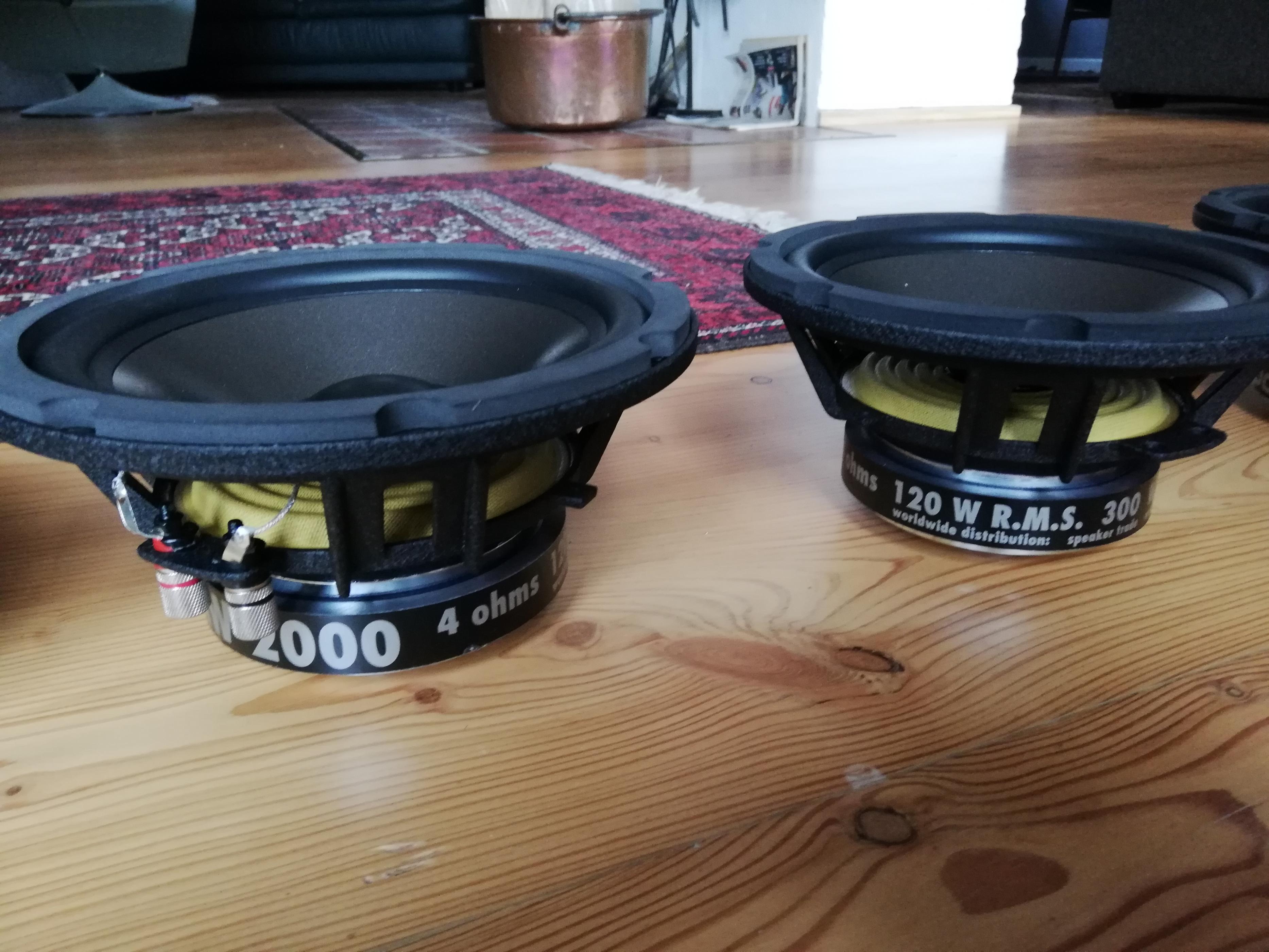

The drivers has arrived to my sub-woofer system for my Line Arrays.
It will be two enclosures , almost floor to ceiling (213 cm high) placed in the corners left of left main array and right of right arrays.
WINisd predicts 101 dB max SPL @ 20 Hz for one subarray in 2 pi space (half space) so placed in the corners it will be almost in ½ pi space, gaining, I guess, 5 dB and, as there are two of them, another 3 dB.
The result is 109 dB @ 20 Hz and 96 dB @ 10 Hz...😀
It will probably be even higher as the room gain also will affect the result.

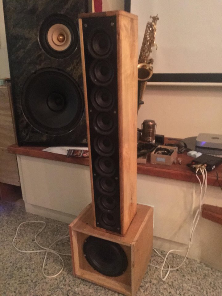

Had a friend who asked me to build him a pair of speakers for his restaurant terrasse.
He wants good sound for rock songs, and maybe even have a small band once a while.
I was thinking about horns, TLs, and other stuff... then it dawn on me. Line arrays with subs. It's good to hang around here sometimes! 🙂 With this thread incorporating LA with subs now, I thought it would be the perfect match.
He doesn't need floor to ceiling arrays, probably something like the Bose L1. So, I took out my old test array box of 9 drivers, and mated it with a small sub. Very good first test!

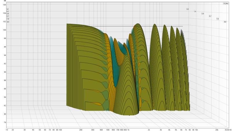

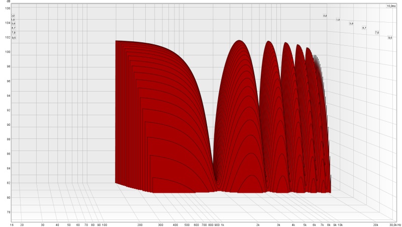

I'll show two waterfall plots to illustrate the difference between regular stereo cross talk (using 2 Dirac pulses) and my proposed tweak:
Regular Stereo cross talk (in worst case scenario)
My proposed tweak, code named "swopper" for now 🙂
As can be seen, I only targeted the biggest dip and plan to use it together with the mid/side EQ. I don't want to jeopardise the soundquality in non sweet spot seats.
The beauty of this tweak is that it sums at the exact mic position as if there's nothing done at all (a positive reflection in one channel, inverted reflection in the other side). I hope to use this advantage in the sides as well, as a phantom center also contains some side material. If all works well, the sides will be completely unaffected by this (that's the goal at least).
