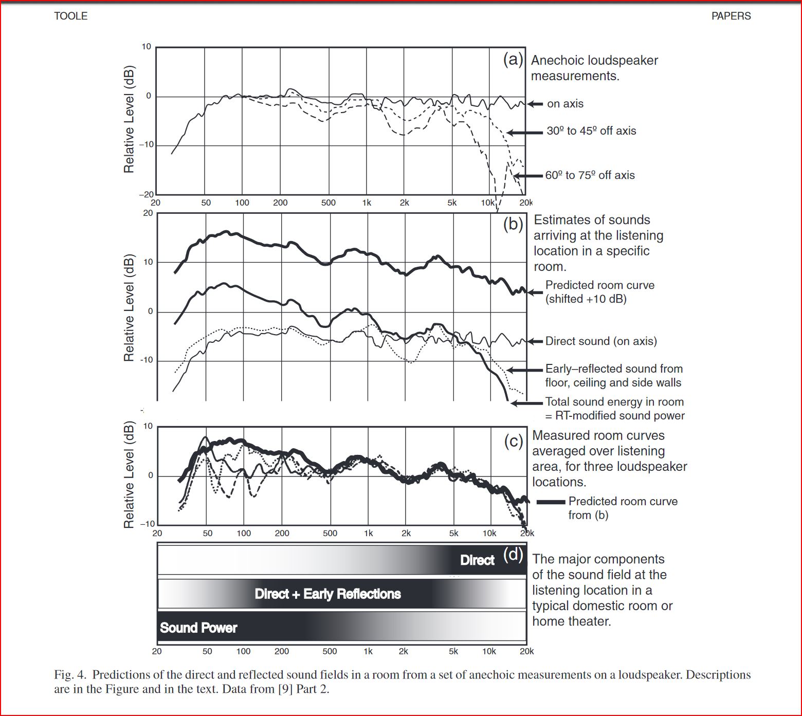

I hope your staying cool despite your summer heat wave. Thanks for sharing your experiences with equalising e.g. #3924 and #3677 .
I found the Toole article had a graph that seems to show most speakers achieve the desired curve thanks to room reinforcement. I guess your Line Arrays wouldn't have the same bass reinforcement as a normal box that has floor bounce; making equalisation even more important?
Floor bounce is usually destructive interference and tends to occur in the 150 to 300Hz region because of the distance between the driver the floor and the listener. Having speakers go almost to the floor helps to reduce floor bounce by filling in the gaps so to speak.
Bass reinforcement happens due to the room dimensions and placement of the speakers relative to the boundaries in a general sense. You get the same room gain with a line array as you would with a conventional speaker but you significantly reduce the floor and ceiling reflections.
