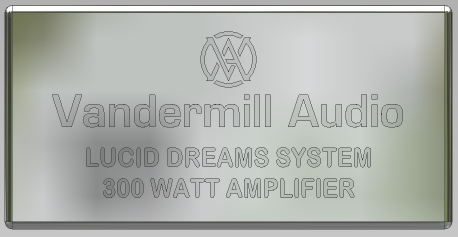

It's all about the spacing for me. I've made many small tweaks before being happy with this tag. Must have tried 30 different fonts etc.
At least 10 of those were unfit to use for printing.
Ah well, it's all very personal I assume. I'm pretty happy with how the amp turned out...
Even the size of the logo compared to the space above and around it matters to me.
This is just my personal taste, for me it is in balance this way.

Ok, so why not keep that amplifier tag design, and place that instead of the printed logo at the base of the speakers?
I'm just thinking out loud.. offering maybe just another option.

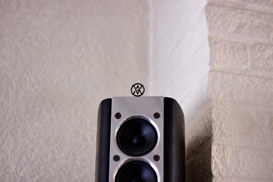

Nice logo!
Simple, clean, and distinctly yours. Also, makes sense with the two letters V and A.
You probably meant this, but also has look of a spiral helix or coil or resistor. Also resemble a symbol for some sort of vacuum tube part.

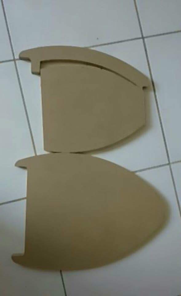

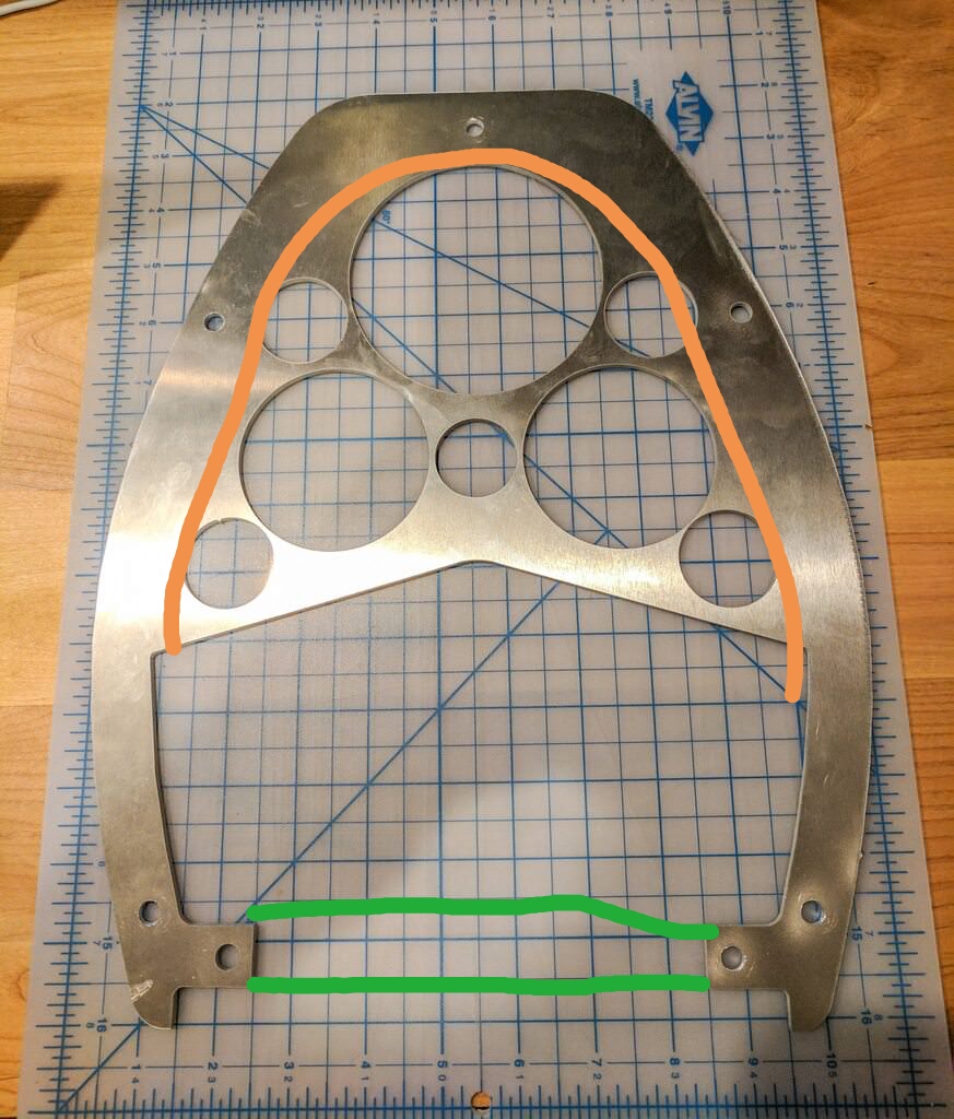

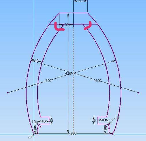

I already have a mission to build this stacked plywood cabinet for Elsinore, I have ordered 5mm alum as my template copying someone else idea. I wont use steel ll rod, but i thinking about using dowels on each layer.
as attached picture, the template I order will remove the orange line and add green one. then I will add separate baffle just like SF Amati Homage (i really olve it craftmanship), no vinyl cover just exposed plywood
will i avoid any crack with using dowels? anyone had tested the same?
I'd leave that green line open. That way you can get more shapes out of a single sheet of ply by inter-locking them. That's how I saved wood. There's plenty of room to attach the baffle to. No need for a closed front. Use a couple of layers as braces too.
The Elsinore? Cool project. I've been silently following that one for quite a while.

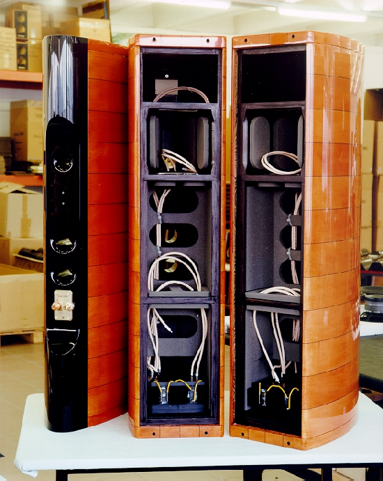

I hope the dowels will work out for you. I know of at least one other ply laminate construction that cracked:
http://www.diyaudio.com/forums/full-range/167744-fe168e-sigma-teardrop-enclosure-17.html#post4118349
That one did not have any steel rods at all. He went on to fix it with fiberglass, similar to my solution (epoxy and fiberglass matt for me).

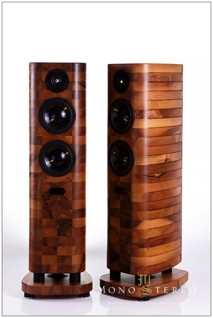

Love the look of that Sonus Faber enclosure though, should look good filled with the Elsinore gear.
You may be able to add a coat of fiberglass + matt and still keep the wood look. Look up how they coat boats that way. I had thought about doing that myself. The fiberglass matt will be completely clear and transparent. I'd think about adding a few flexible seams in there though. The force of expanding wood can be quite severe.

If You decide not to use these logos on the speakers, they could be made into some pretty hip earnings for your misses. Maybe too heavy, but good promotion for your business if You ever decide to go that route. 😉
Took them off yesterday. The arrays look prettier without them. I'll make a list of people that want these earrings, anyone want to sign up? 😀

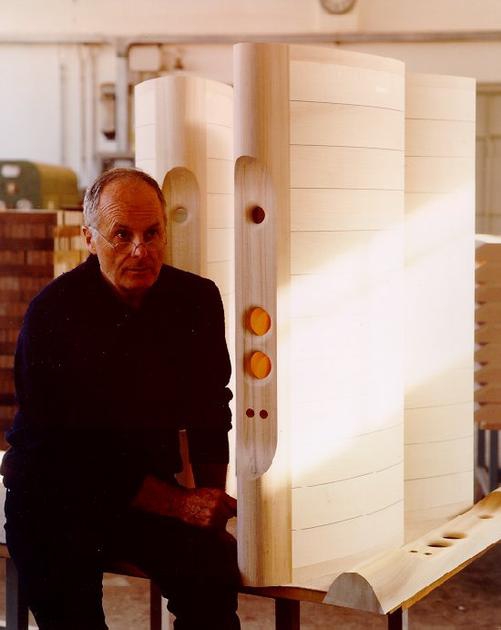

I'm worried about now whether to proceed or not on stacked ply, but it think it's worth to try considering that i will need around 2-3 sheets of ply. the cost is not too much, but assembling time which must be sacrified.
or maybe using solidwood 2"x4" like this is also doable
From the start I had planned to cover the stacks with fiberglass matt. Until I saw the base wood after sanding. I just had to try to keep that look but it didn't work out.
But my stack was 2 m 25 cm(!)
Eventually you'll have to decide for yourself, no one can give you any guarantees.
I just ordered the template from my friend who has cnc machine and usually received speaker cabinet order. but hey what is the fun if he is the one who build it
the template is from mdf then I'll go to metal shop to cut 6mm metal sheet based on this template. to avoid any crack, the side box thickness is set to 40mm. From all builds that I found on other threads, the template is usually jointed together between left and right side. But i separate them to reduce wasted plywood and also to copy SF amati homage design with solid wood on the backside.
the middle template is for the bracing, while the big one will be the base guide.
